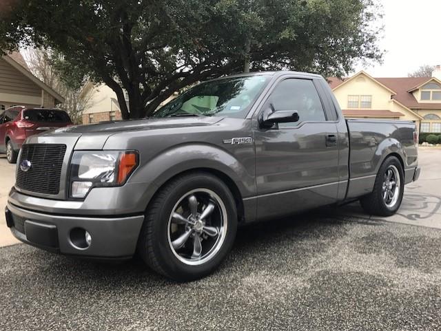

It's going to be hard to make a flip kit work for only a 2" drop. It'll require a taller rear shackle and a dropped or relocated front spring perch (in conjunction with the flip kit). Just doing a taller shackle will make for probably an unacceptable pinion angle. I think until someone fabricates a whole new leaf spring set up, the next best option would be as another poster suggested, to removed the over load spring and use air bags for support when needed. I did exactly this on my '13 f150 (along with a flip kit) to get the exact ride height I wanted. Here's a bonus pic of that:
This truck is Awesome!
