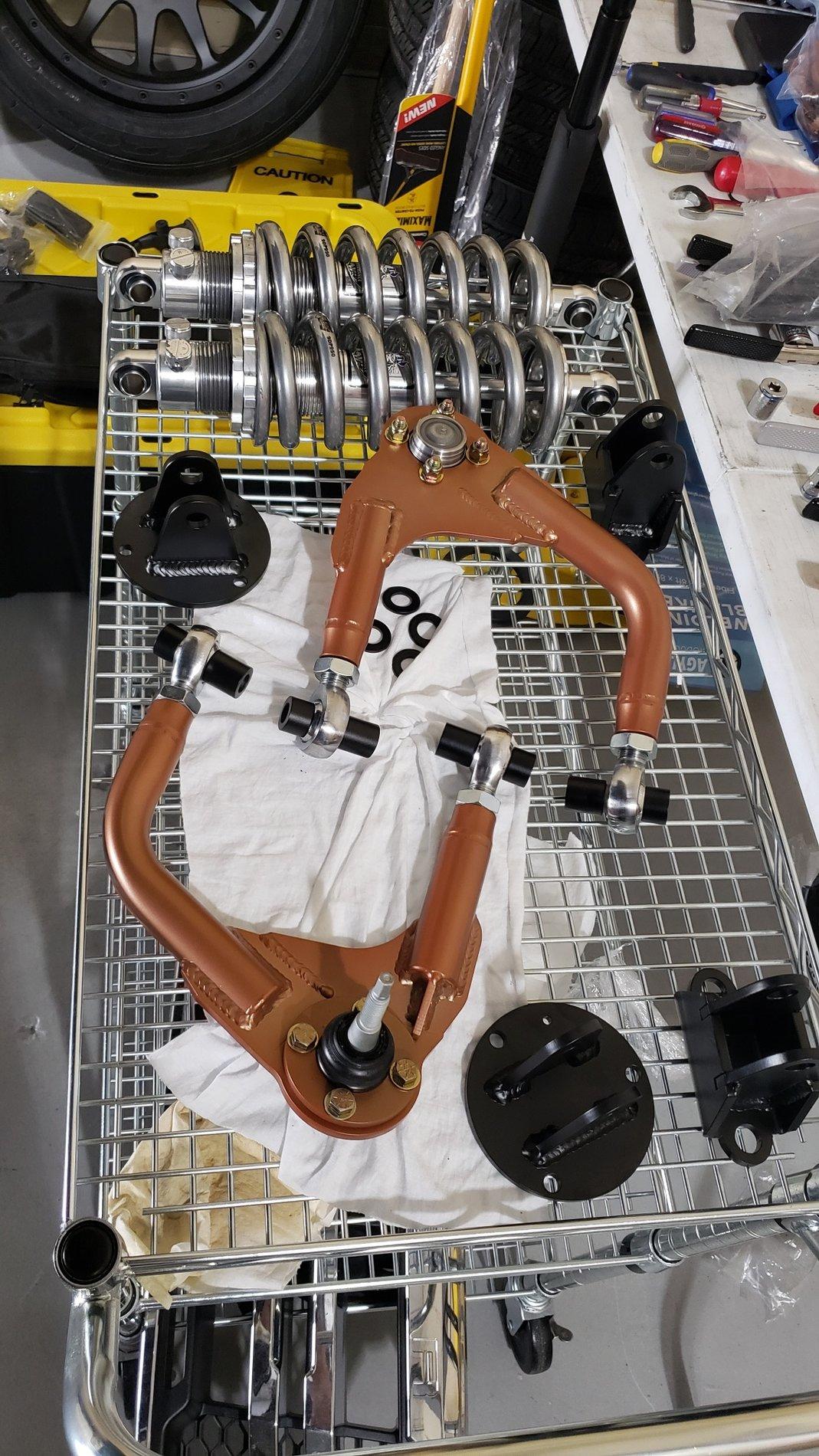

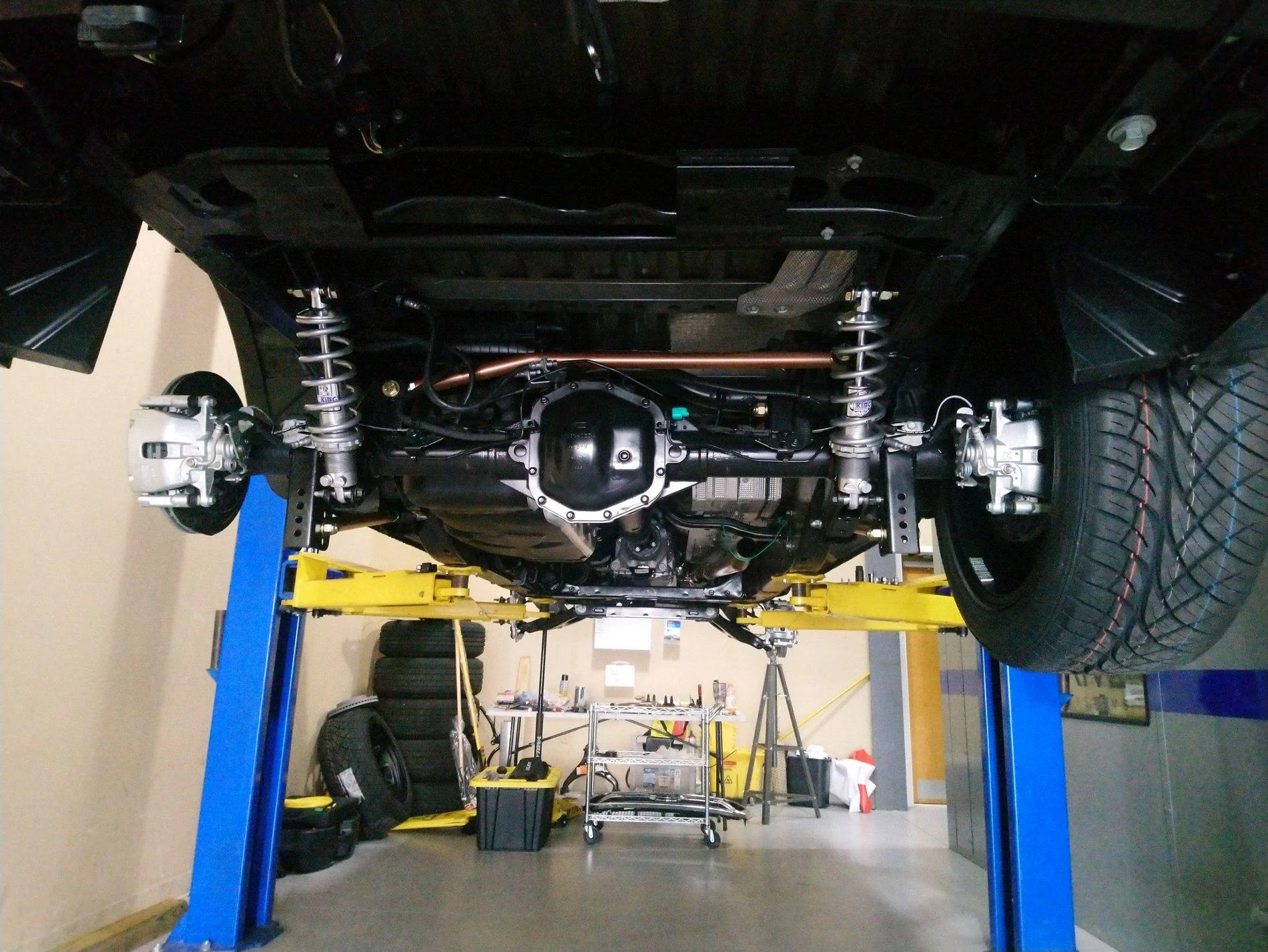

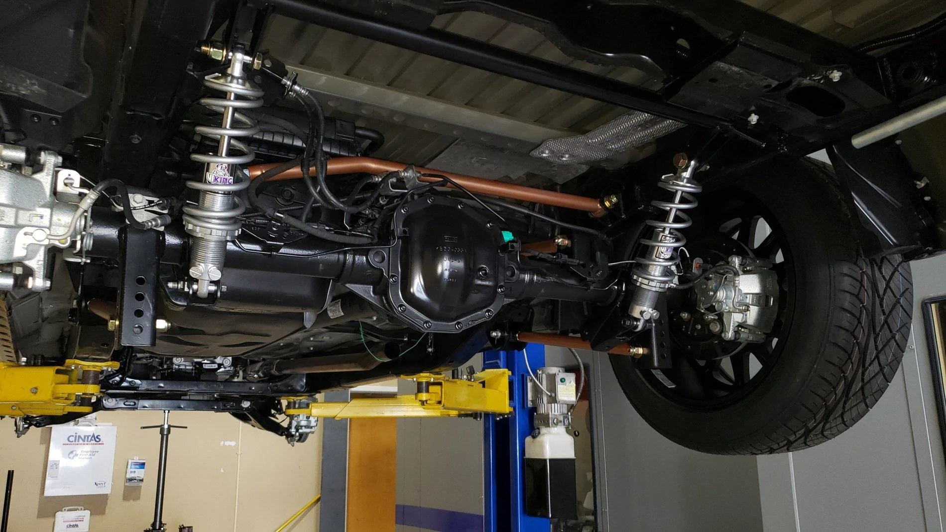

Hey everyone, first post here. Thought I would share our lowered Ranger. This was built in house at SCT/BullyDog for the SEMA show. We outsourced the suspension and worked with Control Freak in Debary Fl, well known for their AMC, Chrysler/Dodge and other suspension systems. They helped us build this one of a kind truck, and now have decided to go into full production for the 2019+ Ranger suspension system. Freakride.com
First, here are some pictures of our truck.
The truck also has AirDesign fender flares and body parts and a bunch of other parts. I may start my own thread, but I wanted to show off the suspension since it seems many have an interest in lowering their trucks. I have been driving the truck around, and it handles like a car. It truly is a track/street machine now.
