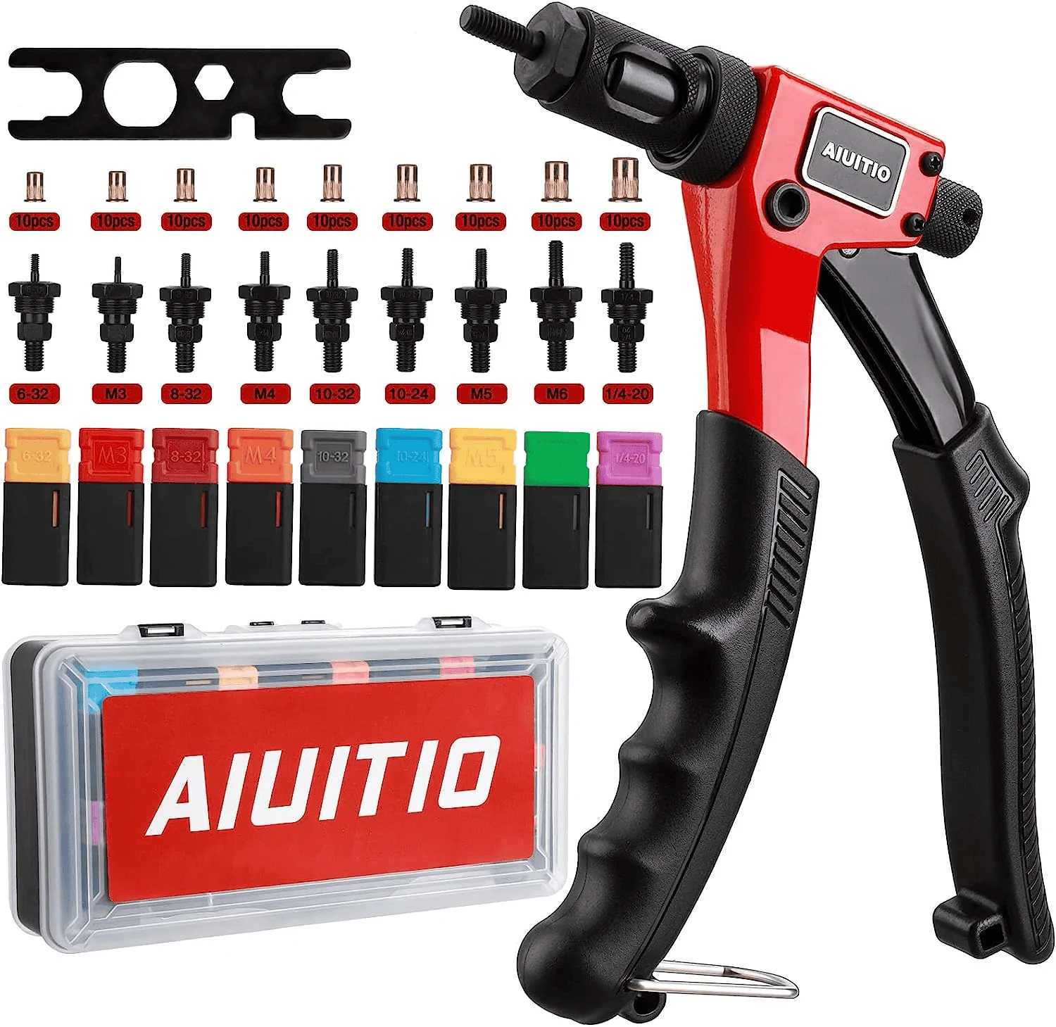

Wow, $100 at Amazon (and I'm still pretty clueless as what it does!). =D
Thanks for the video, gonna watch it now. =)
Update: Holy Cow! This is an awesome video! Thanks!!!
I see this manual one, is it the same kind of thing? Only $24:
https://www.amazon.com/dp/B09W216HZS/ref=sspa_dk_detail_4
I think they all do about the same thing….
Just depends on how much money and/or effort you want to throw at it! ?
4,558
23,178
I tell you what BButah, after seeing the awesome video you shared, the nut and bolt technique should work perfectly. =)
Thank you for that incredibly useful video. I'm going to do that to all three nut dealios.

Just did my first oil change since installing the rivnuts and thumb screws. It makes it Soooo much easier and quicker than having to deal with those POS plastic fasteners. Between them and the Valvomax drain valve the longest time was waiting for the oil to drain.
