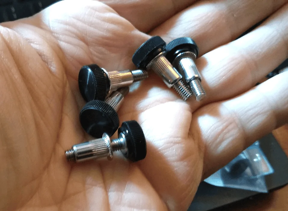

I replaced the plastic "rivets" with rivnuts and thumbscrews, which work really well - similar to what you show above - cost me about $20 and I still have several of the thumbscrews.

As I recall I had to slightly drill out the holes - I don't know what the size of the holes is - I used an M4 rivnut with these thumbscrews:
https://www.mcmaster.com/96016A561
These were the rivnuts but any M4 rivnut should do with those thumbscrews:
https://www.mcmaster.com/95105A167

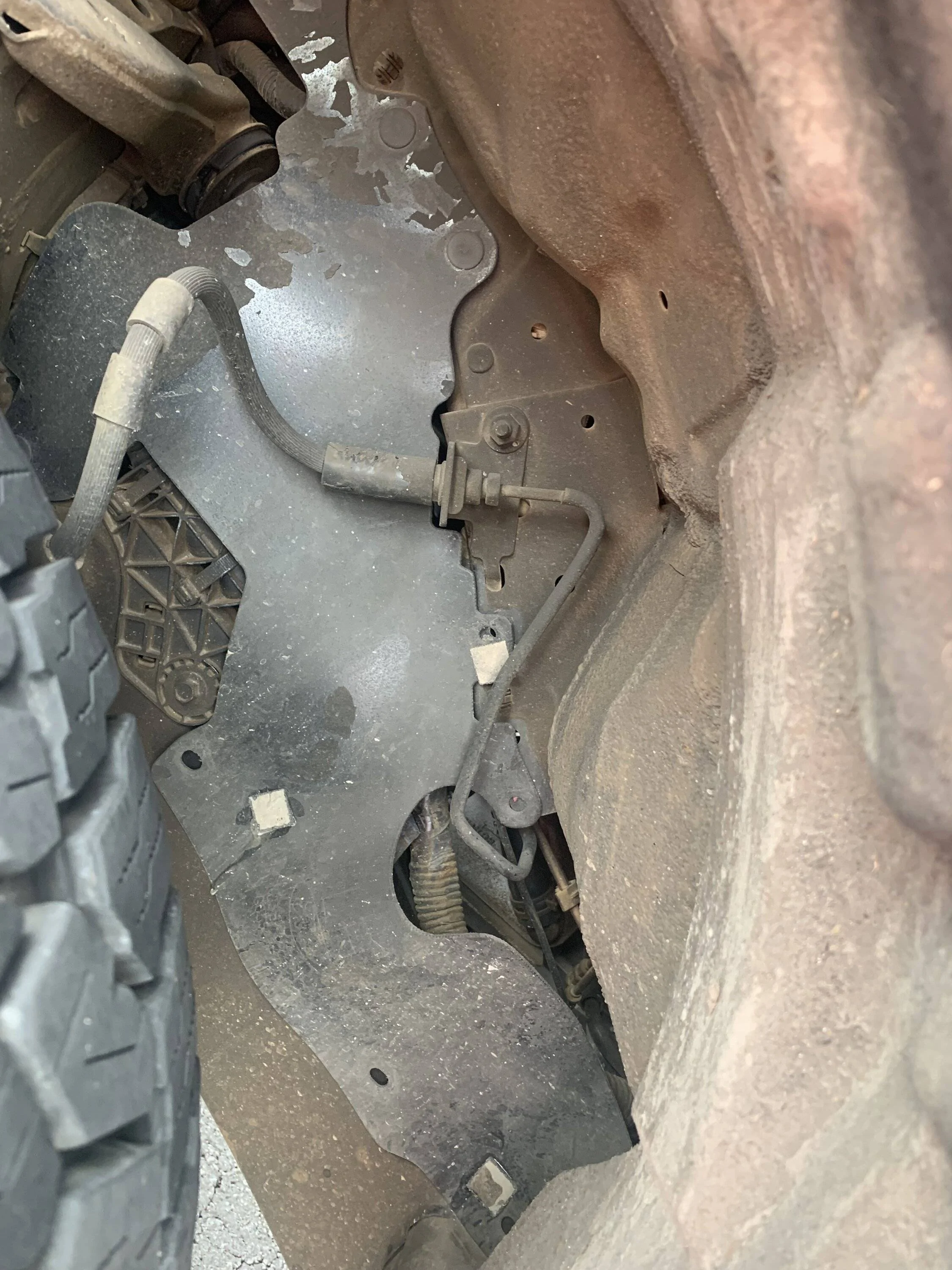

Here is what it looks like. I bought the magnets from amazon and I have one on the outside flap (hot glued) and one between the flap and the frame- so 6 total.
