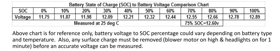

I almost have my Tutorial complete, but you are missing what SOC is on a battery, and the system will charge to 100%, I will reveal what the 70% thing is all about and explain it in detail and also explain why that 70% is causing issues.
Plus, without backtracking did you actually see that number in Forscan , I have conflicting info on that number. Most members report 70% and my truck shows 75%
More to come, hopefully within a week, I want to do some more on truck tests.

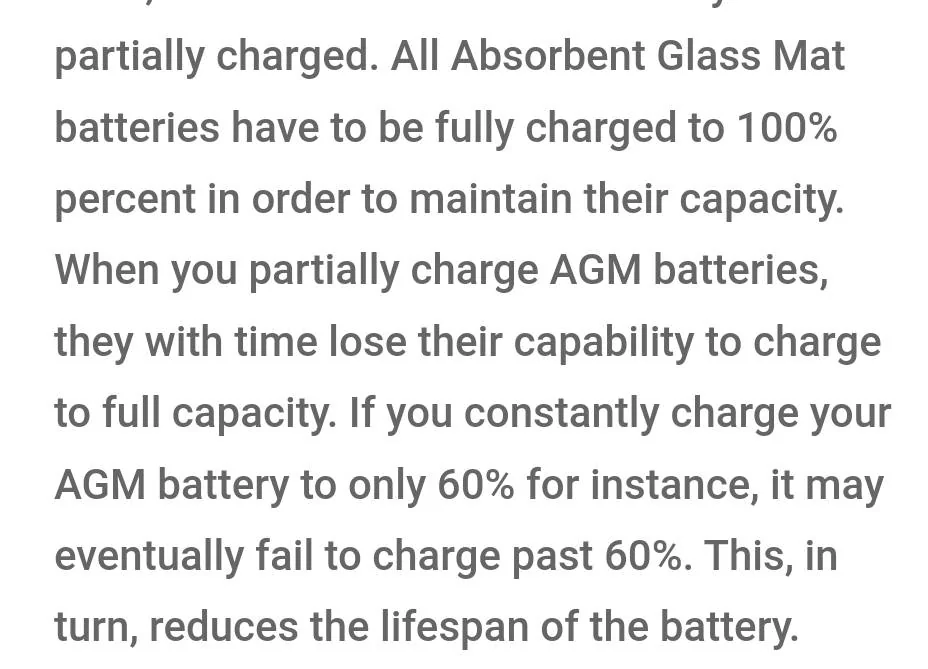

This right here is why it confuses people, this charging cycle is for Deep Cycle AGM batteries, not Starting Battery -AGM.
It is referencing - a external battery charge voltage. Very conflicting and confusing.
If you scroll down to the bottom of that guide - It states -Deep Cycle
