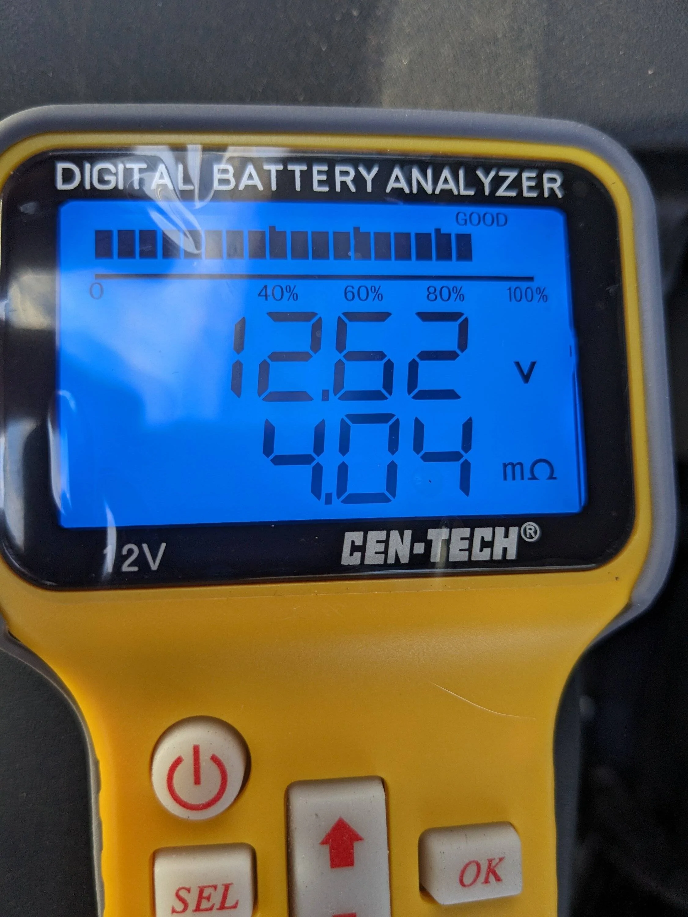

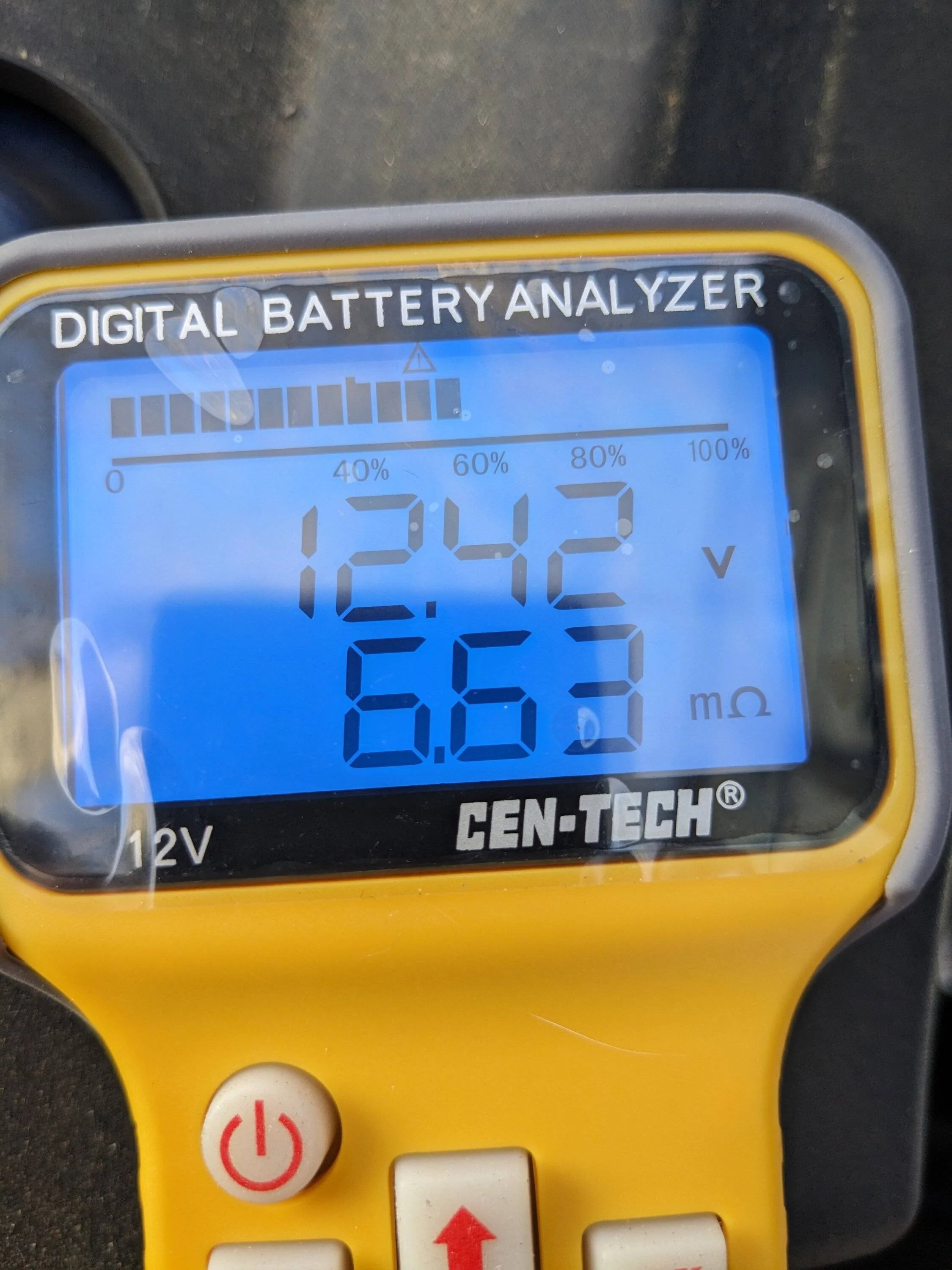

I think my battery is starting to fail, 2020 XLT, 43k miles. Last few days I noticed that on start up that the radio was tuned to a local FM station instead of Sirius XM that I primarily listen to. Also, realized today that the auto stop/start wasn't working when I came to a full stop. One of the first mods was to install the AS/S eliminator, so I had to physically turn the AS/S back on to test it's operation and noticed the AS/S icon with a slash across it on the dash. I tested the battery with a Cen-Tech battery analyzer, then charged battery with a regular battery charger for 30 min, let it rest for 30 mins and retested. See pics for the before and after test. Will the battery Pros please confirm that a new battery is needed sometime soon. Build date is Mar 2020, no extended warranty, no forscan. Thanks for any comments....

The IR is a bit high, however readings will vary depending on where you hook up at the battery.
Ref: Maximizing Battery Life threads
I generally hook up to the small nut right beside battery post (+) and the (-) I hook up right on the post
My readings for IR are around 3.4 mOhms
Testers will vary as well.
I would put on a minder / charger and see if you note improvement as in lower IR in the 3’s
