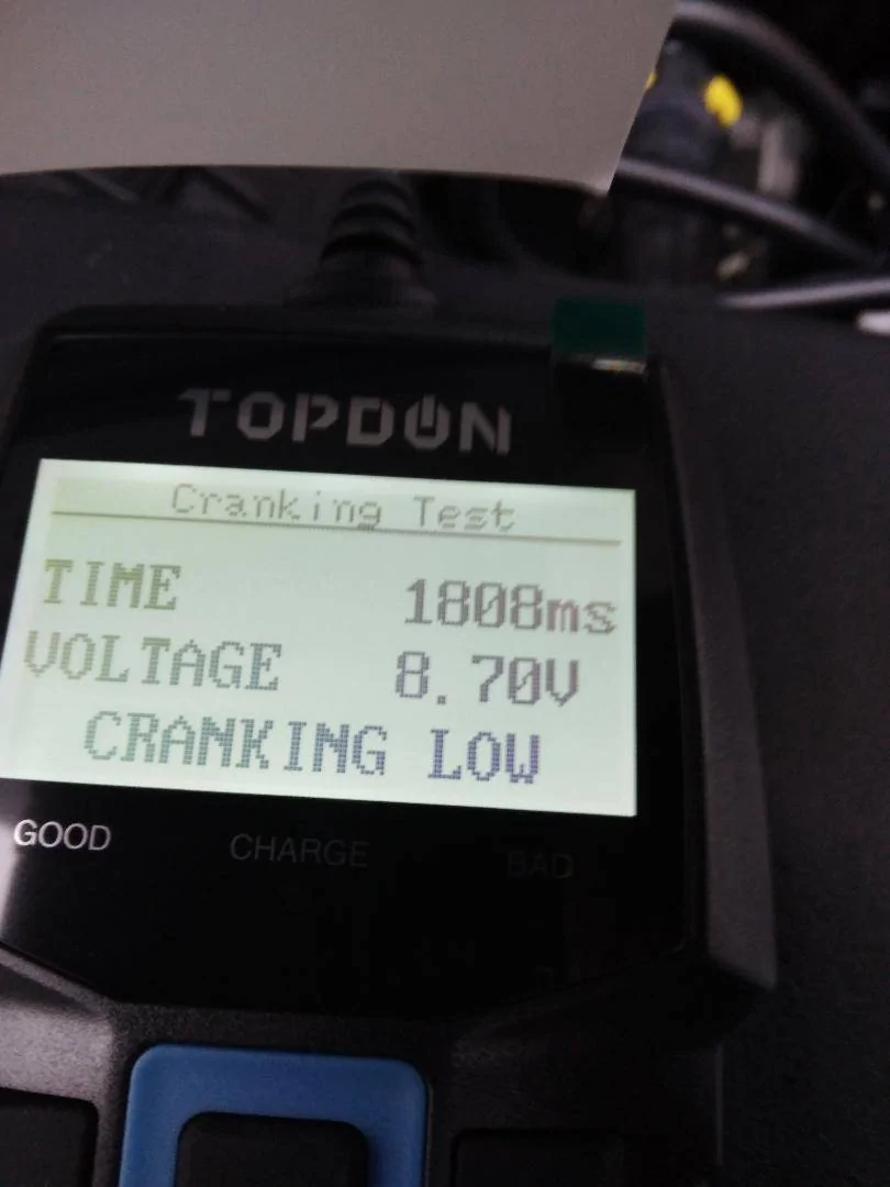

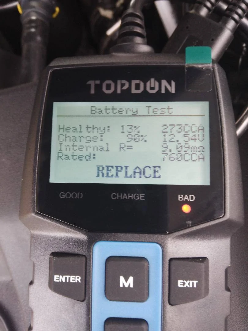

After resetting the BMS in Forscan and changing charge level to 90% from the factory 75% I tested the battery again after a couple driving cycles and trickle charge when not in use, those changes didn’t help with health of the battery.
The results are that the battery is going to have to be replaced.
So off I go battery shopping, just wanted to try all options before replacing it.

After resetting the BMS in Forscan and changing charge level to 100% from the factory 75% I tested the battery again after a couple driving cycles and trickle charge when not in use, those changes didn’t help with health of the battery.
that's a bit of a surprise as the internal resistance isn't that high and the resting voltage isn't too low, but batteries if anything can be unpredictable. Nice battery tester, I want one , the name suggests it could be a mafia enterprise - they might also have ties to battery makers ?

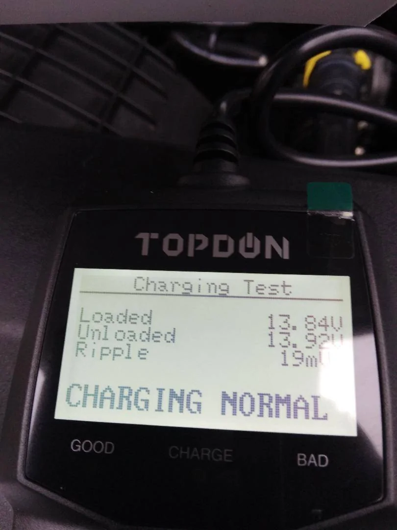

Also interesting is the charging voltage - assuming that is from the alternator while running ? the rule of thumb is that agm 12v batts should not be subjected to voltages much exceeding 14.6v, 15 v the max , only slightly different from flooded lead acid.
If IR>30 milliohm, battery is in very bad condition. Probably unusable.
If IR is between 10 to 30 milliohm, still poor condition but may be usable or revivable.
If IR is between 5 to 10 milliohm, it is in good condition.
If IR is less than 5 milliohm, it is in very good condition.

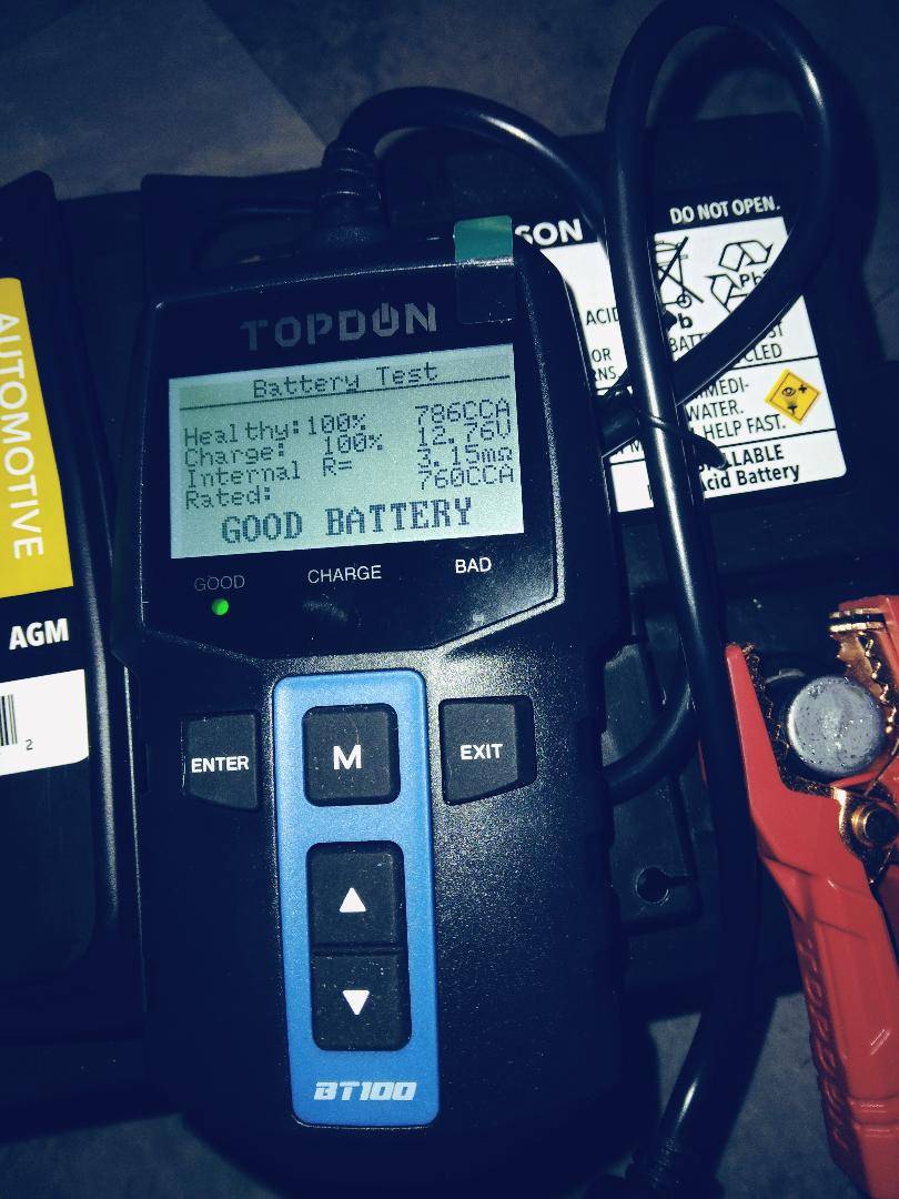

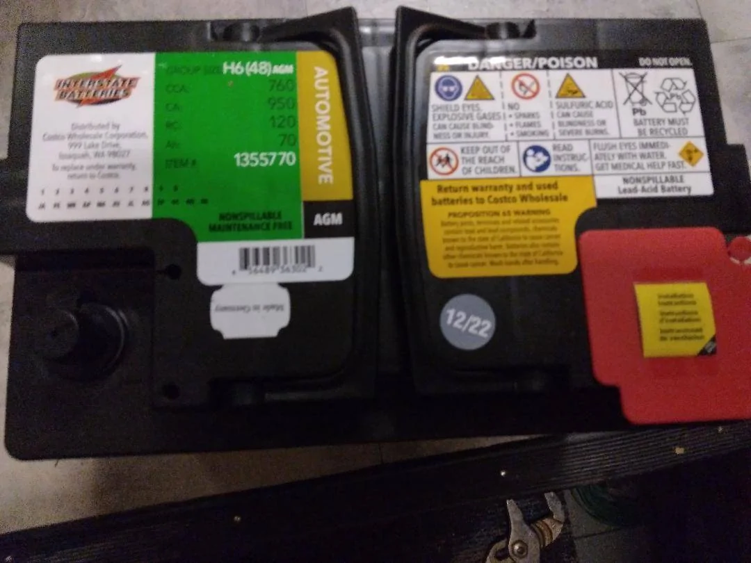

Yea that’s some interesting battery info, since Im the second owner on this and not knowing how the battery was cared for and the low miles when I bought it (7,615) and now a approx 13,400 there was a lot of ‘off’ time plus it sat for 2 months on the dealer lot according to the build date and Carfax sale date and additionally 75% on the preset charge didn’t really bode well for long life.
So before I find myself inconvenienced with a no start it was time to change it out, i purchased the Interstate from Costco, here are the #’s from the tester obviously much better than the old battery.
And the TopDon might be affiliated with ‘The Teflon Don’ LOL.
I was surprised to see on the battery ‘Made in Germany’ FWIW.
