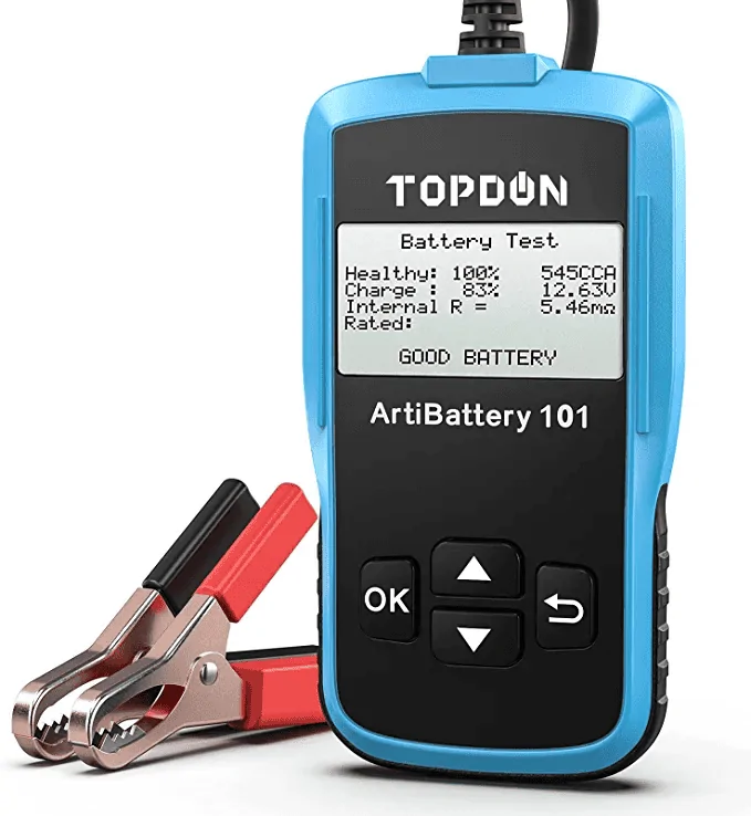

I reconnected The BMS at the neg terminal and then did the Battery reset using Forscan, i disabled ASS too. I have it on the tender not driving it till next week.
I have a battery jumper i usually keep in my other car put in in the Ranger for a just in case situation. I had also tested the battery last week with this and it reported as a good battery although i don't remember off hand what all the measured #'s were and don't have it with me at this moment, I'm going to recheck it next week when i get back home, a new battery may be on the horizon but just want to make sure, not to fond of throwing $200 away on a guess.
Thanks to all for the tips and advice.

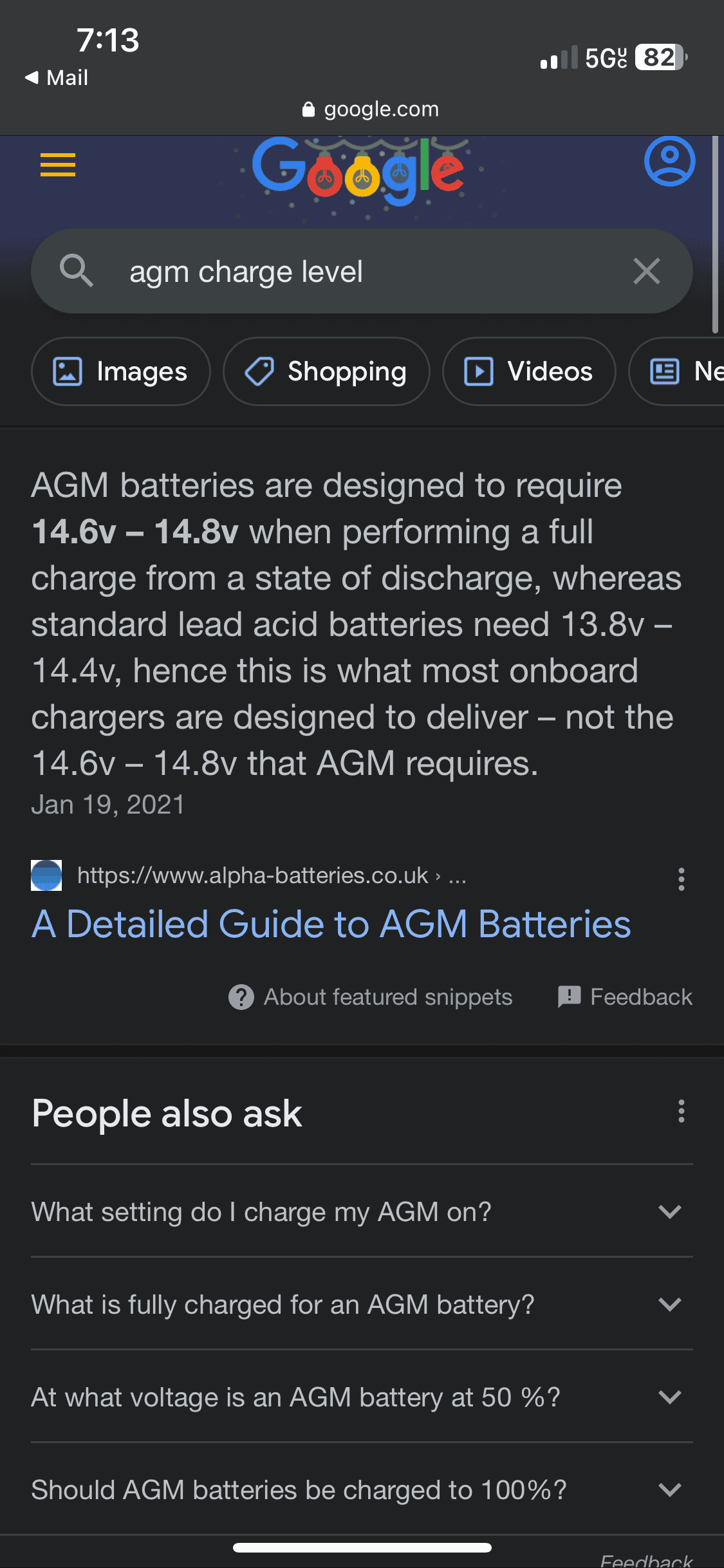

Or it could just be poor quality batteries. Or made to a cheap specification. There is no proof changing the charge will will increase battery life.
AGMs do prefer to be at full charge or near full. First thing on google. I didn't look too deep because I have seen this before.
This right here is why it confuses people, this charging cycle is for Deep Cycle AGM batteries, not Starting Battery -AGM.
It is referencing - a external battery charge voltage. Very conflicting and confusing.
If you scroll down to the bottom of that guide - It states -Deep Cycle
I am putting together a detailed thread on the BMS system, I have more testing to complete
TOPDON AB101 Car Battery Tester 12V Car Battery Load Tester on Cranking Charging Systems, 100-2000 CCA Automotive Alternator Analyzer for Cars/SUVs/Light Trucks with Flooded AGM Gel Types
Being that you performed the BMS reset without changing the battery, I am curious of your outcome and if it fixes the issues you were having.
I am trying to determine if a simple reset of the BMS system will fix the issues owners are having vs replacing the battery and performing the BMS reset (Together)
Like I said I really did not click on it. Here is a linl of one I did click on. Technically applies to all automotive batteries.
https://lifelinebatteries.com/blog/3-tips-that-will-increase-your-agm-battery-lifespan/
