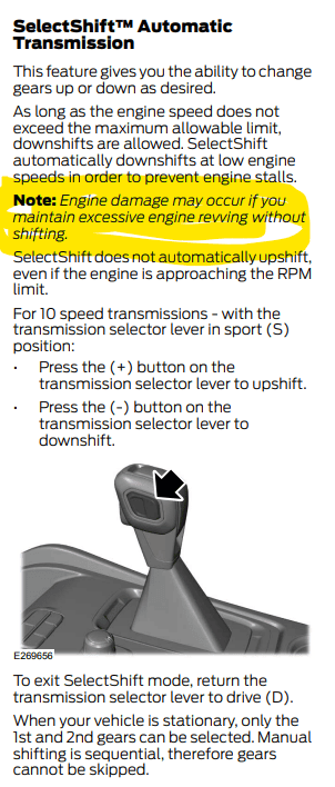

were you select shifting?
I'd say you're lucky Ford is doing a warranty replacement if that was the case.
I've clicked to the wrong gear before and had that high rpm wake the fuck up idiot sound as the revs climbed fast.
Kinda surprised THAT doesn't have a safety feature to protect over rev in Select Shift mode??
Good point, but I only started select shifting after I noticed high engine speeds. Up to here the only manual input from me was to shift into sport mode.

It upshifts automatically in select shift mode if you try to redline it
There's two different "areas" of select shift mode. One where you first drop it into S mode and it shift automatically. If at any time you press the side + button it puts it into manual mode and it doesn't shift at red line. I hit the button once by accident and it shot up to redline quickly in first gear and I was like wtf but then realized it was my mistake. :headbang:
