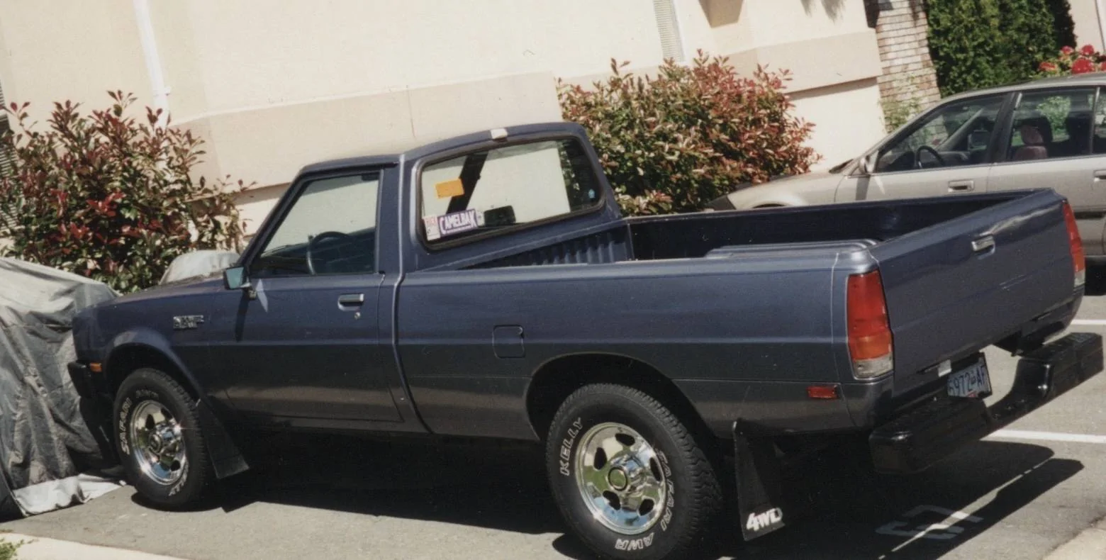

I went through a head gasket on this little guy…
Got that little Mitzubishi motor way too hot, way too many times going up and over mountain passes in BC. I knew I was pushing it too hard but I was young and didn’t have a care in the world - just kept adding coolant.
Eventually, it started leaking a lot of oil out the back side of the head by the firewall - gasket failed between two of the water channels, so no coolant in the oil. FIL said I warped it from overheating it too much so we pulled it, rebuilt it, had it milled and blasted - looked like a brand new top end and ran great.
So, as others are saying, you can cause a host of other issues by ignoring cooling problems and you can blow a head gasket and not have coolant and oil mixing. Well, at least in a fun little Dodge Power Ram 50 - I still chuckle when I think of that model name. ?
