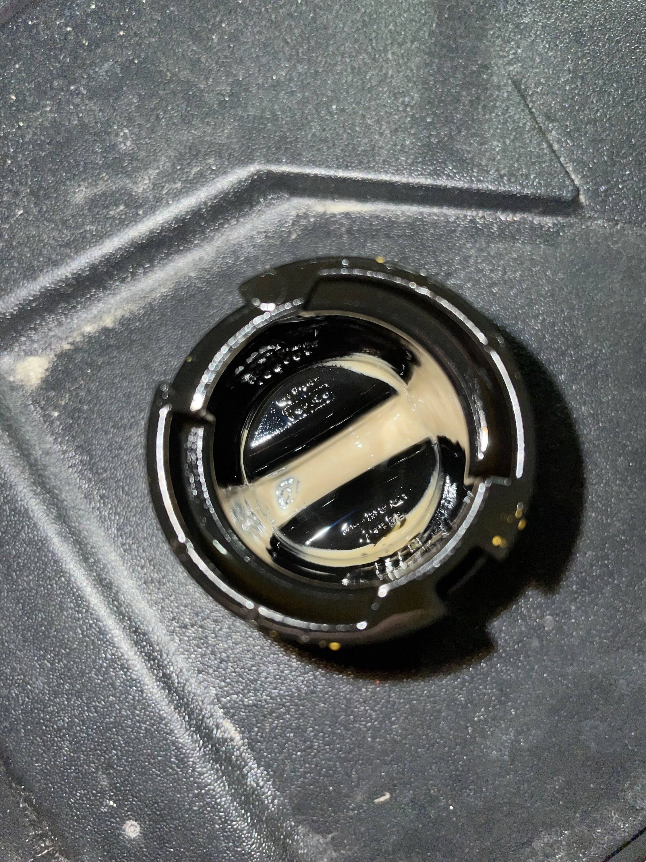

There is some milky residue in the oil fill cap, even after having been driven for 35 minutes.

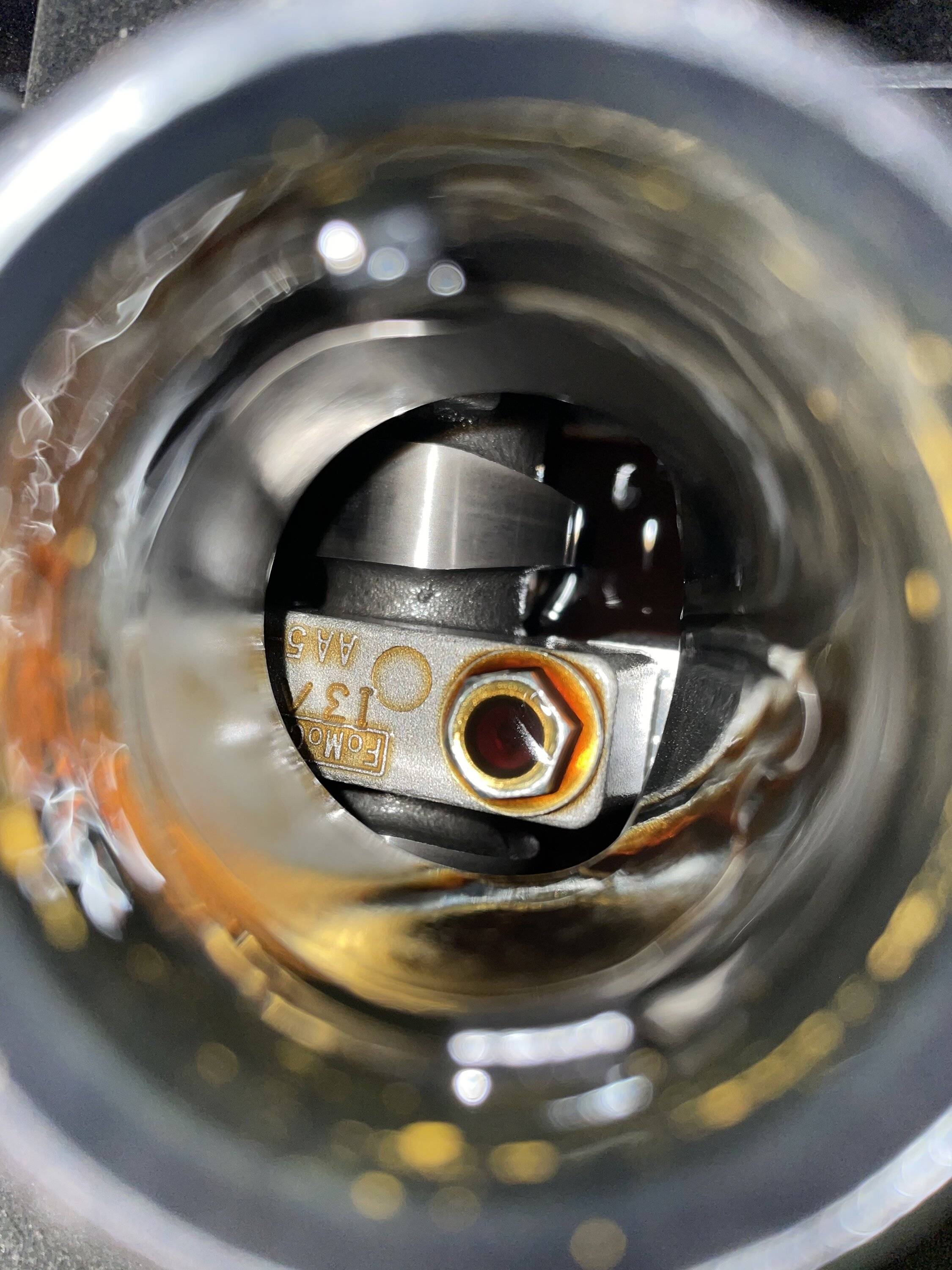

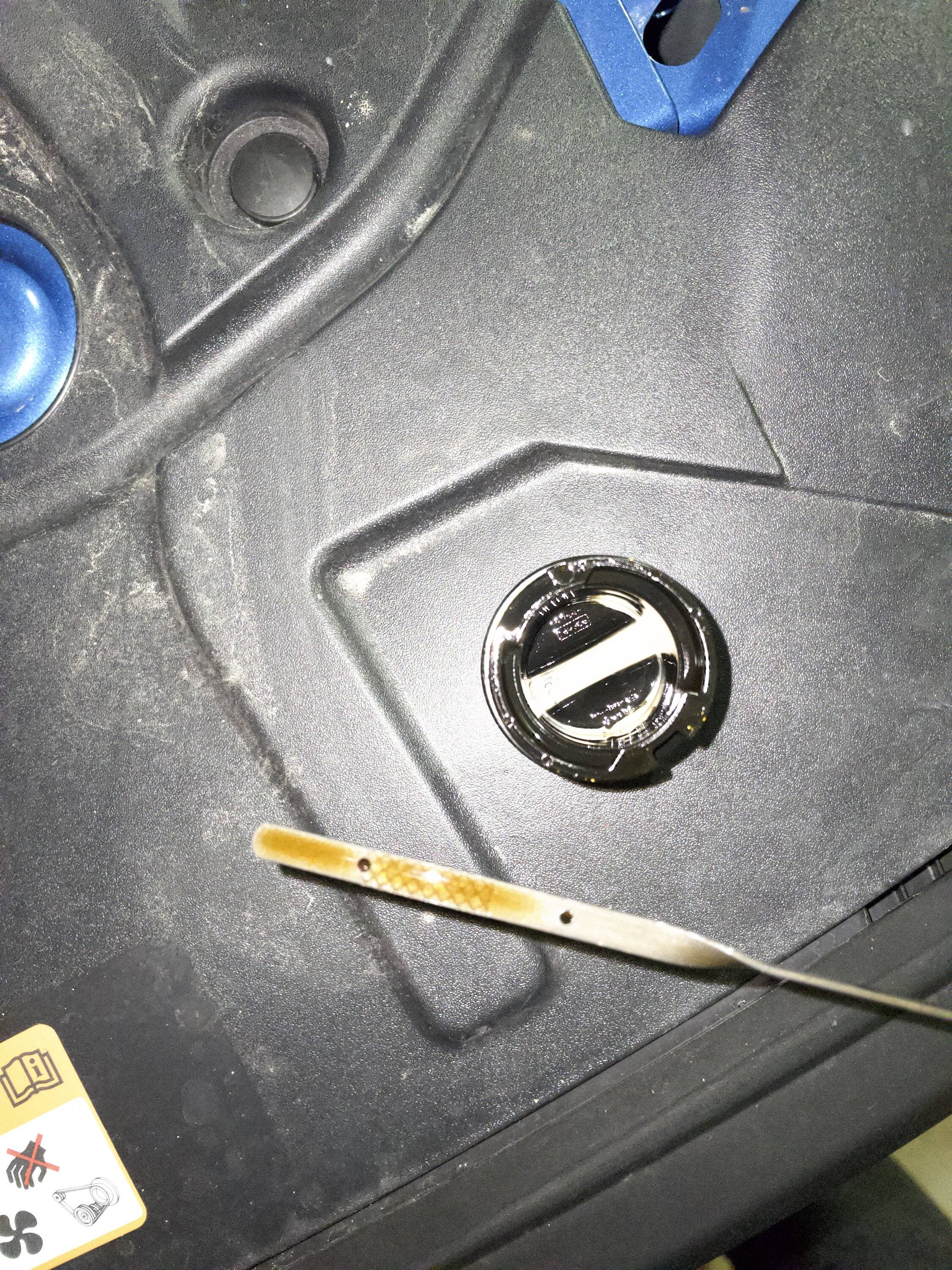

There does not appear to be any of this white residue on the oil dipstick or inside the valve cover. It has been about 2000 miles since my last oil change.

Probably being a little paranoid. Your coolant system will drop ever so slightly over time depending on lots of factors, but its not unheard of to need to top it up now and again. As for the condensation, it exists in almost any engine as a product of combustion (Ever notice everyone's tailpipes on a cold day?) , and some of that makes it into the crankcase, and some of that can condense on the cap.
Keep an eye on things, but I wouldn't be overly concerned about it.

Everything is A-OK based on your photos. As long as your coolant overflow isn't bubbling, or your oil looks like a Peanut Butter milkshake, you're golden.
What I'm seeing mostly is condensation. With the wild swing in the weather the US has had recently, I would expect it. Heck, I am emptying condensation out of my catch can once a week because of it. Give the motor a good romp, let the oil get warm, and it will boil the moisture out of the crankcase like usual.

If you remove you dipstick and it has creamy consistency and looks like coffee ice cream (re your 1st photo above). then you have water in the oil. The mechanical agitation of the water and oil inside the engine forms an emulsion. You could then have, very possibly, a cyl. head leak. That can also happen if you have a cracked block, but not very likely.
