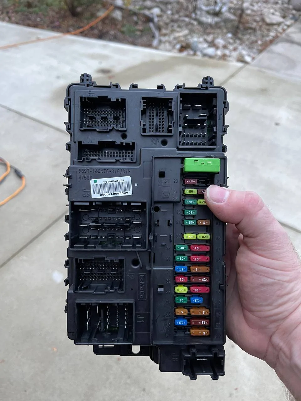

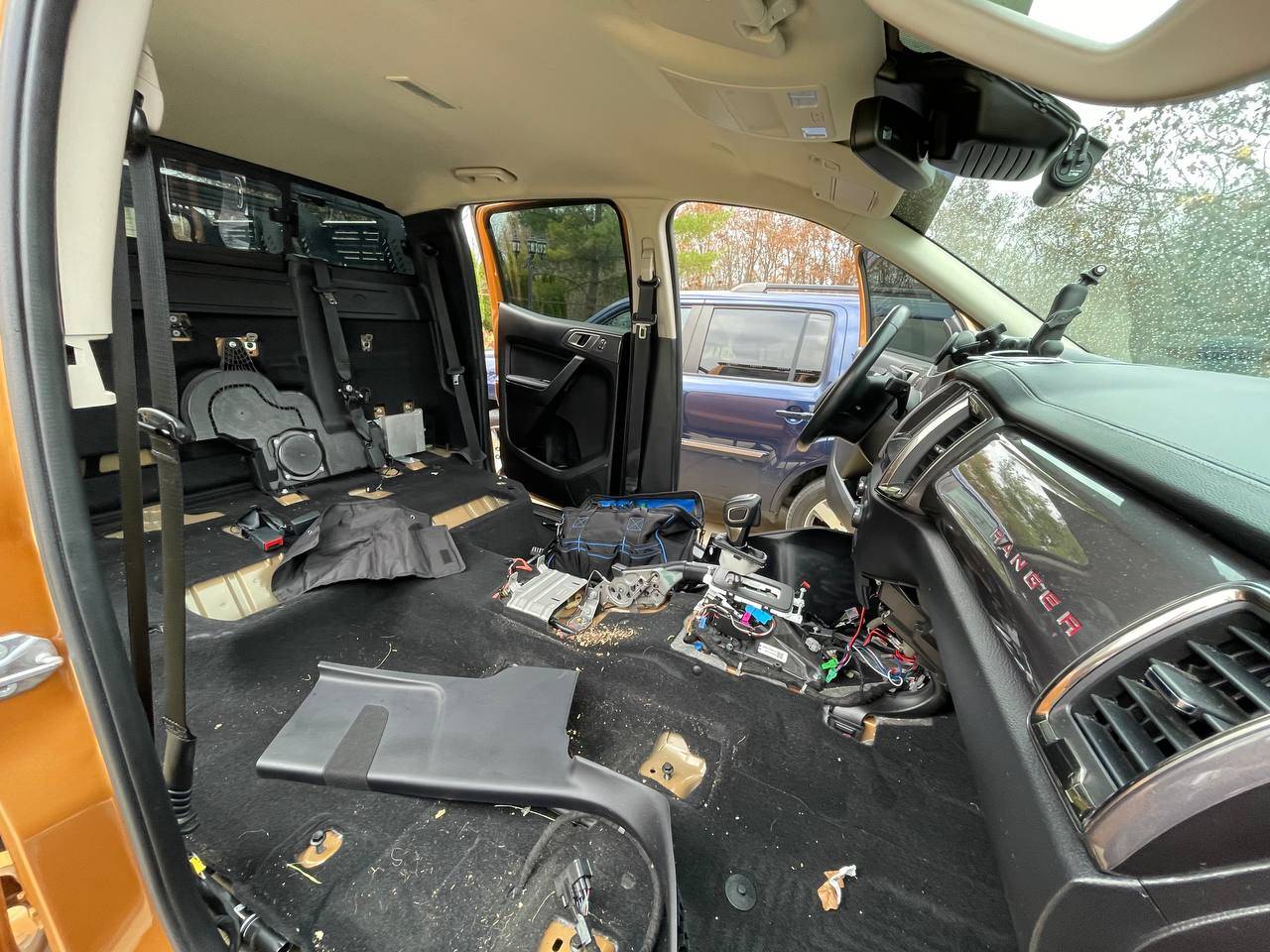

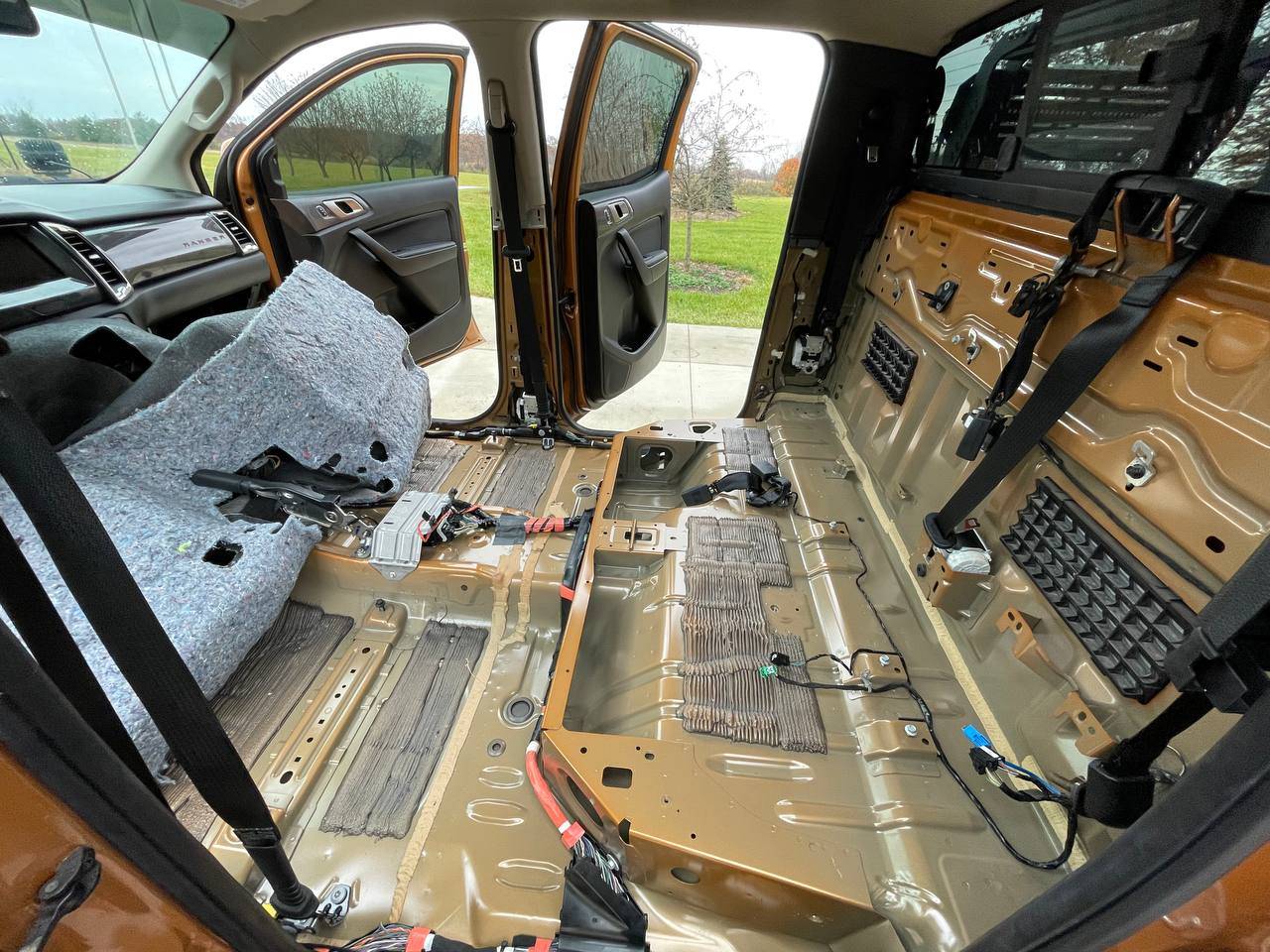

I've been fighting what is either a wiring issue or a module (BCM) issue for ~20k miles. Random (mostly) resets of traction control, Oil Life, ACC (as a note I DID relocate the radar sensor but that didn't coincide with the other issues), Traffic Alert (the things that alerts if a car is next to you on the mirror) as well as (a couple times) where the dash cluster just completely resets while driving, the radio shows a "disc read error" or resets and occasional seat belt warnings (mostly in the rear seats, the drivers seat had this but a re-seat of the seat coupler fixed it).
The oil life reset is a WEIRD issue since it's "calculated" and there's no sensor tied to it... And it happens A LOT. Like, every 400-600 miles.
No, I haven't taken it to the dealer, because "there's no code, we can't help" crap. And there's really no other option.
I thought MAYBE it could be a rodent issue, as I had found rodent food leftovers at one point, but no real damage. More recently I was doing brake work, opened up the center console to loosen the parking brake cable, and found more food leftovers. So, I decided to pull out the ENTIRE interior up to the dash and NO WIRING ISSUES.... I'm still going to check in the cabin air intake area and all up in the dash, but my initial findings don't show anything wrong there.
So anyway, on a hunch a while ago, I replaced the Gateway Module (this device interconnects ALL the CANBUS networks and is what the OBDII port is attached to. This actually fixed the issue, for about 2k miles. Then the same things. So I swapped back to the original one.
Right now the BCM is out of the truck. I'm trying to figure out if I can re-program a new one myself via forscan.... and just replace it....
My only other option is to data log the RAW Canbus streams and hope that I can catch an error of some kind and trace it back to a faulty module.
I'm just.... so tired of this crap.

Yeah, copied over the data that i backed up from the old GWM (I think it's just the VIN in this case).
1,2- Resetting connectors has fixed some things in the past, so doing that on this round with everything. Also checking for bent/damaged pins.
4- yeah, did the relocation to the upper part of the grill, while doing this to avoid connection issues, I unwrapped and re-routed the entire harness for that device, as normally you'd have to stretch it really tight. I re-wrapped with harness tape, both sections (after I split out the ACC wires). I did run the built in reset of it via forscan, though the issues I am having started after this.
7- I installed a tune about 10k miles ago, it eliminated Auto-Start/Stop but same issues before/after.
I've had the failure happen at a few points where it would NOT reset until after I power cycled the truck. E.G. The oil life reset to 0%, and when I'd go into the menu and reset it to 100%, it would immediately fail until the truck was cycled. When this happened, I attempted to log data from the OBDII port and it would not connect. As in, the adapter had power but the data coming from the port was either not there or erroneous enough cause the forscan app to not read it. Which is part of the reason I'm curious to try a raw datalogger.
Oddly enough, some of these issues started soon after I did my own oil change (used the "free" ones with fordpass points for the first 6 rounds). But that's just coincidence.
Anyway, thanks for the info! I do love the truck, because offroad it's a BEAST but the creature comforts being hit and miss is annoying sometimes. 90% of the time it works 100% of the time.

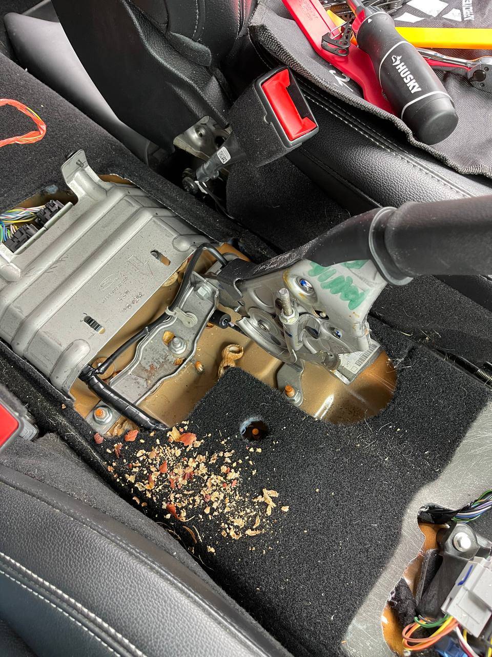

Just Curious-I'm thinking of doing a preemptive strike on protecting the cab from mice entry, I know about the -Air Inlet Door allowing access point but how are they getting under the center console. After reading through this forum, it appears quite common. I'm going to add a screen under the cowl, any other areas to mod to create a barrier?
From what I've found.... That's really the only entry point big enough for anything to get in. And in that case, it's basically open behind the wheel liner, into that cowling area. There's the vents in the rear behind the seats, but I don't see anything easily getting in there. The cabin is otherwise pretty well sealed.
