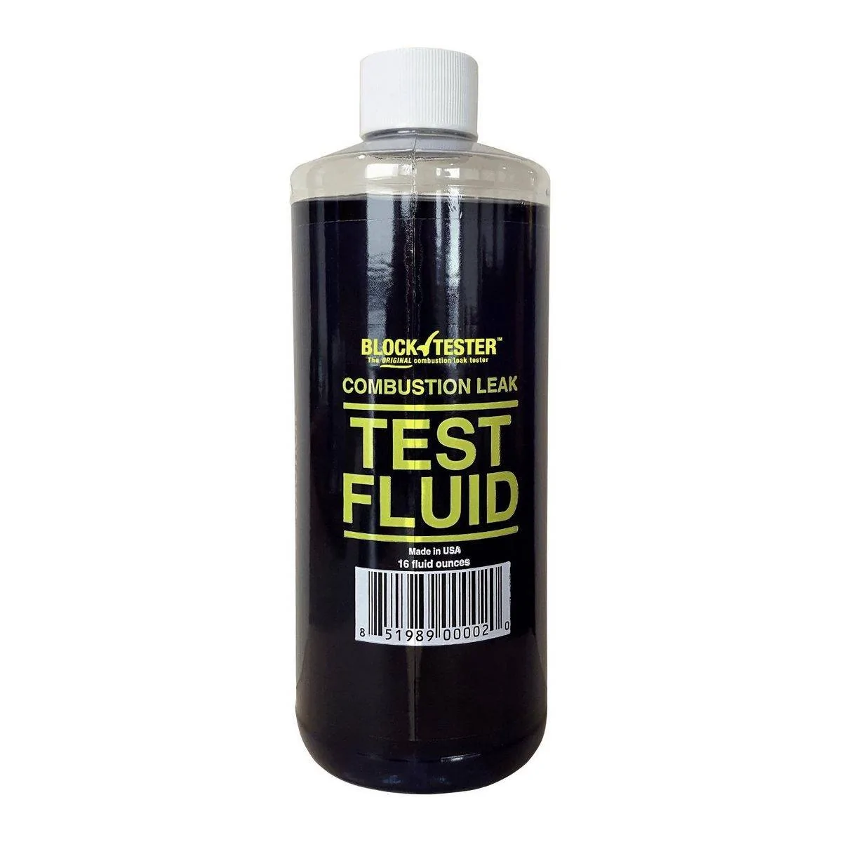

Strokerduster
Oct 16, 2018
631
2,507
2019 ranger XLT, 2019 Edge ST, 1946 CJ2a street rod, shop full of motoorcycles
Easy to verify with test fluid.....
