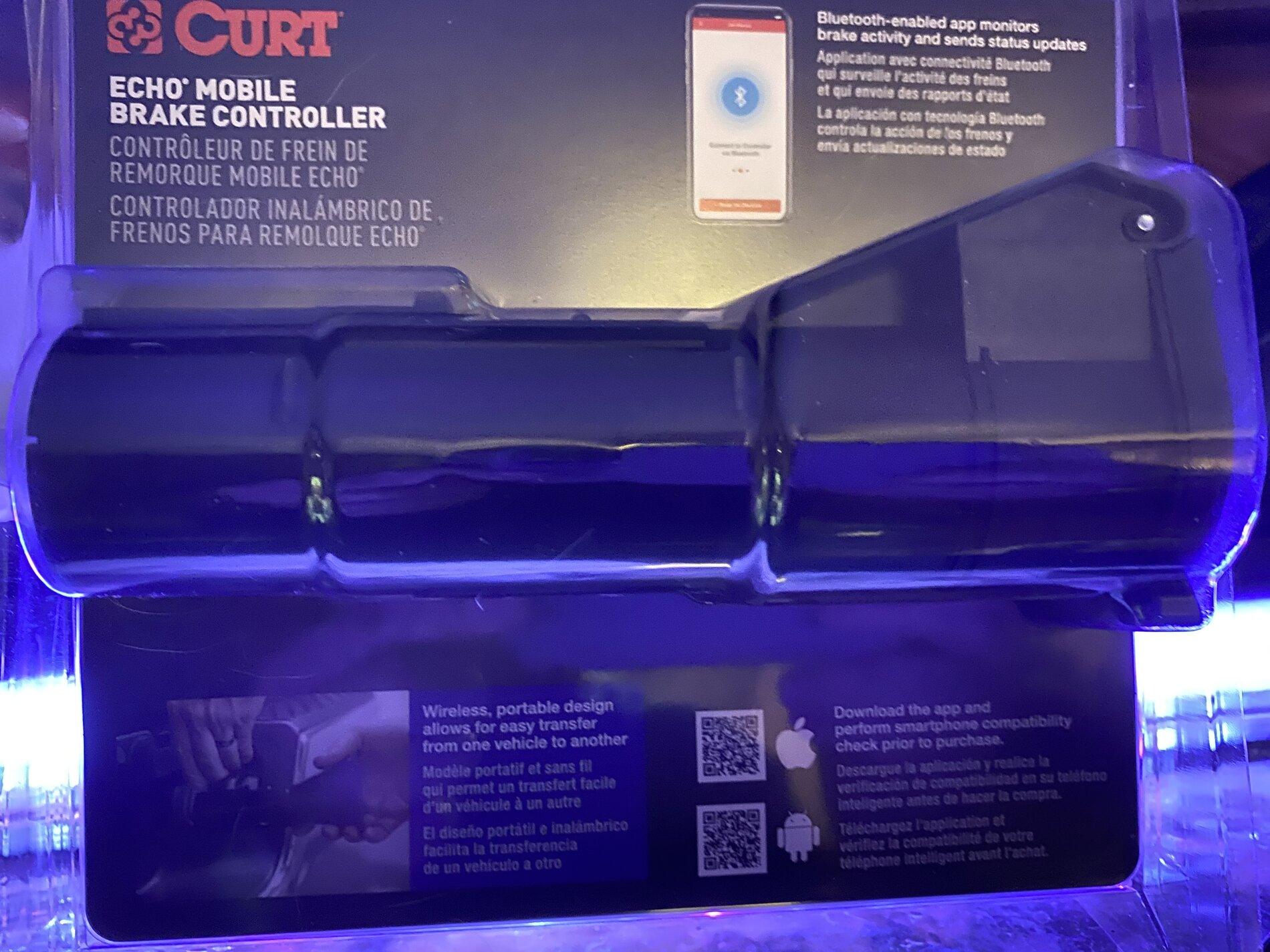

This is what I use .... bluetooth to my smart phone. Works great and you take it with you when you trade.
You use your smart phone as the in cab controller. Can set it up for multiple trailer profiles, 4 I think.

The hitch was installed yesterday, so of course I took the trailer for a ride today, ya know to "test" everything. The bluetooth controller worked as well on the ranger as it did on my jeep. I just took it with me no wiring.
