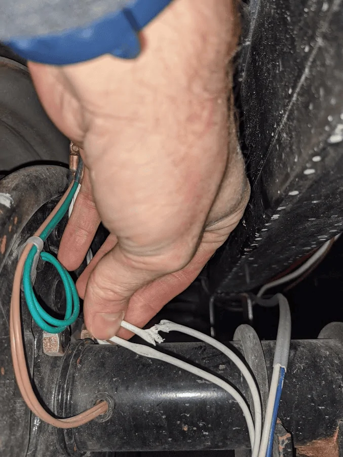

Chiming in again to say that I've updated my phone (Pixel 4 XL) to Android 11, and now I have major issues staying connected to the Echo. It's the phone's fault, but it's made the Echo feel useless to me. Bluetooth between my phone and the truck has gotten sketchy since that update as well, and I've had to re-pair it a few times.
Turns out the Echo is fine!!
What was happening is the app had started saying that the 7-way had become disconnected whenever I used the brakes for the first time. This behavior started right after my phone was updated to Android 11. I also noticed that bluetooth to the stereo was kinda sketchy after that, too, so I figured it was something to do with Android. But then I tried an older tablet of mine and it did the same thing.
So then I bought the TowPro Elite from Ford and installed it today.. and it didn't work either.
Turned out that my trailer' brake wires got crushed by the suspension and eventually broke entirely ?
Silver lining.. the TowPro Elite is quite nice. It was a massive pain in the ass to install, though.

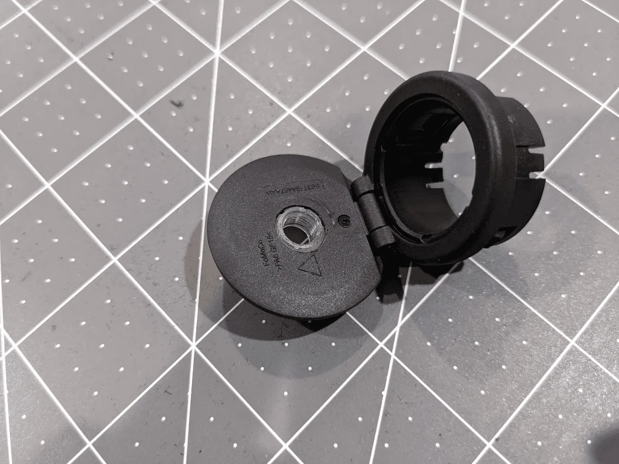

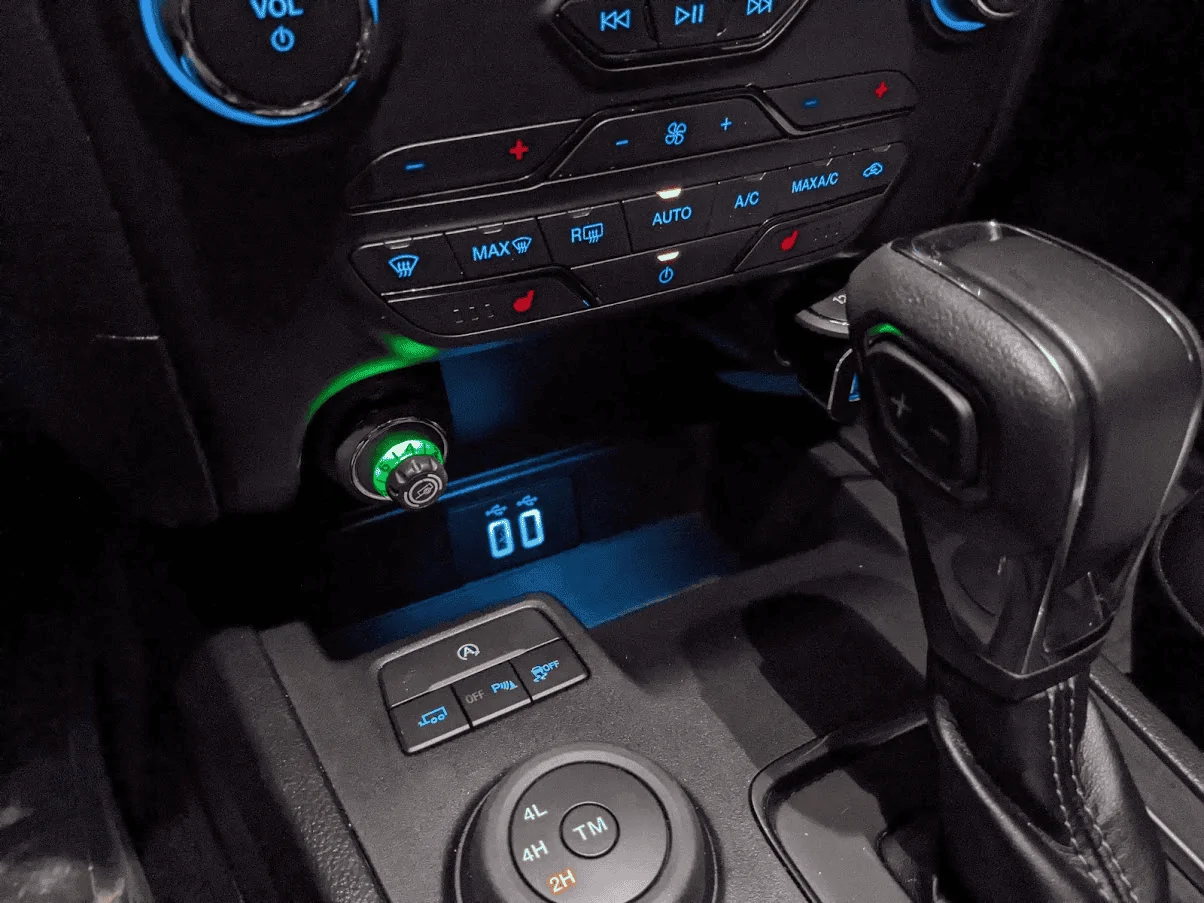

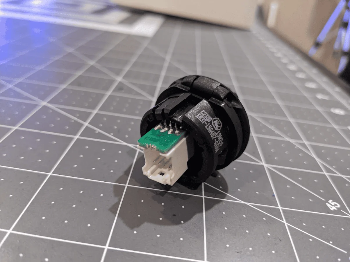

Thought I would be clever and drill a hole in the driver-side 12v lid so that I didn't need to buy the special bezel. It turned out great, but it was not easy to do! The lid is 3 parts and basically exploded while being drilled.. but I managed to piece it all back together without any of it breaking:

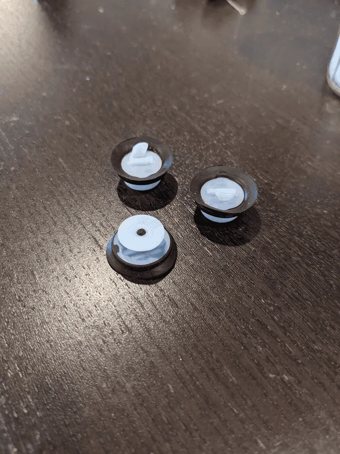

Anyone know the part number for these clips that I broke, or where I can get some cheap equivalent? I see some on Amazon etc but lacking the rubber.
Also need some of the white ones that are used on the back of the big cover below the steering wheel, the one you pull to get to the fuses

Following up with myself - https://www.aliexpress.com/item/32812326106.html?spm=a2g0s.12269583.0.0.2be2559bBwv5qR
Arrived today, they fit perfectly. They look identical to the OEM part than they do the listing photo.

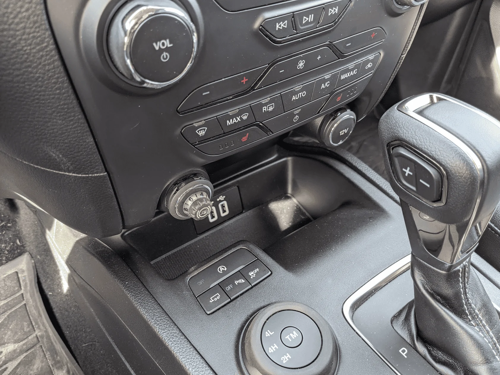

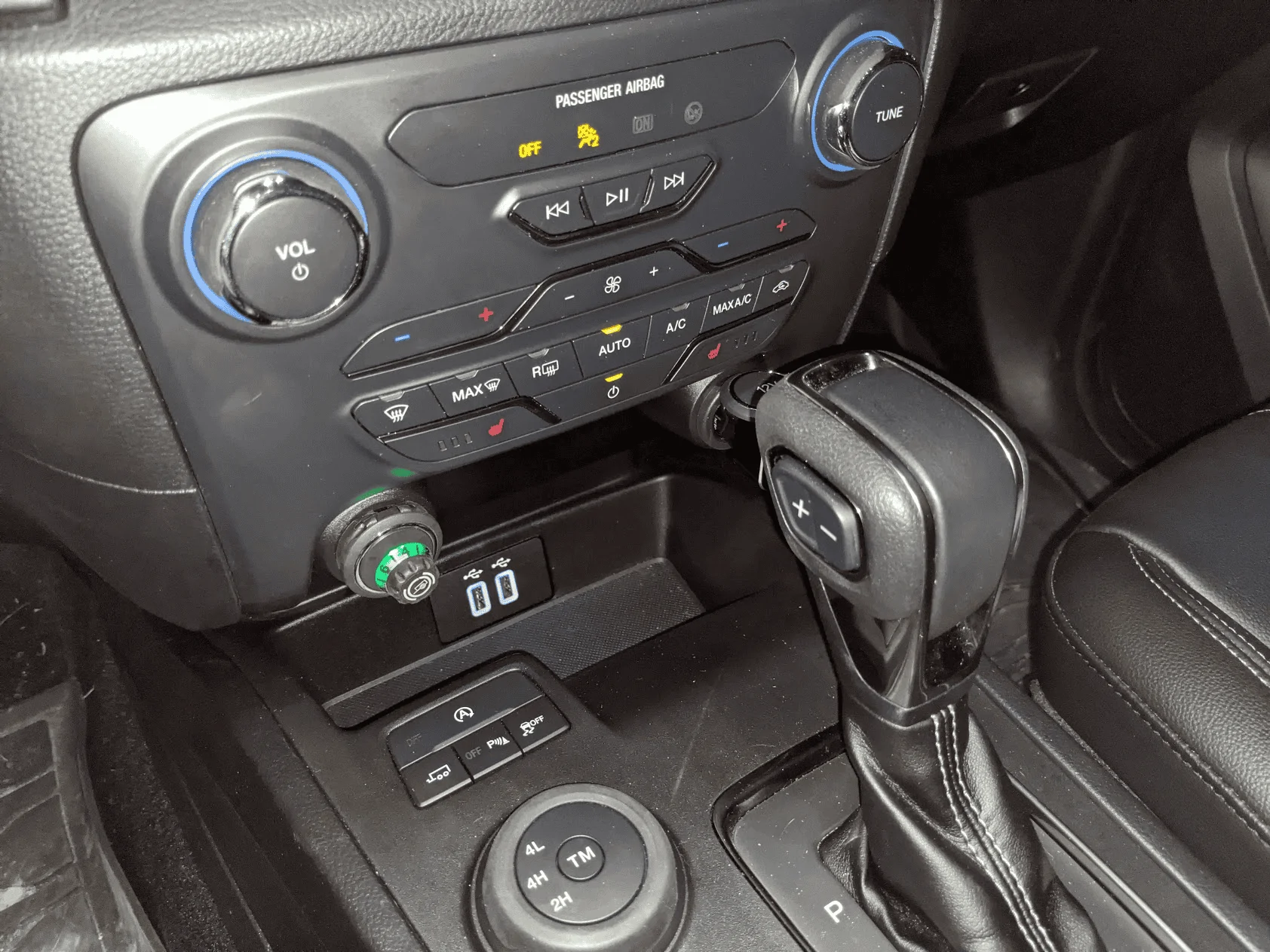

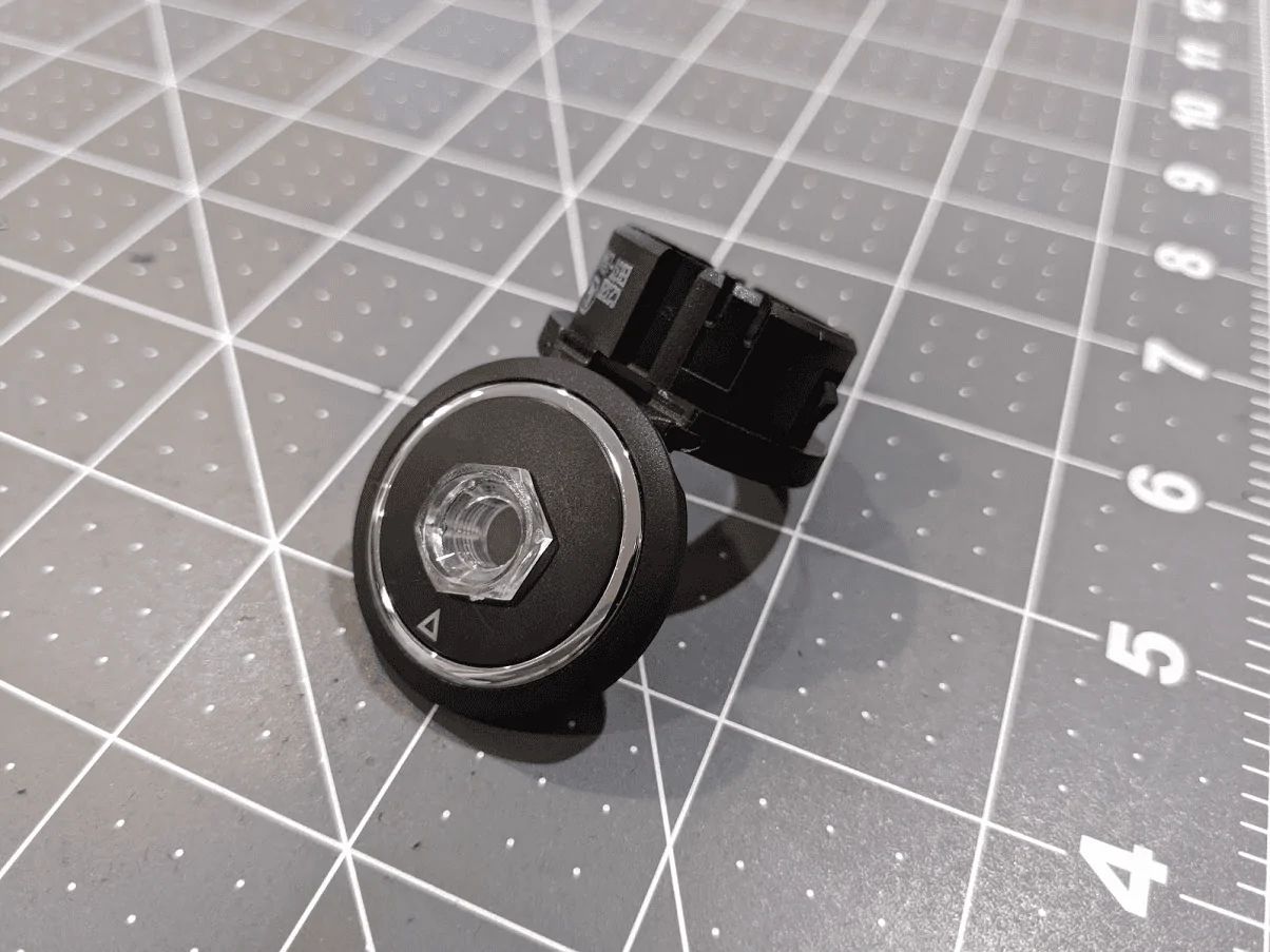

On the weekend I decided to recess the hexagonal head of the clear plastic fastener. Hard to tell in photos, but it's much better looking in real life:
Recessed
Stickout out (aka 'before'):
