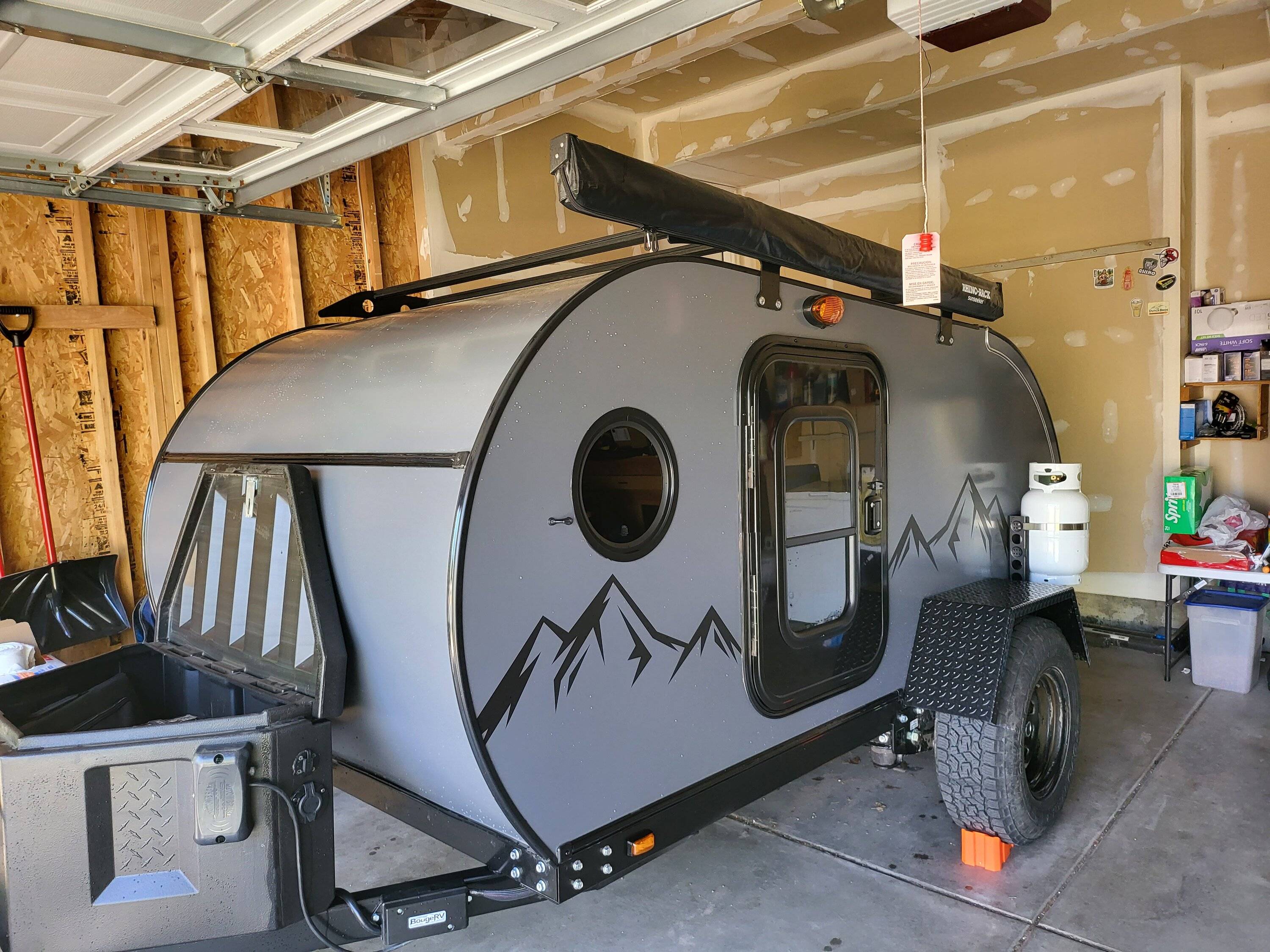

Thank you. I’m gonna wire this up and see how it does. Out of the box, it has wires for +12V, Ground, sense wires for Left Turn and Right Turn / Brake, and then an output to the electric brakes on your trailer.
Looks simple, has a remote to control sway, and can also let you “fine tune” the level for higher or lower braking force.
Product is heavy, looks well built, and not of cheap quality. For a $400 (including shipping and tax) brake controller this thing is impressive and doesn’t feel like cheap overseas junk.
