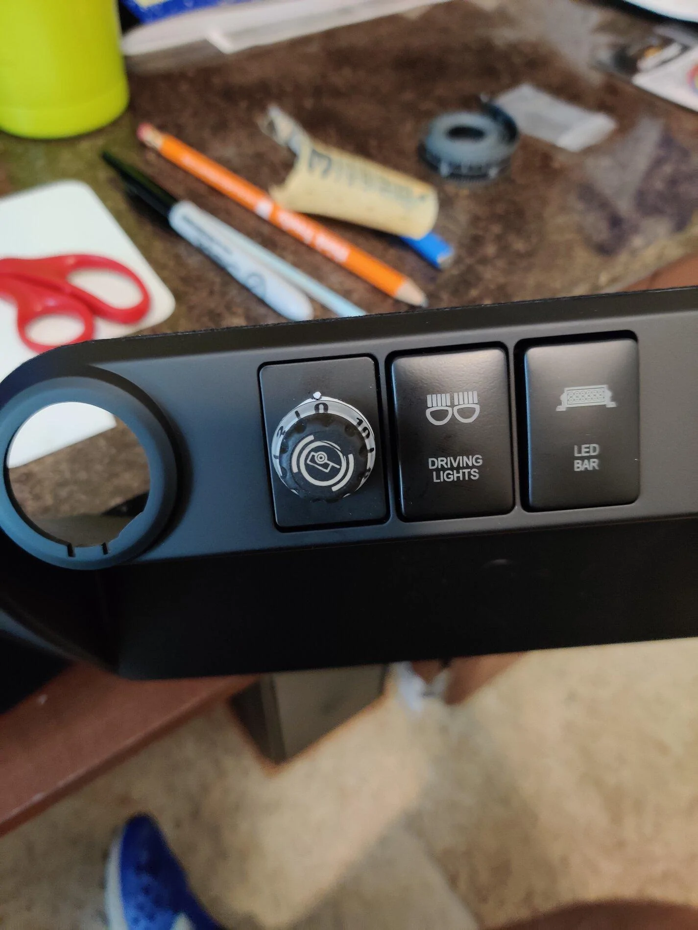

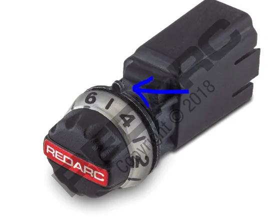

Ranger8729

Guys that have teh Ford branded Towpro, I've got mine installed and seems to be working. I just left the button hanging until my Lightforce fasica arrived, so I went to install it today. I have some slop in the switch and trim, and seem to be missing the spacer/indicator washer. Do your switches have this piece?
Nope, no tab on the switch and no washer/spacer in the kit. I noted that the switch was a more secure/snug fit in the round fascia (that I bought aftermarket) than it was with the rectangular one included with the kit. Both fascias had a notch inside that would match up with the tab you're pointing out.
If the nut on the switch isn't tightening up enough I bet a regular flat washer would be OK.

Okay, good to know. I searched everywhere but I was positive it was not there when I opened teh kit.
I do some scale models so I have sheet plastic around that I'll try using to make a spacer with. It'll give me something to do with all the rain outside.
Edit: meh, acceptable backing
