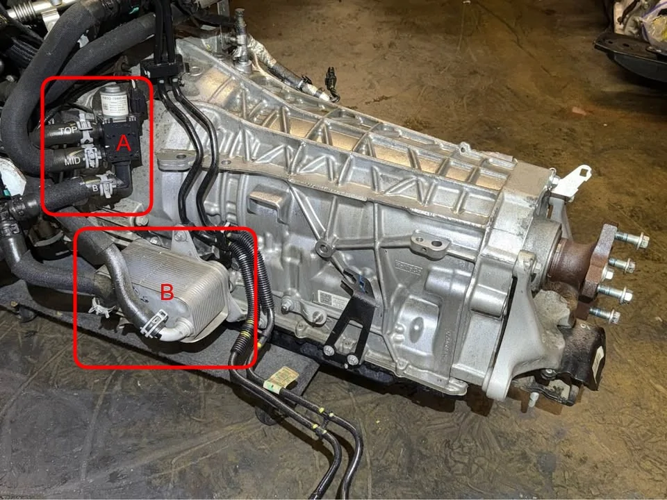

I am not sure which thermo valve they are talking about. There are two distinct thermal valves on the 10R80 in the Ranger.
An external heat exchanger with a thermostat that opens to allow coolant to lower temps to ~ coolant temp, and an internal thermal valve that is located in the valve body.
See this article for details
Ford 10-Speed Transmission Cooling: Heat Exchangers, Control Valves & Basic Diagnostics
I have not priced parts for either. Thios excerpt from teh article explains it better than I coild.
Two Basic Types of Transmission Cooling Systems
The Ford 10-speed cooling system’s main objective is to keep transmission temperature within +/-10°F (+/-12°C) of the engine temperature. There are two basic types of transmission cooling systems in Ford trucks with the 10R80, for example.​
The first type has a large heat exchanger located at the transmission or frame rail. It will have engine coolant, radiator coolant and transmission fluid flowing in separate chambers to the heat exchanger. A solenoid-operated coolant control valve will control the transmission temperature by allowing either engine coolant to the heat exchanger to bring temperature up or by allowing radiator coolant by default (with no electrical solenoid activation into heat exchanger) to cool transmission fluid.
The second type will have a smaller heat exchanger and an oil-to-air, separate transmission cooler. It will have both a coolant control valve and a bypass valve integral to the heat exchanger. The coolant control valve allows engine coolant to flow through the heat exchanger to warm the transmission during initial startup, and then the bypass valve takes over by either sending fluid back to the transmission to warm the unit or to the cooler to cool the transmission.​
Note: Some 10R80 valve bodies had a thermal bypass valve for cooler flow, and now in most valve bodies, the thermal valve element has been removed from the valve body bypass.
Here's a picture of the "heat exchanger" on our Ranger. It works both ways - warms up the fluid when starting, then cools down the fluid once the engine enters normal operating temps range.
I suspect that they are alluding to the external thermal cooler.
Bel;ow is a Ranger 10R80 where I have highlighted the solenoid and heat exchanger
A = the solenoid coolant route switch
B = The Coolant to Transmission fluid cooler

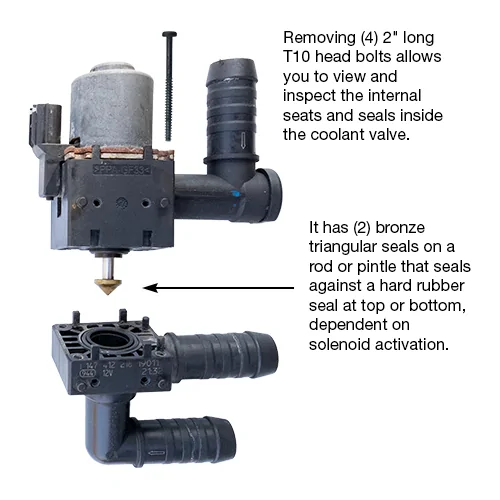

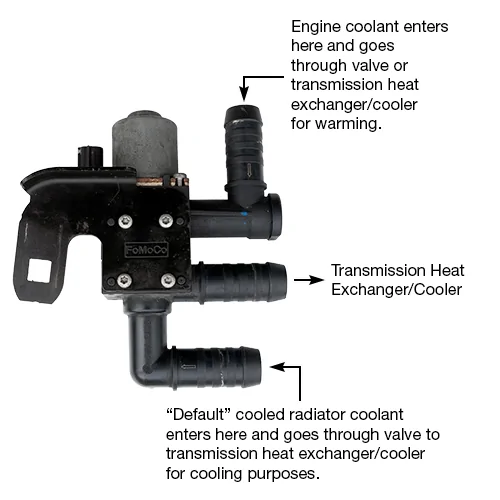

From the same article....
Solenoid-operated Coolant Control Valve Functionality
This coolant control valve deserves special mention as it has a history of failure. Methods of physical examination are outlined (Figures 1 & 2).
This solenoid is known to stick and to leak. When it sticks open ( coolant flowing ), the transmission fluid temps stay pretty much in synch with the coolant temp. If it sticks closed, the transmission fluid will rise too much at idle in D, and will drop once the truck begins to move. The heat is largely (>70%) coming from the torque converter. Once you get up to speed the converter will lock the speed, and fluid temps will drop. Hence the spike the video alludes to. Changing the solenoid is relatively easy and the part is probably ~$50.
I plan to remove the heat exchanger, then install an adapter that routes PTFE hoses with 8AN fittings that go to air to fluid cooler. I will leave the solenoid electrical connection in place, but block the 3 coolant ports. I'll then connect the input and output hoses coming from the engine together to keep fluid flowing. This keep the computer happy.
I have collected all the necessary parts, just waiting for the service interval coming up to get to it all.
Hope this provides some of the detail that you were seeking.
