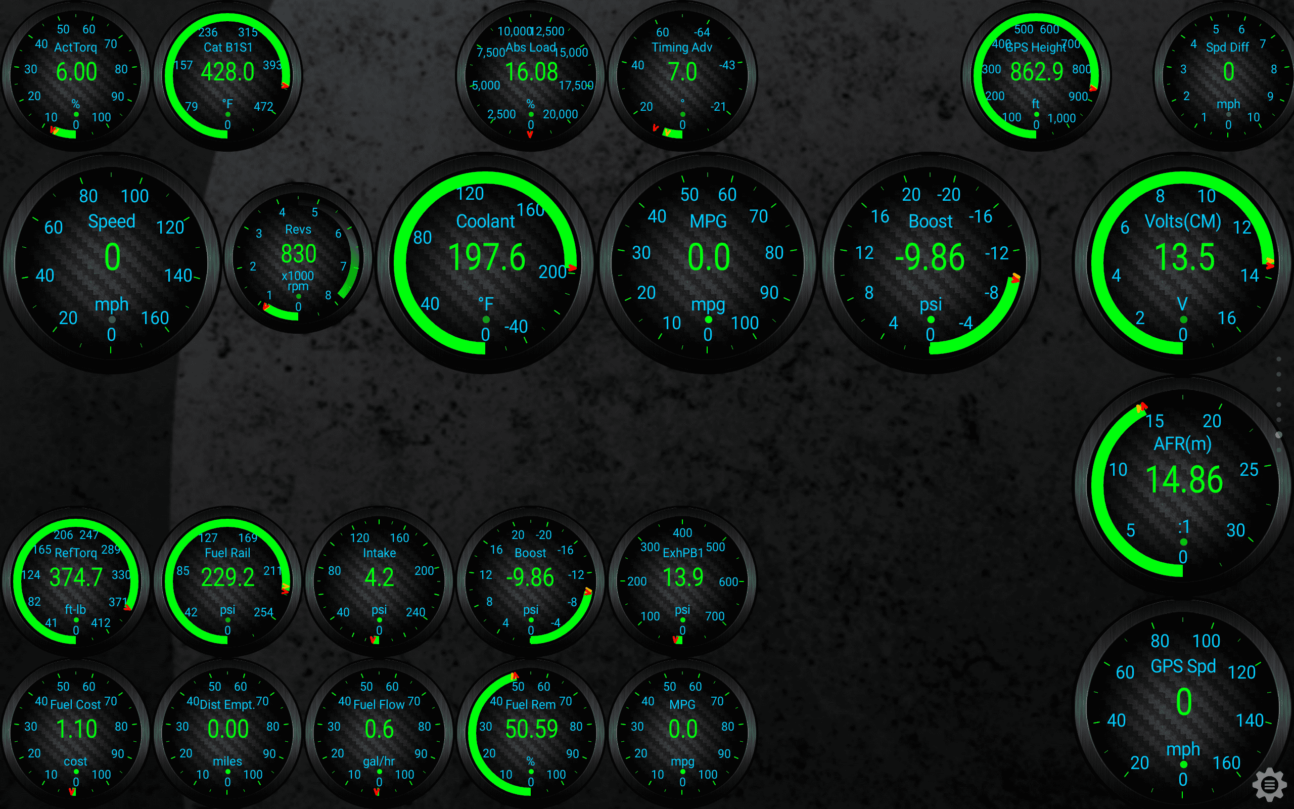

I love Torque Pro I have used it in my last two Ford trucks and have it set up to monitor all the strange things
I really want to know why it reads so high on fuel rail pressure though LOL
2-3000psi is about normal for GDI. Long way from the old port injection days
I was thinking to see maybe 17 to 23 and as high as 70 psi when I first seen this I thought some sensor was reading wrong LOL
You're able to view all of those gauges on your phone?
He's probably using a tablet or something with a massive screen. Having all those on screen looks cool, but it slows the update rate down and a bunch of those are just calculated values and not really useful for much.
Super fun to watch though.
I suppose I should have thought it was a tablet instead of a phone.
