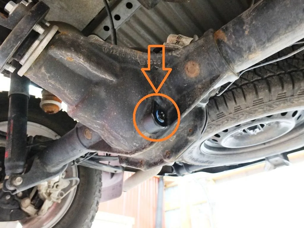

Item #28: Removed differential drain plug.
That must've saved them in the tens of cents on each truck :mad:

It's better to pull the cover and clean all the wear debris out of the dif when you change fluid.
Otherwise all that crap continues to circulate through the gears and bearings.

The diff drain plug isn't gone, just relocated.
Unless this was another "cost down" casualty.
Is this missing on the later trucks?
I was annoyed about the missing plug until I thought about it like that. Also the gasket is cheap enough.

Yep, ridiculous to eliminate it.....would be real handy to have one instead of removing the cover!
