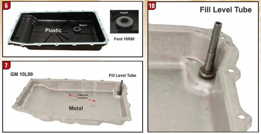

So I'll be taking my Ranger to my trusted shop to change the fluid and filter when it needs an oil change and plan on them changing the plastic pan out for one that has a drain plug. I am doing that so when my extended warranty is out, I can do it myself without the mess that Ford seems to think owners enjoy (my only other Ford loved to spill oil from the old filter onto the sub frame and steering linkages). My question is that except for the tuning and valve bodies, these 10r80's are mostly the same as GM's 10L90 as they both designed this transmission. GM has an aluminum pan with a drain plug for 1/3 the cost of the aftermarket ones I've seen. Anyone know if they are a direct fit? Any reason to spend more for the aftermarket? Saying to not have GM parts on a Ford truck isn't a worthy reason to me. Truck currently is just shy of 78k and shifts great. And no, the GM 10 speed doesn't have a dipstick in the engine bay either, I looked at parts list and in my family members engine bay at their 6.2/10 spd combo, in case anyone was wondering.

Sadly, not a direct fit. The 10R80 and 10L80 are cousins, not brother and sister. There's enough differences that not many if any at all parts interchange.
Aftermarket vendors would have jumped on that in a heartbeat if they could sell the pan to double the audience.

That is what I was wondering. I knew there had to be a reason that it wasn't recommended here. Any idea as to why they wanted to have different pan bolt up patterns?

Best pic I could find, one side of the GM one has a .. bit of a bulge to it (?? or whatever you call that shape). It's on the other side as well away from that tube thing. So I am sure they wouldn't line up. Not sure and doubt that pic is to scale so they may be closer in size than this one makes it seem, but not the same shape.

Seeing the pictures side by side, I can see the difference now. Shame. Still want a drain plug so I'll be picking up and after market and have time to decide if I want the extra capacity or not. I think they went backwards adding one to the rear diff but taking it away from the trans. At least the rear diff you could easy place a drain pan and control how fast the cover was coming off.
