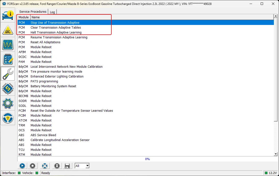

Over a year ago I ran these three items, (select the 'gear' icon in FORscan, picture below)
- Stop Use of Transmission Adaptive.
- Clear Transmission Adaptive Tables.
- Halt Transmission Adaptive Learning.
I like how it shifts now. A little firmer. I didn't know I was saving my trans.
I recommend this even if it didn't help the transmission.
Once halting adaptive learning, there should be no need to clear anything periodically.
My Ranger came with ASS disabled from the factory for a $50 credit. Huh, fiddybucks.
I would have that done even if it had a fee. It drives me nuts when I ride in a friend's car that has this. I get the stabile fluid pressure thing. Sounds logical.
Also defeated all sorts of chimes, which took a LOAD off wear and tear on my brain.
I cannot afford much more wear and tear there. :beer:
If you don't have FORscan, get it. Or find someone (you trust) near by that has it.
