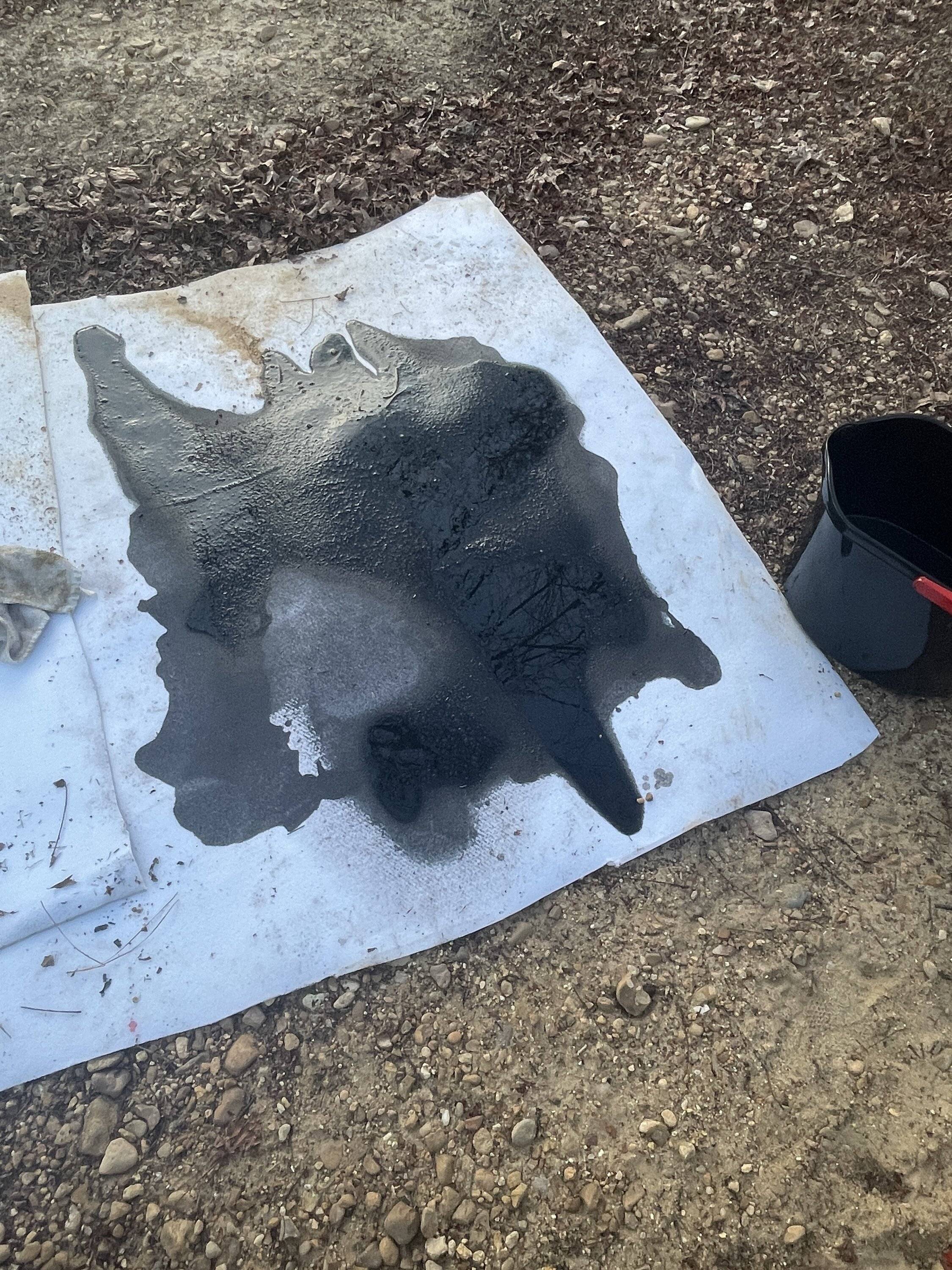

I would most definitely get a drain and fill on the transmission fluid . At 45k I started noticing the transmission would slip slightly when upshifting to 6th and 10th gears. It would also slip on downshifts in multiple gears at normal driving . There would be a slight rev in the rpm’s when the shift took place. So I decided to do a drain/fill/filter replacement. To my surprise the fluid was solid black and smelled burnt. I didn’t drive the truck hard and only tow a 12’ trailer and sxs maybe 20-30 times a year . After the fluid change I noticed an improvement but slipping still occurred . I loved the truck but made the decision to trade her in for a 4Runner recently . I just didn’t want to deal with getting the transmission replaced under warranty only to last another 40k and be out of warranty. My opinion is It should be stated in the manual to change the tranny fluid at 30k intervals. Not saying every truck will be this way but that was my experience. I attached a picture of the fluid that I poured onto a piece of white felt for reference .

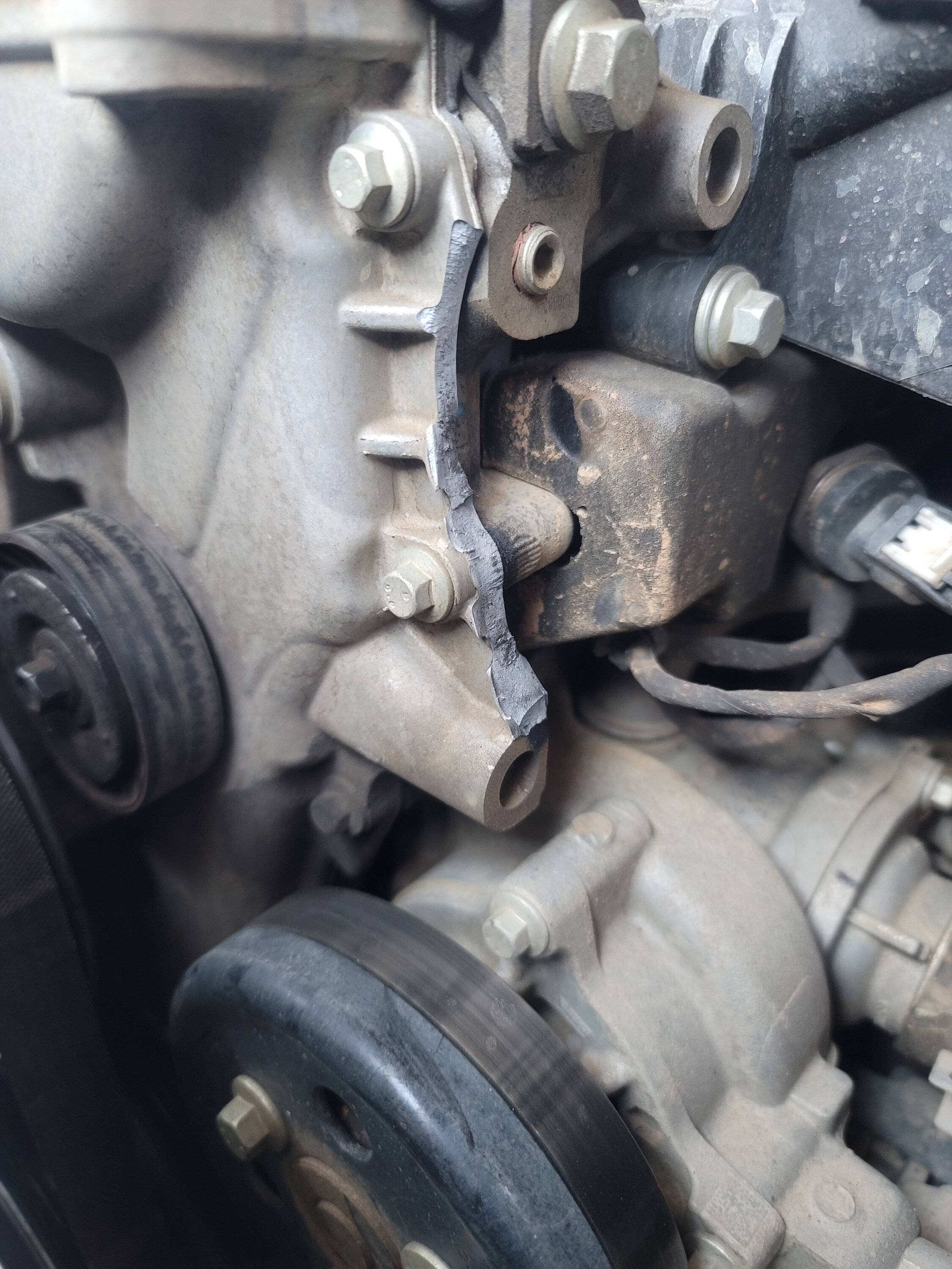

If your damage to the Timing Cover is this, then you have it backwards.
The Tensioner locks up or breaks off then the belt breaks or fly's off.
You are not the first.
Ref: This Thread
Belt Tensioner SNAPPED OFF | 2019+ Ford Ranger and Raptor Forum (5th Generation) - Ranger5G.com
The jury is still out on whether or not this is a Casting Issue (flawed) either way it should NOT break off, but the way it is designed - IT IS A WEAK POINT and the tension from the Belt Tensioner stresses this point until it just let's go.
Any Bearing drag in the Belt Tensioner will only add more stress to this point.
This is reason #3 for my purchase of the extended warranty. (Just In Case - I would need to use it)
#1 = Transmission Issues and #2 = HVAC Issues and #4 = Spark Plug Well (Water) Issues.
Thankfully I do not have any of the above (YET)
All of which are expensive and time-consuming fixes, even if I do it myself.
The question remains for those that have had this happen, Did the Tensioner make any abnormal noise that would have possibly been a warning that was ignored.
I know most would just think belt squeal or grumble noise, its ok, I will check it later.

That would explain the belt coming off. All Ford said is there was damage to Timing cover and no explanation. Thanks airline tech!
