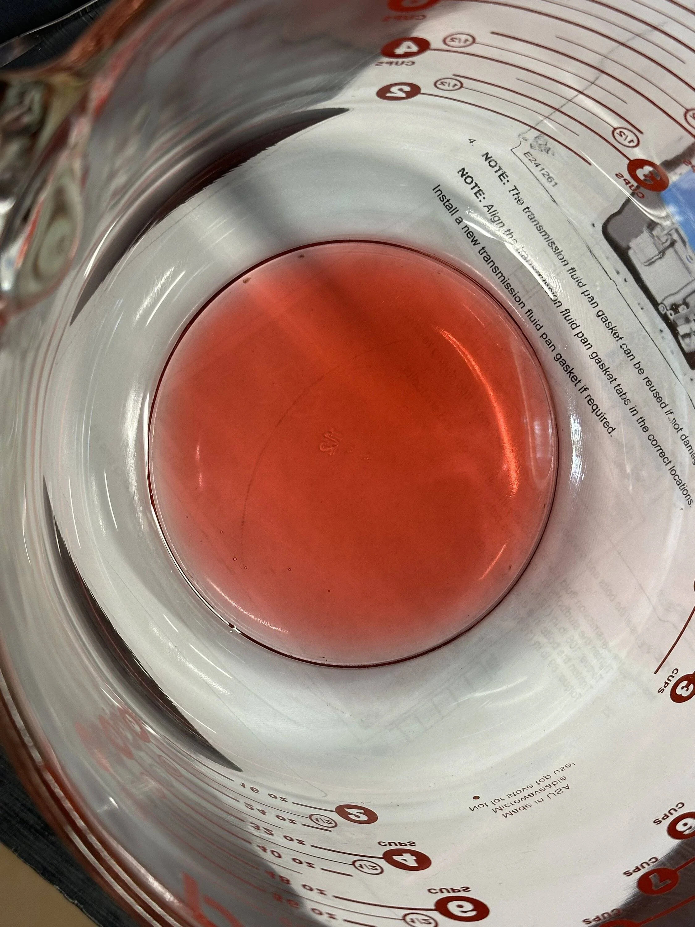

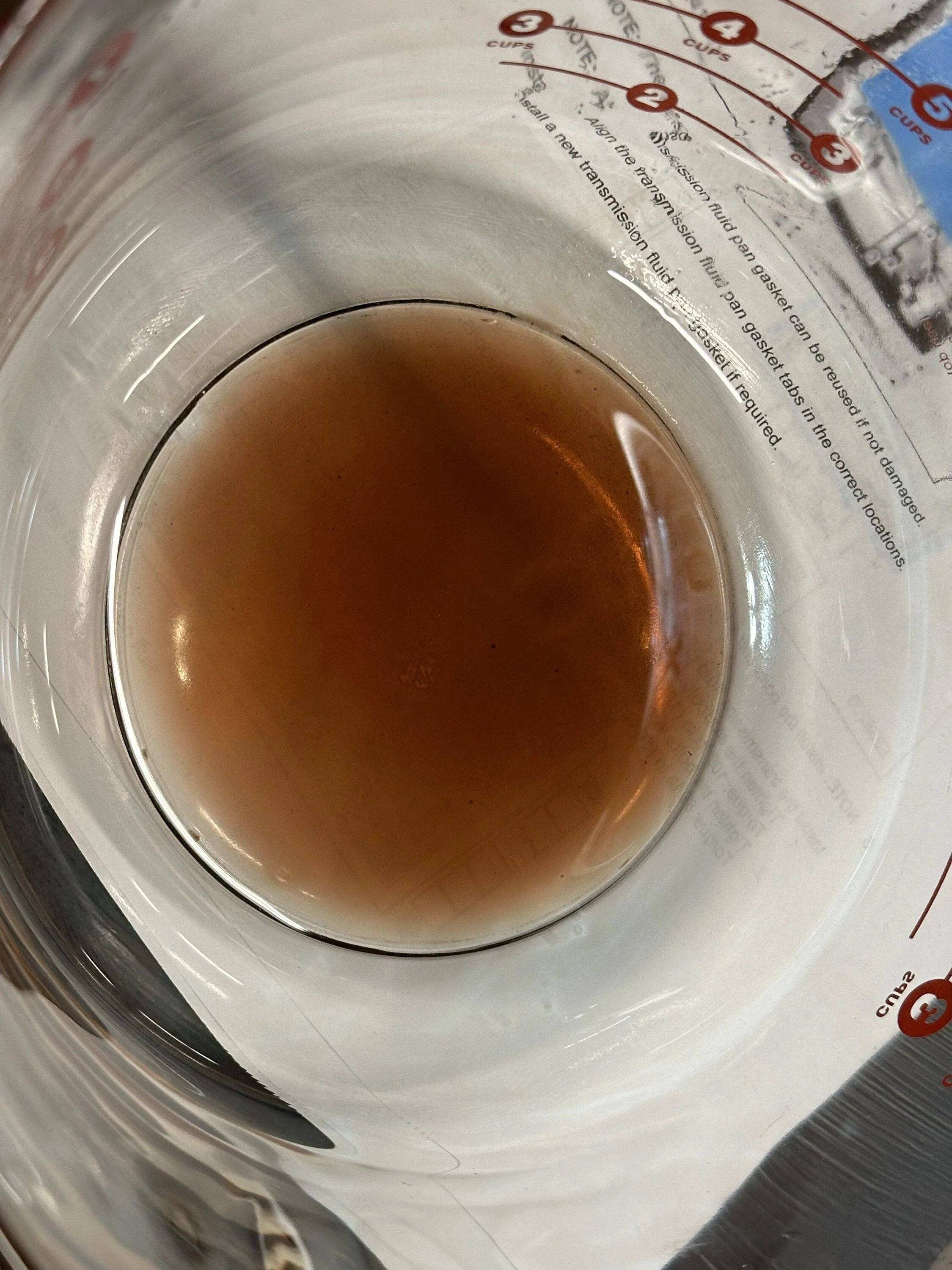

Cup of water I drank this morning
VS cup of Pee I vacated tonight
Its all relative until we see an actual chemical analysis of what's going on with it.
For all we know, the darkness is friction disk material. My wheels take on a dusty rusty appearance days after washing because the brake lining wears. Doesn't mean our brakes are toast.
I look forward to Stic-o posting his results. It will tip the scales one way or another for me.
Mine still looks like beer…

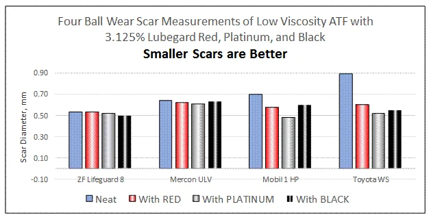

I'm doing it mostly because I feel that it will keep the valve body functioning correctly. Looking at the big picture:
Sonnax has developed several valves to deal with worn valve bodies
Ford has somewhat acknowledged a valve body issue
Lubegard has done some testing that indicates that the Platinum additive could potentially help with wear in Mercon ULV.
So, my conclusion is that the valve bodies could perhaps use a little help to keep the timings right. (Hence my early and often fluid changes to keep junk out of the filter/valve body)
From here:
https://www.lubegard.com/latest-news/viscosity-in-depth-review/
That's the thought process I followed to arrive at the decision to use it in my trans. I don't think it will help with the bushing issue, but who knows what actually causes that.
