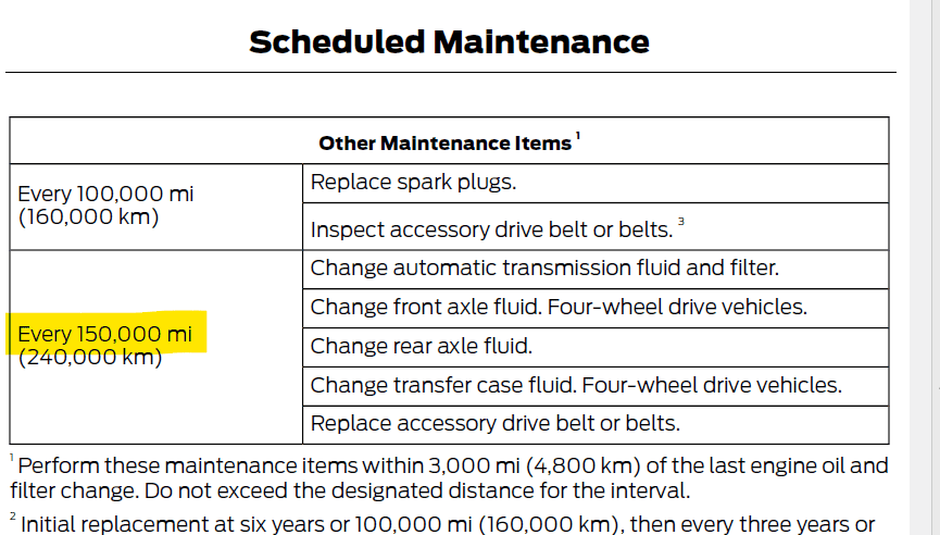

When's a good time to refresh the trans fluid on these things?
150k miles per the manual, same as all the other fluids (minus oil, brake and coolant). Coolant is at 100k miles.
I'm wondering if there may be a benefit to changing it earlier though. Let's say, what if I have a heavy right foot in stop light to stop light traffic? LOL
