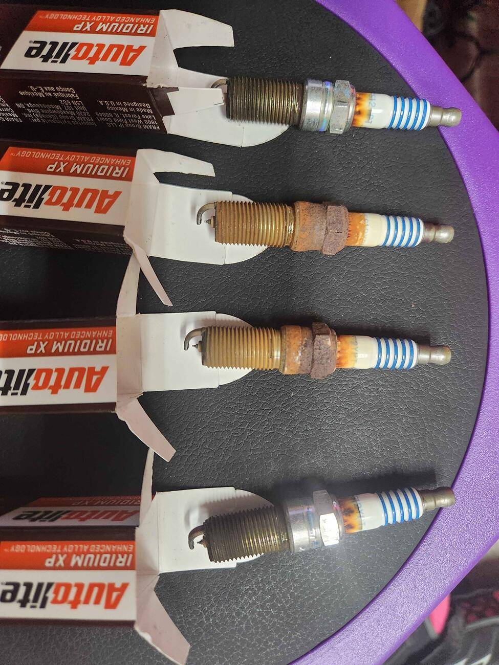

Thanks for the write-up! Now, I could just be an idiot here (very plausible) but I just wanted to state for posterity that the Coil Connector doesn't just "wiggle off" it's still a pinch tab even after sliding the lock off with your thumb. I was putting WAAAY too much force into removal earlier today trying to get my plugs out, thankfully a quick YouTube video gave me what I was looking for.
Aside from that one critique, excellent write-up, and thank you again!
P.S. You'd think that in Arizona my #2/#3 plugs wouldn't be rusted like an '87 Chevy at 60k miles but here we are!

Another member with Water in the wells - well documented on here, you got lucky they came out without issues or hassle.
They are known to corrode so badly they separate and leave the threaded base behind, some have had to replace the head but with some patience and an easyout they can be removed.

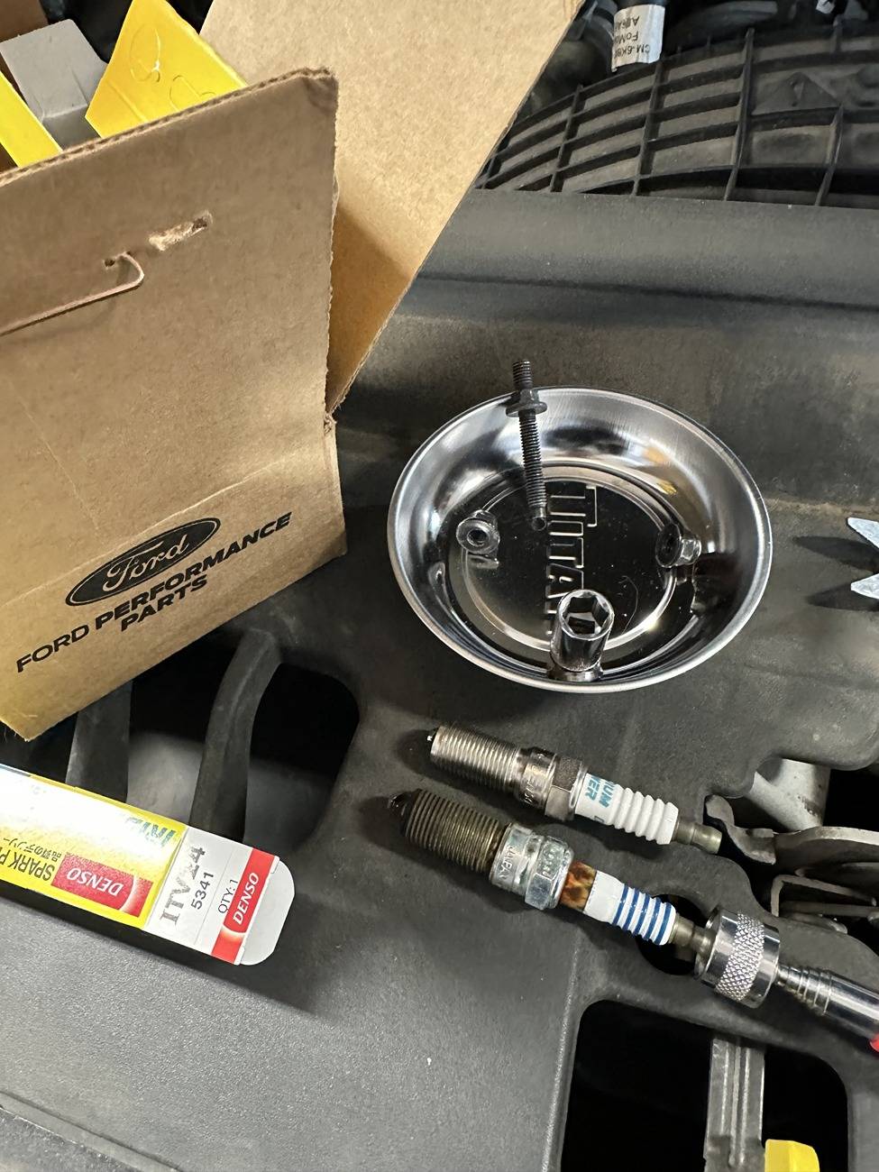

Did mine today. It was pretty easy but #4 definitely needs some patience to get the coil boot back on without wedging it into the open space around the plug and not actually line up with and sink onto the plug.
~73k miles, FP tune since ~21k miles, plugs did not look bad but they are worn. The new Ford Performance M-12405-20T (Denso ITV24) plugs have a "channel" in the electrode that the Motorcraft plugs did not.
https://www.levittownfordparts.com/...o&utm_medium=email&utm_campaign=map&y_b_lid=2
