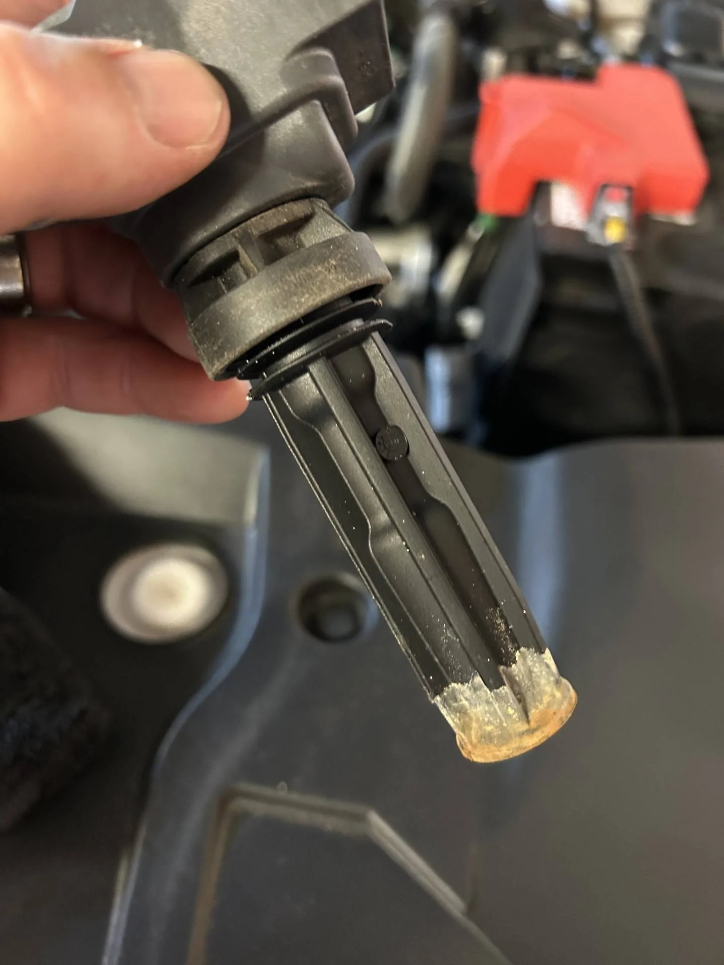

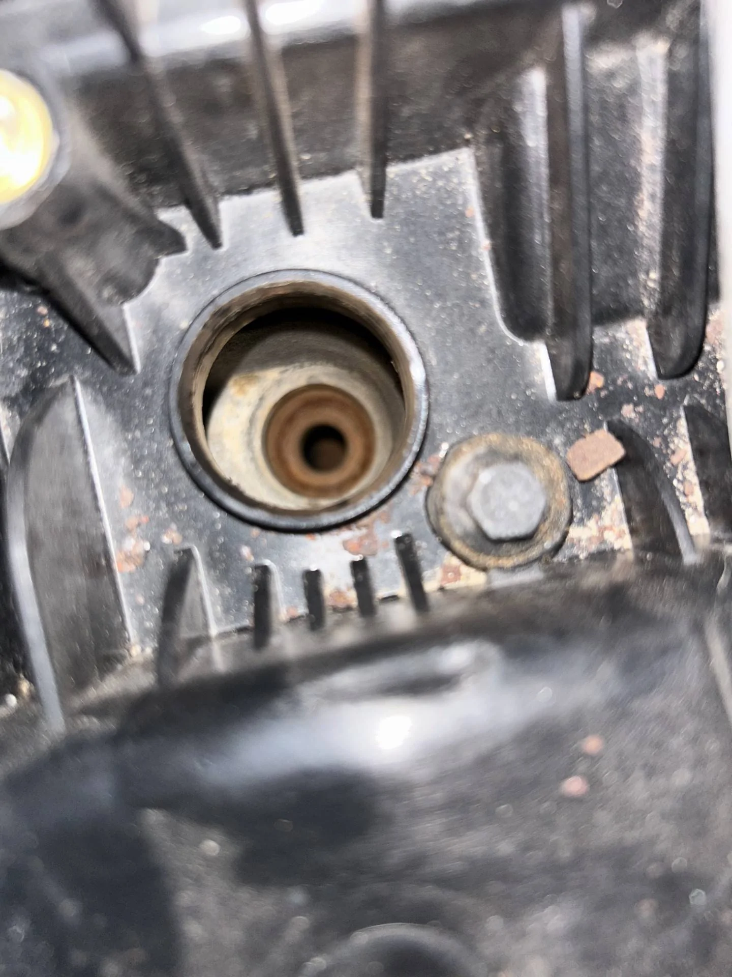

Hey everyone, I’m looking at replacing my spark plugs as I’m reaching 100k miles on my 2019 Ranger. I’d like to know how necessary do the boots need to be changed out? What am I looking for that would determine they should be replaced? Any help or info is greatly appreciated!
I changed mine at 36k. Mine's a 2020 without the engine cover. Lots of rust considering I don't drive through a whole lot of rain (DFW , Texas) or go mudding. It is parked outside and I run it through a carwash a couple times per month.

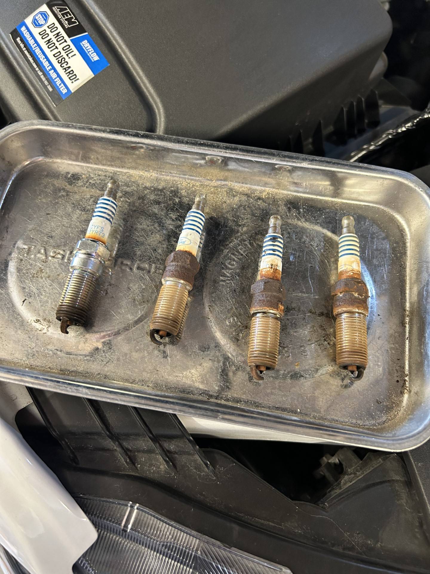

Interesting carbon difference on that left hand plug.

In that pic. left to right is rear cylinder to front, it seems like more water gets in closer to the front of the engine.
Do you have a close up comparing the porcelain on the spark plugs? That left one doesn't look good from the angle in the picture.
If you are talking about the orange discoloration. That is a Corona coloring and is normal. That is actually quite mild compared to some I've seen. It is actually on all of them you just can't see it because of the rust.
Glad he got them all out without issue.
Sorry, I should have been more specific. I meant the porcelain around the electrode and near ground strap on the combustion chamber end.
