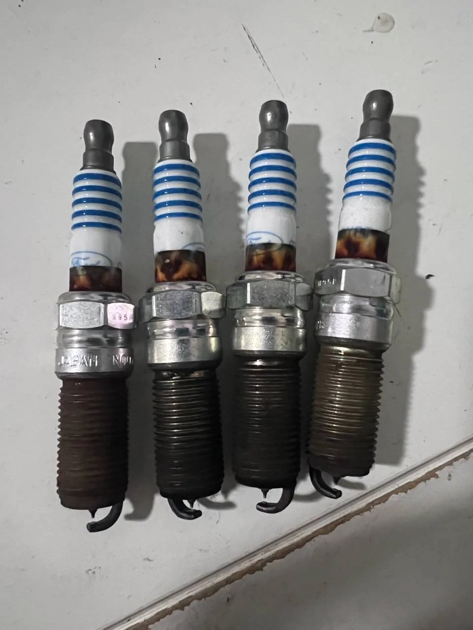

Sorry for the late follow up but ended up getting time to change the plugs out today, didn’t feel the need to replace the coils yet but will be doing soon.
These are the plugs at 114k, all came out pretty easy other then the far left which I believe was the 3rd one.

wow, that is some heavy residue on the plugs. Most of the ends look in ok shape considering. What fuel did your run the majority of the time? It will be interesting to note later for myself.
Only regular
