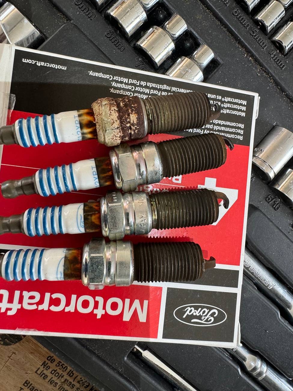

I waited till the suggested maintenance point and changed out the plugs at 105K miles. I asked for some anti-seize for the threads at the parts house when I bought the plugs. I trusted the counter help, won't do that again as they gave me boot protector grease. With the plugs out, too late to to back and get it. I hope this won't be a problem with the Motorcraft recommended plugs. At 105,000 miles, this is what I took out. I think it was time. Maybe I will do it sooner next time.

My guess is that the plug at the top is from cylinder #4. Looks like you got to this just in time.
Yep, #4 had the rust on it. I hope since I got 100k+ miles out of it I won't have much problem.

Man...that top one!
How hard was it to get that #4 out. Many 5G Ranger experience water getting in the #4 plug well.
It was not hard at all. Just a bit stuck, but nothing terrible. The worst part was trying to fish the rubber boot off the spark plug #2 after it came out of the spark plug socket. Thankfully my granddad left me his long needle nose pliers. Then some super glue held the rubber boot in for me to finish. If it had come off on #3 or #4, I don't think I would have ever gotten it out.
Since I did not have any anti-seize grease I may just wait for another 100k miles or sell it before I hit that point. ?
The good news is these OEM Motorcraft plugs are made by NGK. They plate the threads with tri-chrome (you can see the sheen in my image) so there is no reason to use anti-seize!
I only used dielectric grease inside the coil boot to assist with removal in the future.

Once everything is reattached and properly tightened, crank your Ranger to see if a check engine light or any error message appears. You can always take a drive around the neighborhood as well prior to engine cover reattachment.
My Ranger roared to life and it seemed like it appreciated new plugs and the new engine air element I installed last weekend.
Reattach the EcoBoost Engine Cover if equipped by pushing down and reinstalling the 2x 10mm lock nuts. These just need to be hand tight.
That's it! Grab a cold one and enjoy a job well done! :sunglasses::thumbsup::beer:
The local dealer quoted me $130 just for installation (parts extra) so that is worth celebrating.
For the record it took me longer to write this write-up / take pictures than the actual job did. :LOL::beer:
