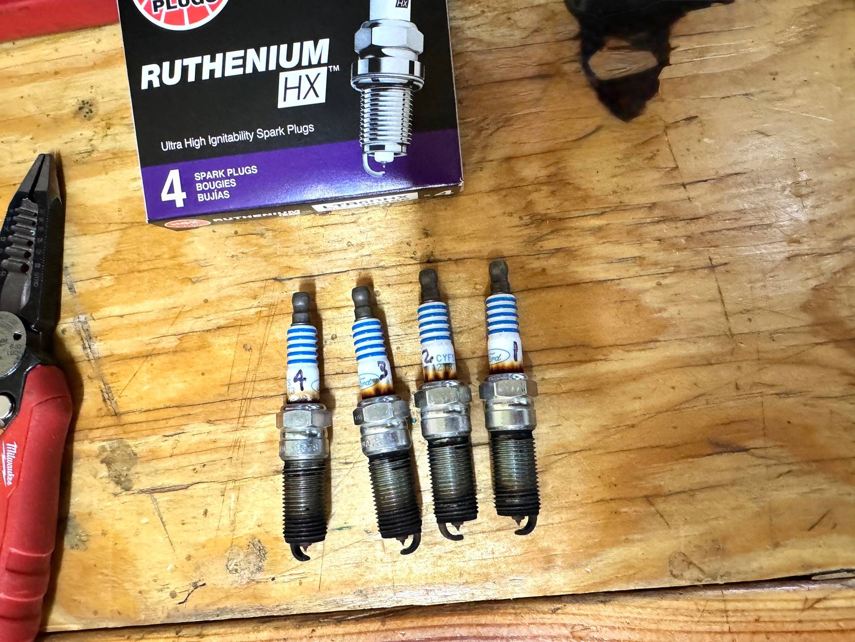

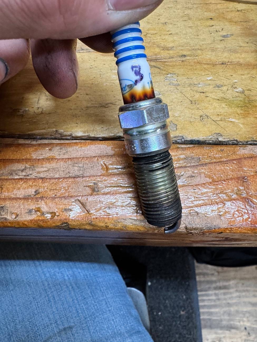

Remove 4x Spark Plugs using a 6" or 8" extension with a 5/8 Spark Plug Socket. Mine were fairly easy to break loose and did squeak a little bit while loosening.
My plugs were in decent shape, but I am probably going to make my change interval 5 Years/60,000 miles. The staining on the porcelain is not rust, it is corona staining and is a completely normal byproduct per NGK.

Check gap and Reinstall your 4x new Motorcraft SP-594 Spark Plugs. All 4 of mine were at a 0.029 inch (0.74 mm) gap out of the box so I did not adjust it. I measured the factory plugs I removed and they were between 0.028 and 0.029 inches.
Simply hand thread each plug until it's snug to prevent from cross threading. I was actually able to get it fairly close to the proper torque value by simply hand threading. If you have a knurled extension it makes it easier.
