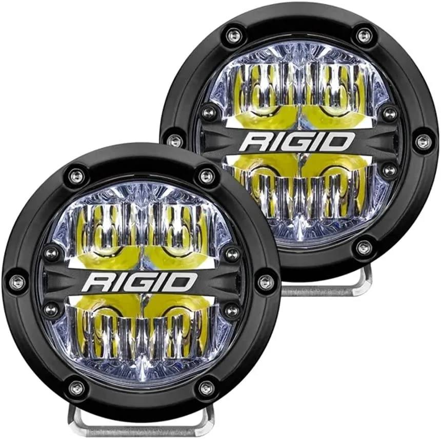

does anyone make a ditch light that's more aerodynamic that a Rubik's Cube?
is there a reason why they are always mounted where they are?
Rigid makes one that's rounded and personally I think they look a lot better than the square lights.
They're usually mounted on there so you can see off/out further when off roading at night. You want to ge the light up over your hood without reflecting off the hood back at you.
https://www.amazon.com/dp/B07YZQVFV...olid=1JZJN0W5WUIWA&psc=1&ref_=lv_ov_lig_dp_it
