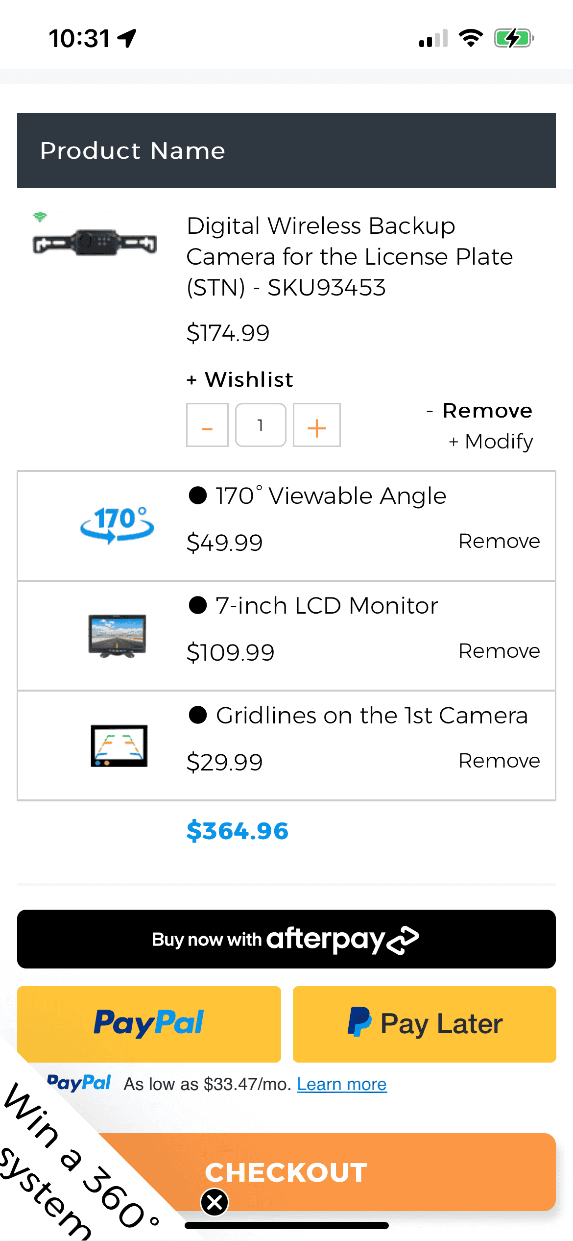

I use one of the switches to power my license plate bracket mounted front camera when riding trails. It’s wireless and I use my rv backup camera monitor to view it.

Ok....give me details on that mod. After doing Moab in my Cherokee Trailhawk in March, adding a front trail cam is on my list of wants. Do you have a thread or recommended web site for that?

I already had the TadiBrothers 90114F setup for our travel trailer. Display allows up to 4 wireless cameras. I just added a wireless forward facing license plate camera and a front license plate bracket ( not required in Michigan). Monitor mounts to windshield using their suction cup mount. They offer a ton of different setups. Best to browse their site or call them with your specific wants and have them spec a setup.

I went on their website and configured a single camera setup that matched what I’m using. Didn’t add the suction cup mount though.

Yup, I was playing with thier site. We will be buying a travel trailer when we sell our motorhome so may wait until then to get a system. Thanks for the advice.
