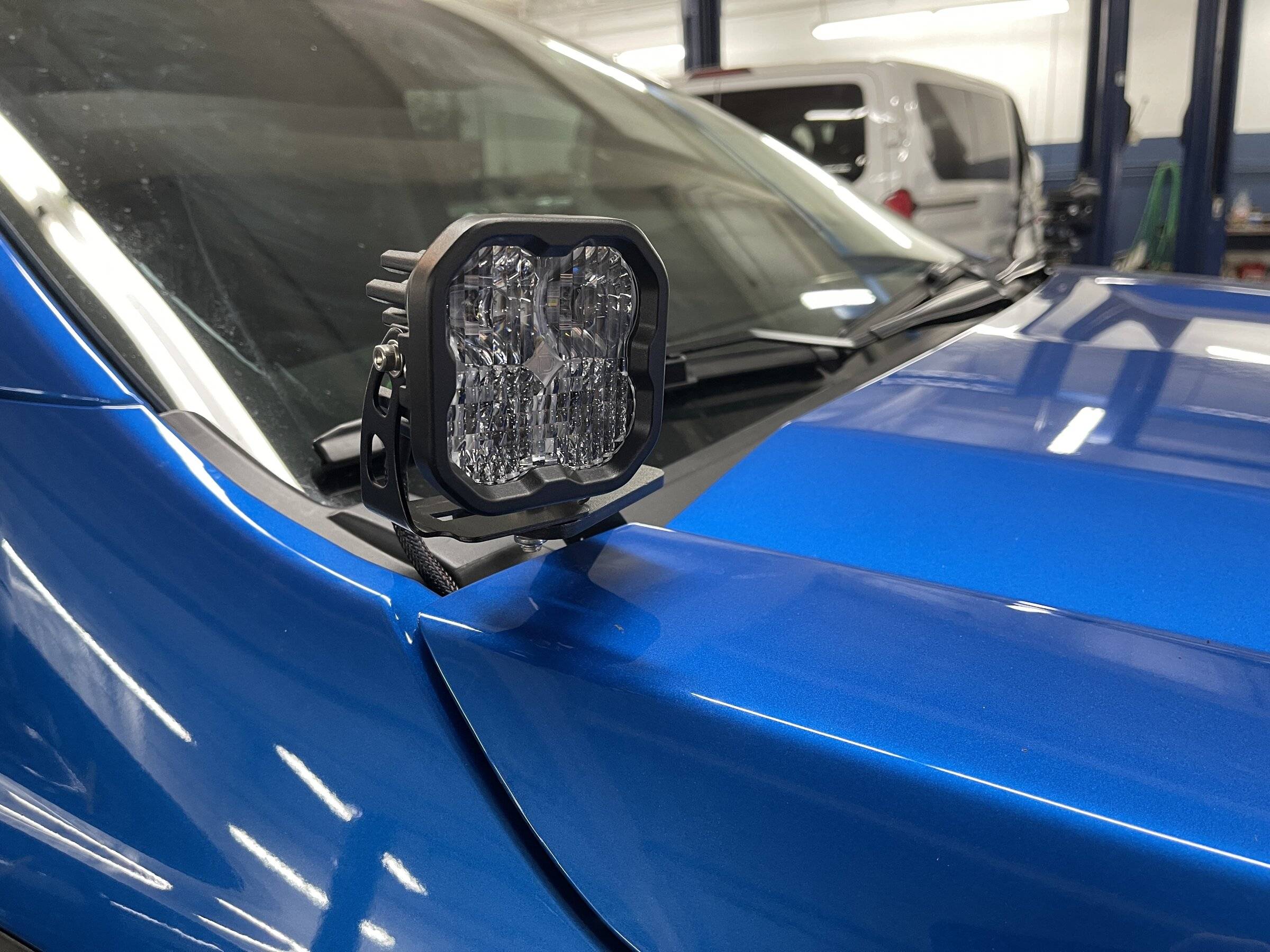

noob question... can you tie both LED Pods Hot wires together and into one end of the butt connector and the pre rigged hot from the fuse box into the other end?
So one switch wire to 2 lights essentially?
Yes
Yes. At the end of the day how many items you tie to one connection is simply a limit of your wire gauge and relay and/or switch capacity.

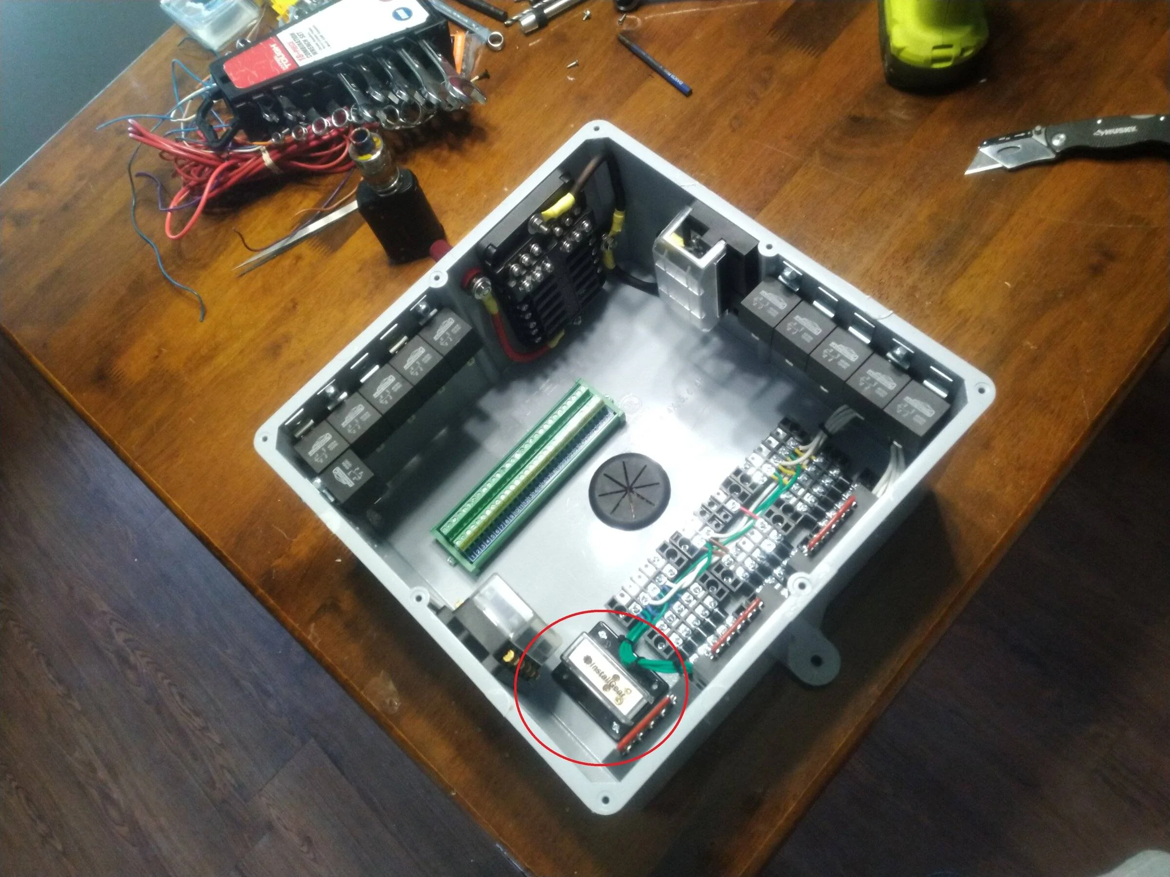

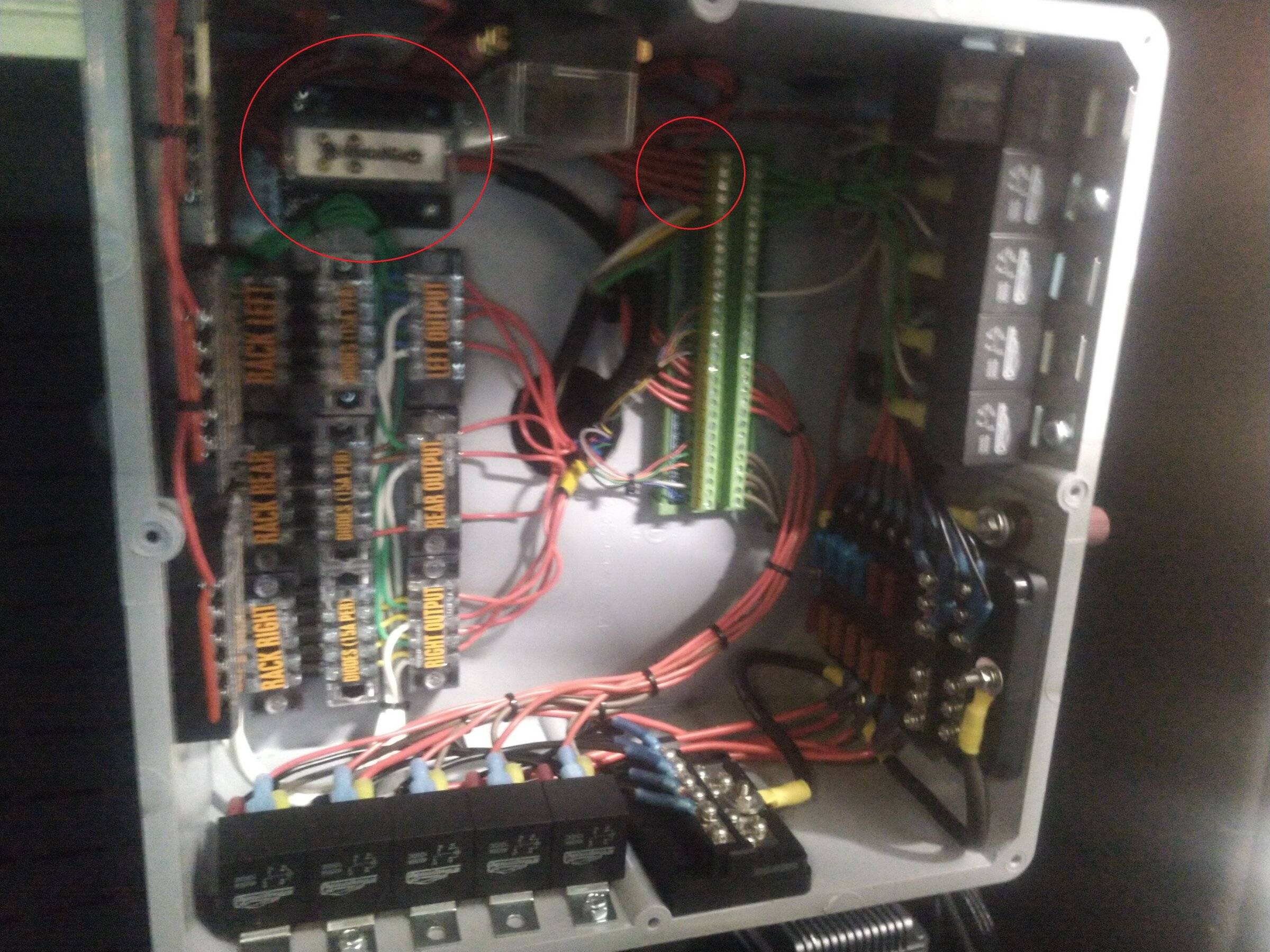

My top rack forward lights (7 total connections) converge into a junction box on my roof and then that junction merges those 7 connections down to a single 8 gauge wire. Then that wire terminates at another junction box at the rear of my truck and converts to four 12 gauge connections which then feed into 4 relays to disperse power distribution, which are then single trigger wired together to my switch panel.
Similarly my forward bumper lights (4 total connections) more or less do the same thing among 2 relays.
Now obviously my setup is a bit more on the upscale size, in the case of 2 ditch lights you would just (PROPERLY) splice 2 connections down to 1 and then that 1 connection should go to 1 relay.

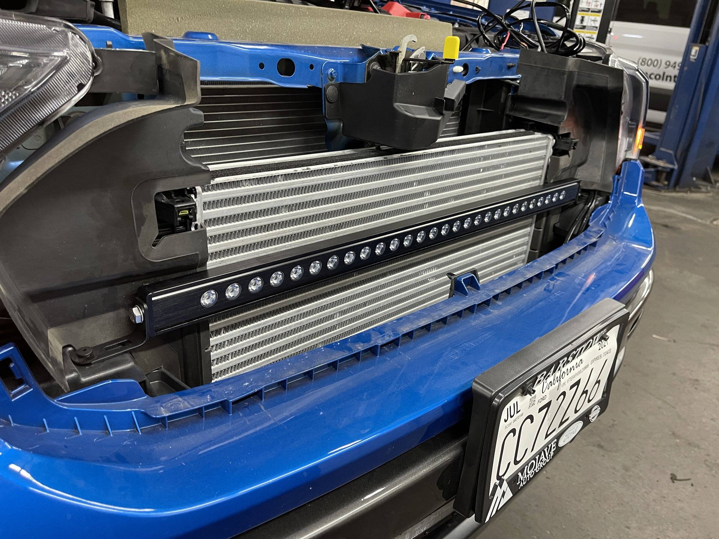

just curious, when you were deciding on which upfitter switch to use, did you do the calculation on amp draw? That’s what I did with my dual 6 inch little light bars that go in the bumper where they should already include them. Total draw calculated to 5 A, so I used auxiliary switched number six, which was 5 A. It worked perfect and kept the 25 amp switches and all of the ones capable of larger power draws available.
If you plan on adding more, I think it’s not a bad idea. Plus it’s so to just switch it over… I love how they are just blunt cut wires hanging down and you just pick which one you want and Connect!
Then ground everything and you’re done!
I couldn’t believe that it was as easy as cutting off the relay and for sure the little switch that came with the product… Did not want to have a relay upon a relay and a fuse up upon a fuse. Just wouldn’t have made sense.
Oh and I saw the pictures of the lights and they look great great job on everything

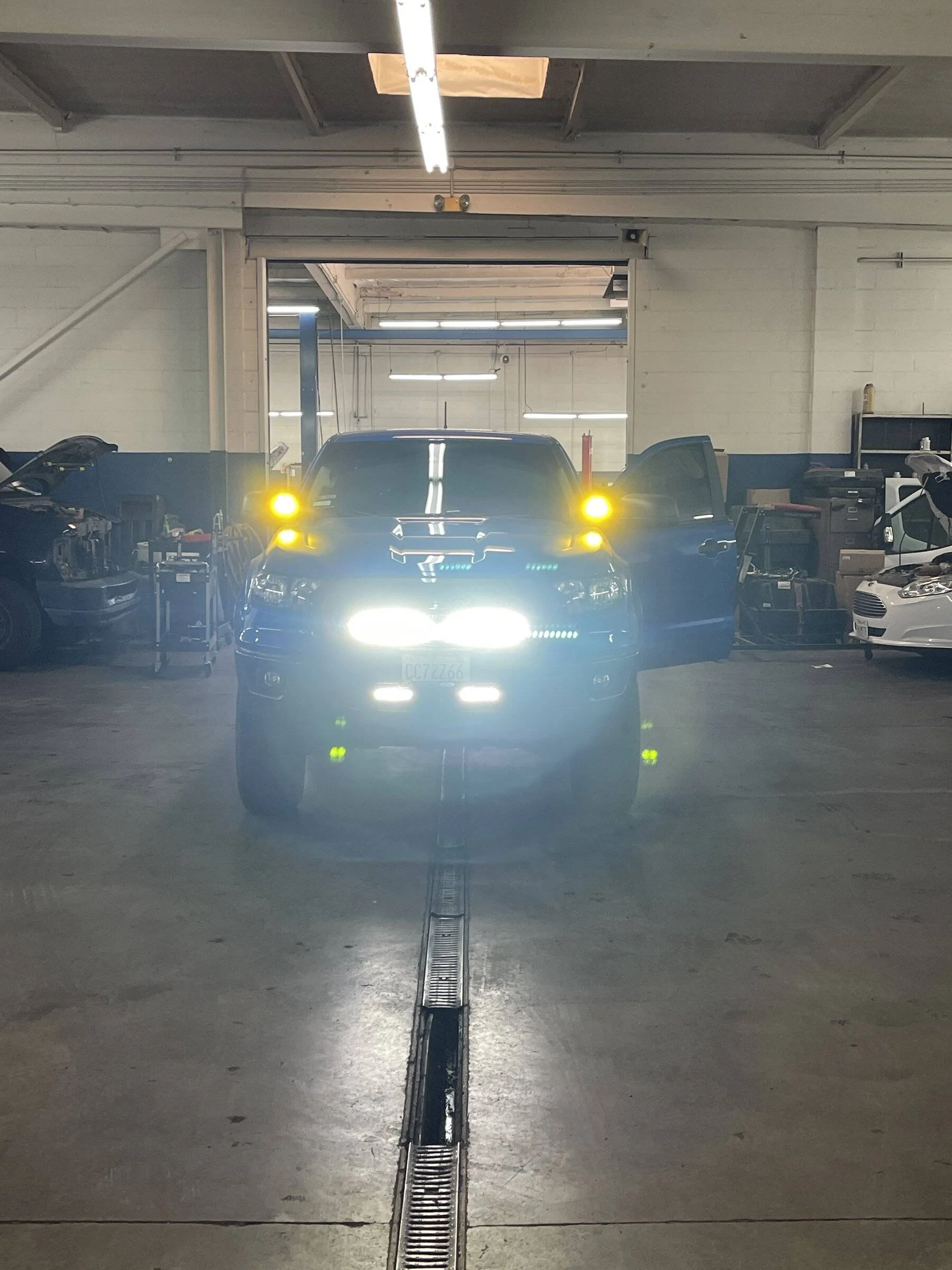

Looks great! I did ditch lights myself, also to ss6 bars in the bumper and one behind the grille. I used aux 1-3
oh I figured I’d ask the same question to you… Did you decide on the switches based on amps for the particular fuse?
I would’ve liked to just start with number one personally, but my set up only needed 5 A, so number six kept all of the higher power options free.
I didn’t look into whether I could just swap them around… I didn’t know for sure if the actual wires were size accordingly or relays somehow…
Now the question is where the hell do I find a really nice looking tiny sticker that fits on each switch indicating what it’s for?!
I can’t believe it wasn’t as easy as typing it in. Seems like they have them for F2 50s and maybe F150… Basically the ones mounted on the headliner console.
I just don’t think they’re the same shape. Although it probably would still work
