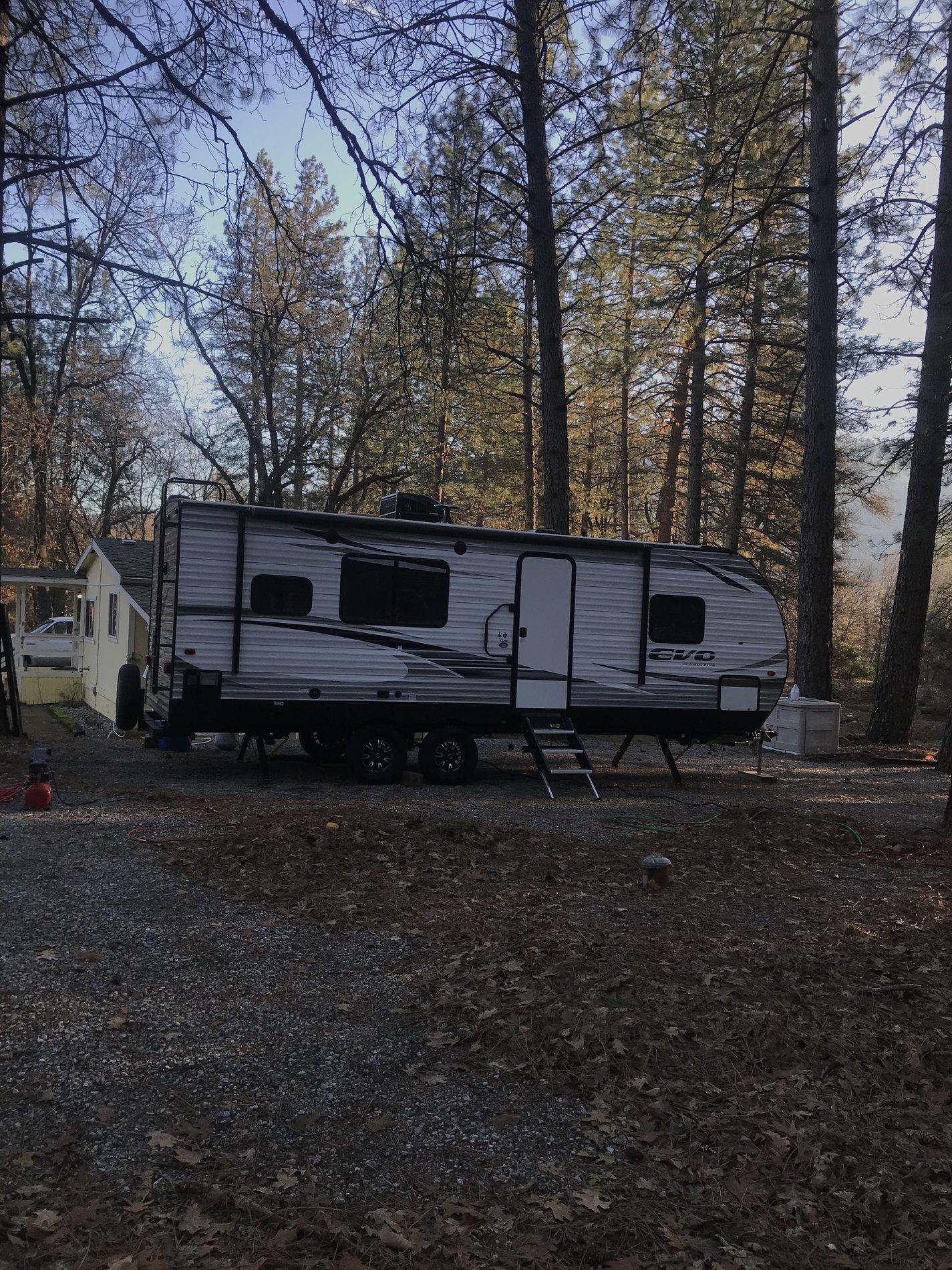

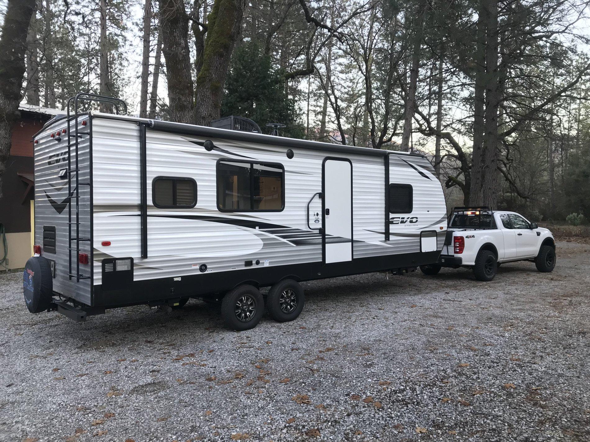

So a few recommendations from someone that is towing too big of a trailer.. definitely don’t go over 22’ and stay under 5000 lbs dry. Our trailer is 5800 dry and 7550 gvwr. 23’ Completely stock it towed the trailer “ok” with weight distribution bars and cooper 10 ply tires it helped a ton. Although towing still isn’t enjoyable. It’s just too big of a trailer for the truck. We’re temporarily living in this Forest River Evo so we don’t regret getting it but I think we will end up downsizing once we get a house and want a trailer for camping and traveling.

We have since sold the trailer. It will be ok but you will have to be on top of it when trucks pass. It’s a bit white knuckle lol I have my CDL so I have lots of experience towing, it’s just too small of a truck and that size trailer hooked up to it is like a kite. I personally wouldn’t tow that trailer unless you had too. Next trailer we get will be around 18’ or so
