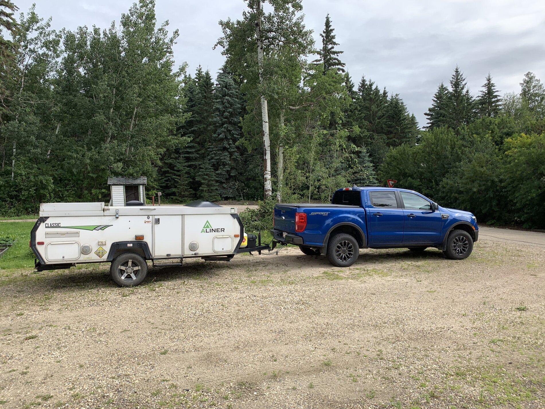

I’ll vouch for the Aliner. I took mine for its first trip last weekend and it was a dream to tow. Not quite the same league as a lot of the trailers on here, only around 3000 pounds loaded. Still plenty of power, and my mileage was better than the 2015 Pathfinder I replaced, averaged around 21 mpg in rolling hills heading into the Rockies. Where the Pathfinder struggled, my Ranger barely blinked.

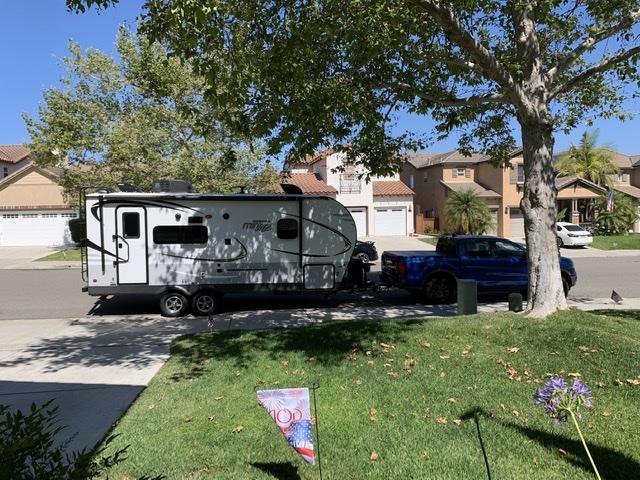

I pull a Forest River R-Pod 191 with my Ranger, A little smaller than what your looking at but not much. I Have a Husky Centerline TS hitch with sway control and the lightest bars (400-600# tw). I have the Redarc controller not the Ford version. I needed to put in a controller before Ford finally released theirs. I know some people say the Ranger "pulls it like it's not even there". Close, Plenty of power, but you do know 5000# is there. That being said I have had no issues with the trailer being squirrely, feels solid and comfortable on the highway.
I think the size and weight limits you are setting for yourself are very reasonable. Just get a good WDH ( lot of options and opinions there) and have it setup correctly and you should have no problems. I like my Redarc TBC, but which I could get a kit to retrofit the module to get the AEB working. Don't have Adaptive Cruise, but you shouldn't use that while towing anyway.
Heres a picture of my rig:
