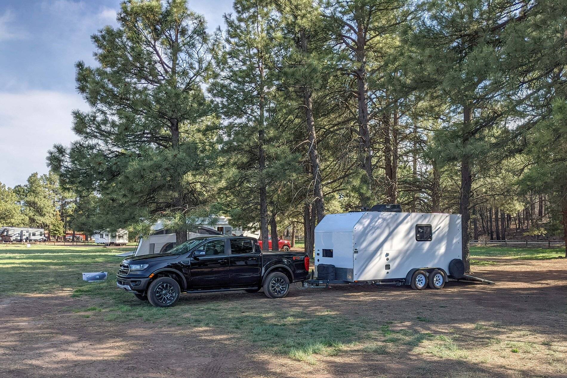

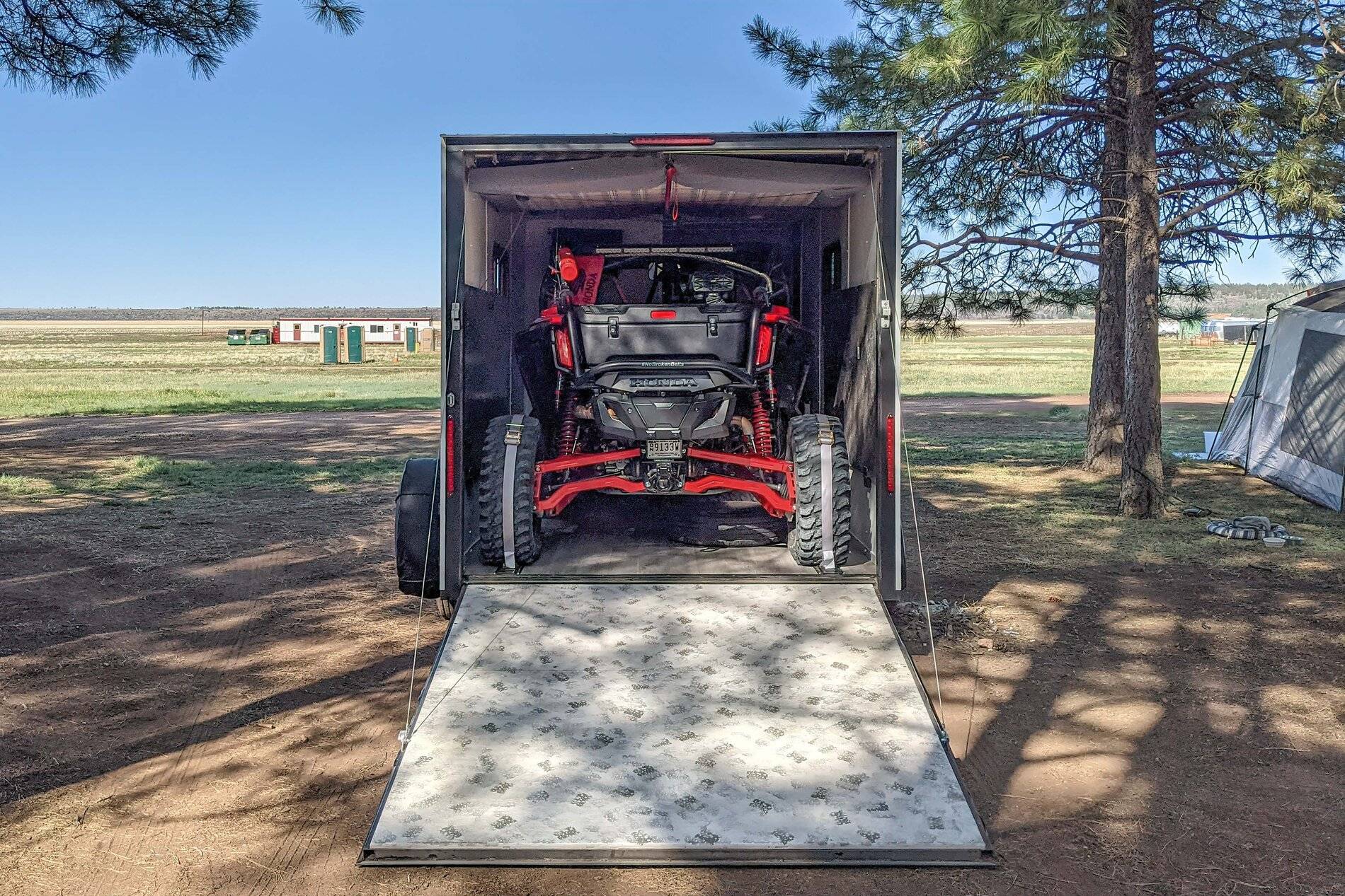

I'm towing a fully equipped 16 ft. cargo trailer toy hauler conversion. Approaching 6k lbs. fully loaded with water and sxs. I have an Andersen anti-sway weight distribution hitch that allows backing while connected. The Ranger's towing capability has impressed me with this. It doesn't stress out and does the job well.
