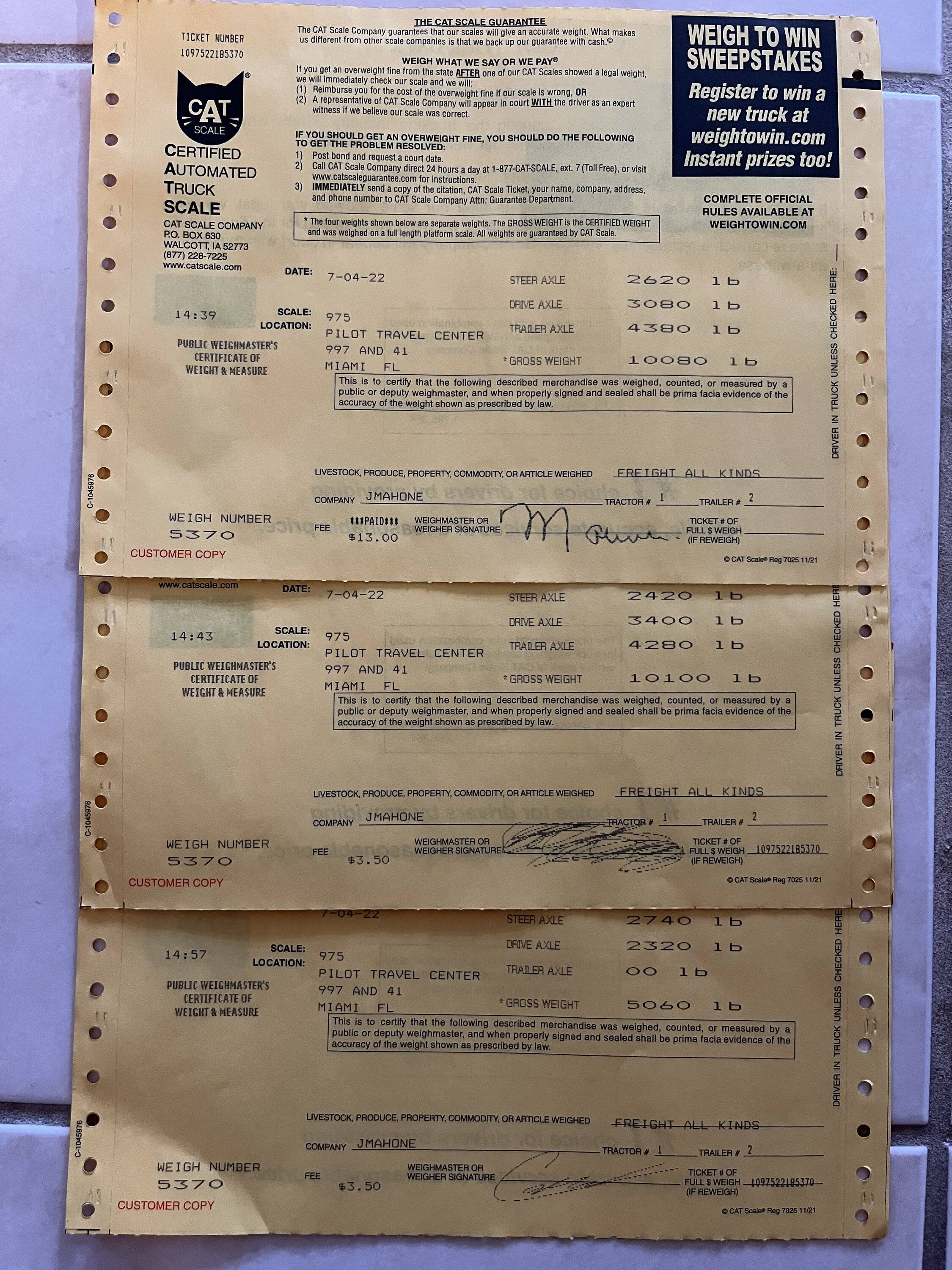

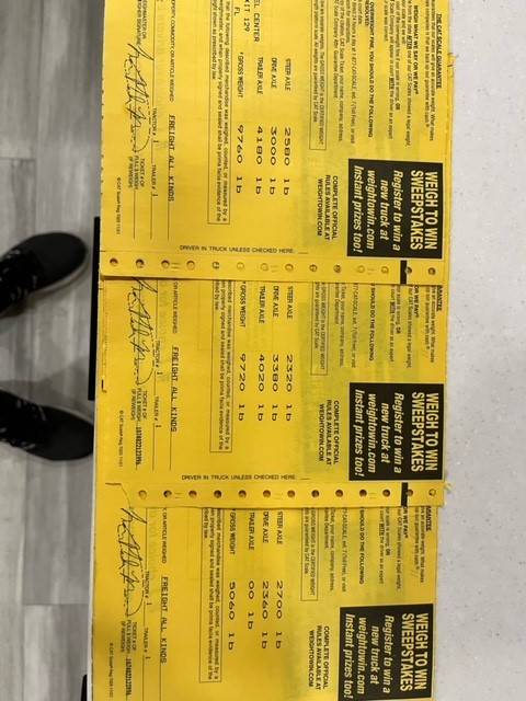

Here you go... Rockwood Mini Lite 2109s: 23' hitch to bumper, 8' wide, 10.5' high. Dry weight 4,493, CCW 1,344, Hitch 557.
SEE POST THAT FOLLOWS THIS POST.
These are actual Cat tickets for our last weekend of camping. Myself and my best half, a heavy toolbox and about 1/2 tank of fuel in the truck. Equalizer 10K 4point WDH. Bars were in the truck bed when not connected. Camper was loaded with clothing, food /drinks for a 3 day weekend, 10 gallons of fresh water, 0 gallons in gray & black tanks, two full 30# propane tanks, two 100Ah Li batteries in the pass thru along with other necessities.
Weigh tickets are, L to R: w/ WDH, w/o WDH, truck only (Ranger 4x4 Lariat with the two of us in the truck).
You can plug the numbers into this linked calculator which is what I use. I was 10# over on the receiver per the tickets.

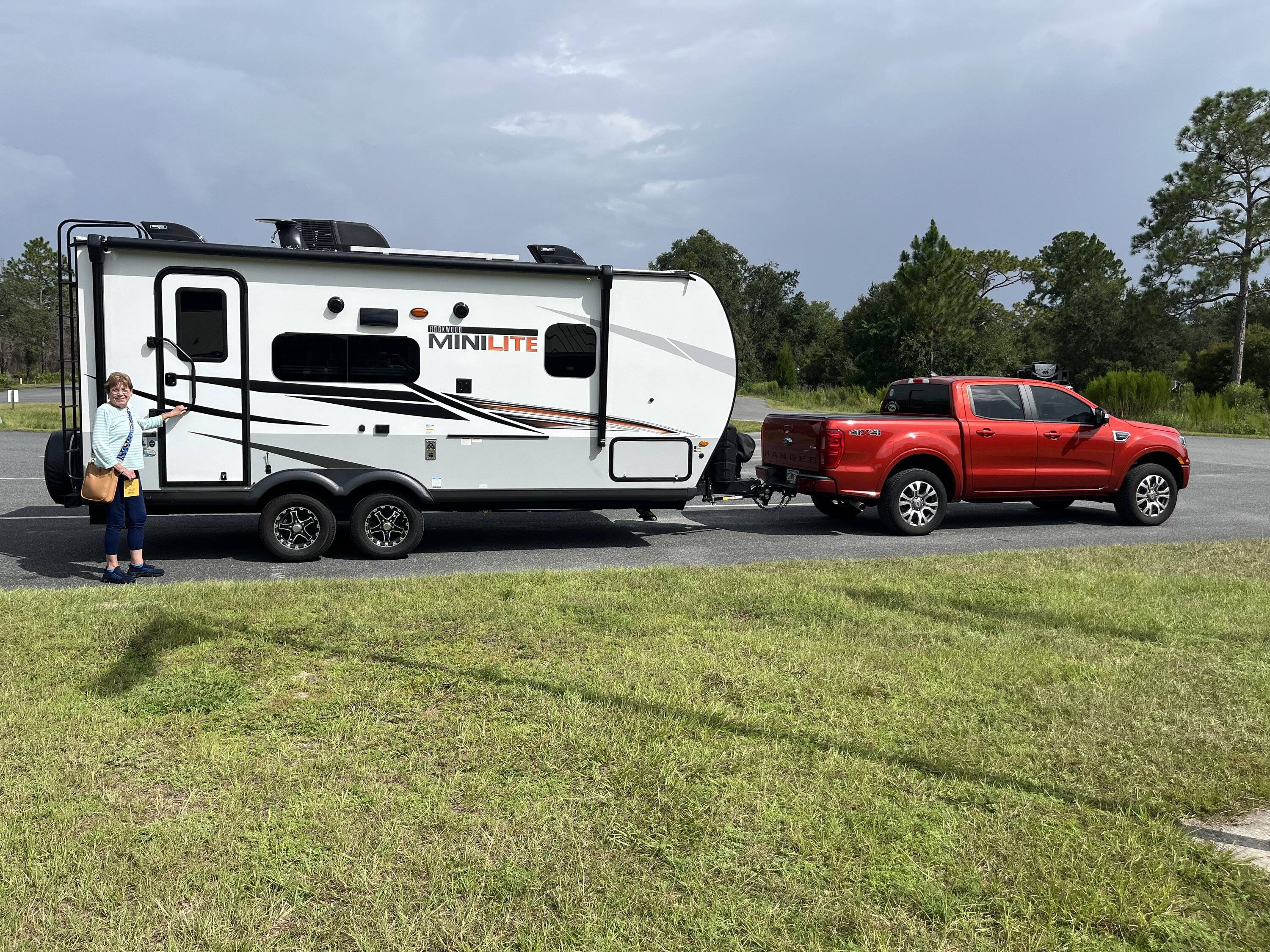

Here are the CAT scale weigh tickets on that last camping trip, along with a picture of the rig with WDH engaged.
