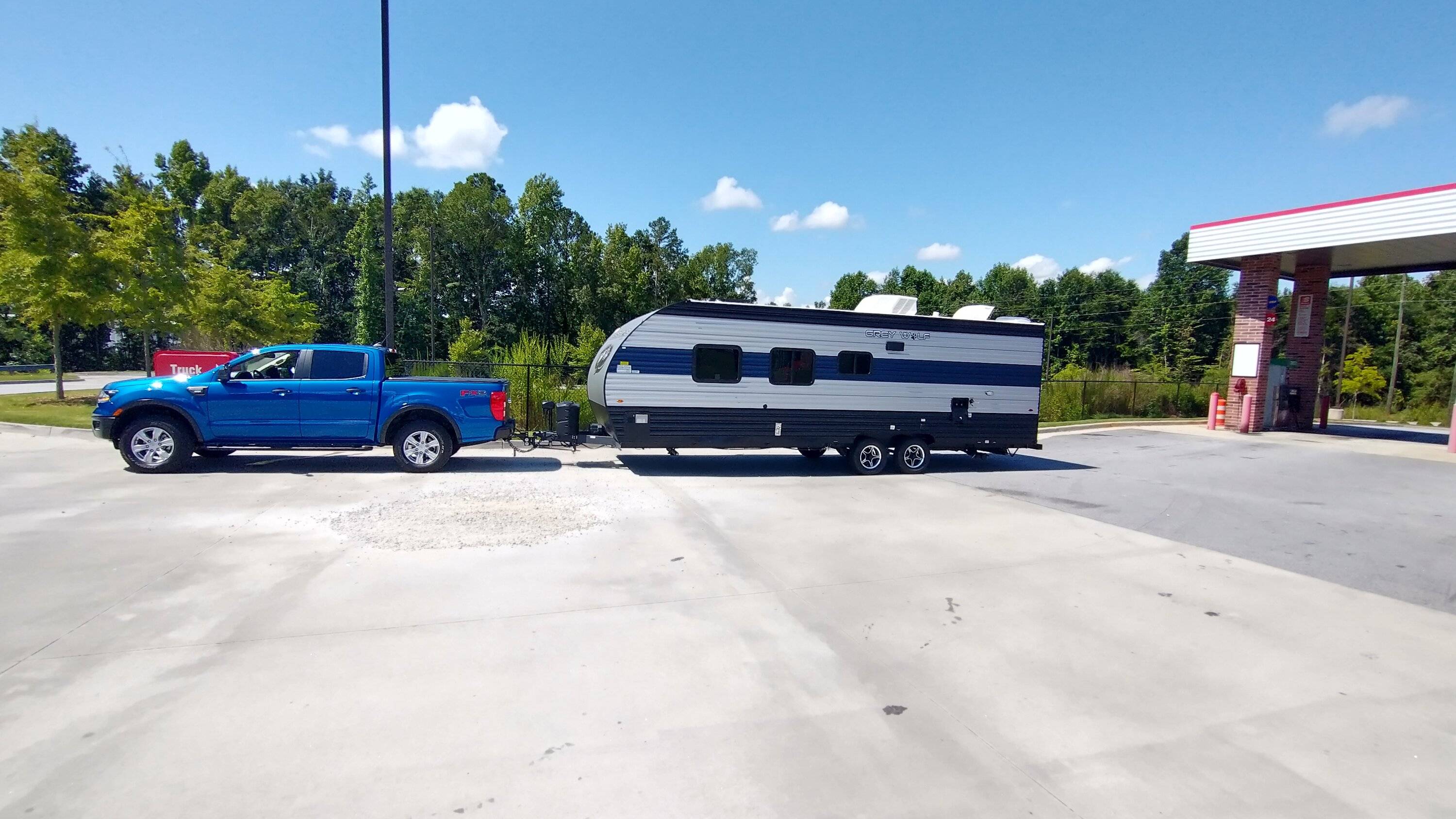

My 26DJSE is the absolute biggest I would consider. Similar in size to Grumpa's, just a hair lighter. 11mpg is about what I get, although that's mostly highway, smaller roads would be slightly better. There's also a member here with a similar Jayco. I tow with an E2 WDH and Bilstein rear shocks. 40psi in the truck tires all the way around. You do feel the trailer back there, and I wouldn't tow in a windstorm, but other than that, it's fine.
I'm waiting on my drop shank to show up. The stock unit they ship with the E2 isn't enough to get the trailer properly leveled. It was supposed to be here before this weekend's trip, but Amazon lost the stupid thing, so it will have to wait until the next trip.
For reference, here is our rig with the shank set to the lowest stock setting. The rear end of the Ranger is tall, there's no doubt about it.
My Ranger is also a light spec 2WD with a 1711# payload, so weight isn't really an issue with just 2 of us in the truck and everything else in the trailer. Lariats/4WD and higher-spec trucks could run into payload issues if you're loading them up to the gills.

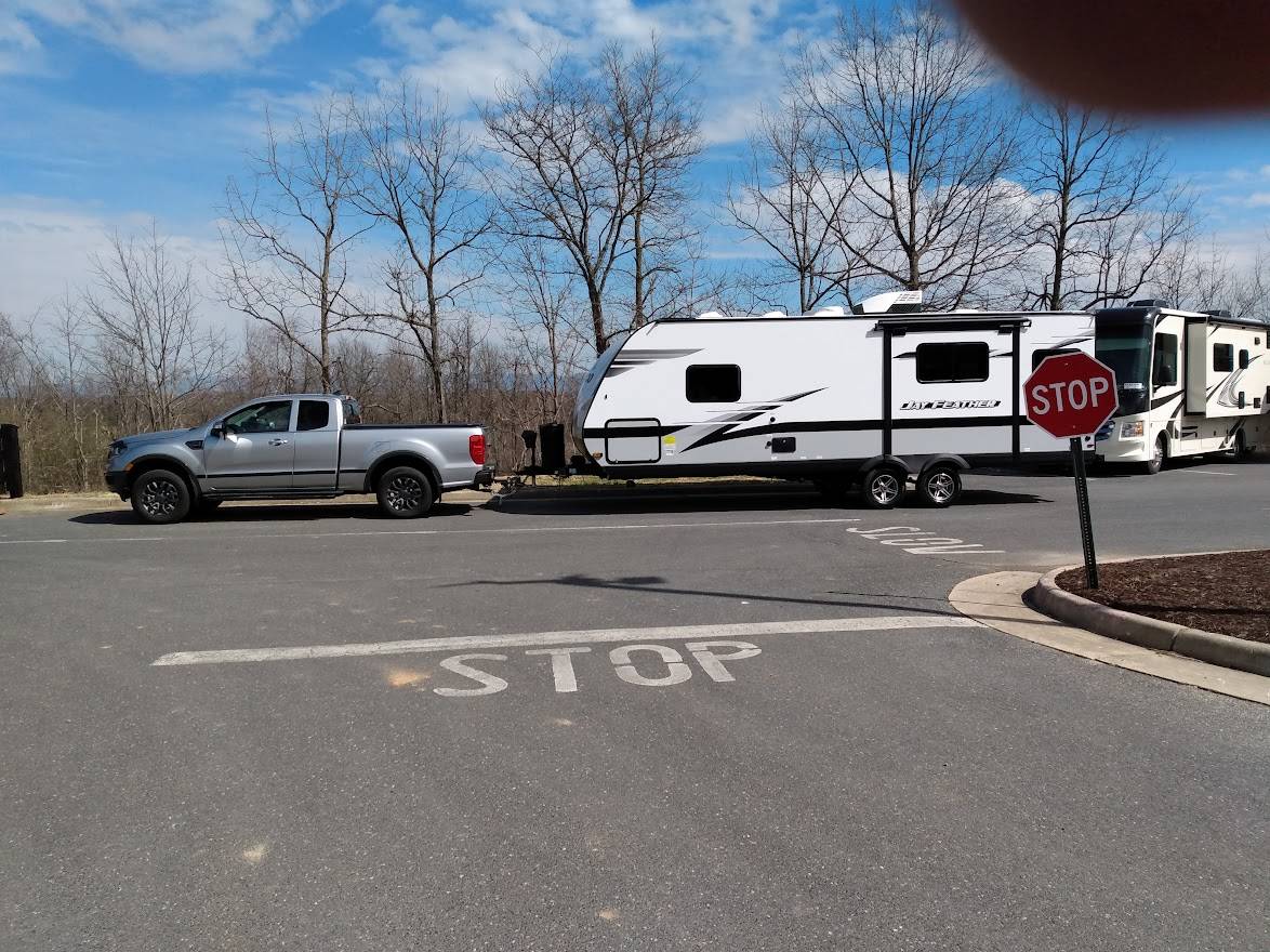

Jayco 24RL. 29 foor total with a 24 foot box.Trailer weight is around 6500 lbs witha 690 tongue weight.
2 wd Ranger Lariat, Eibach rear shocks, Roadmaster Active Suspension on rear.
36 psi front, 40 psi rear. Set of ClearView mirrors installed. Blue Ox hitch system.
Tows fine...I definitely know its back there but very manageable. Between 10-11 mpg.
I would not tow anything larger, and I would not recommend towing this large unless you are experienced. It is near max of what the Ranger is capable of safely towing.
