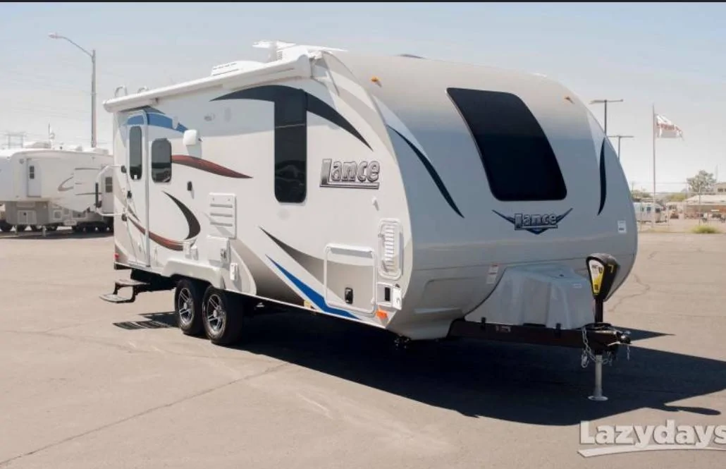

Picking up a Lance travel trailer this weekend. I have a stock 21 lariat tremor with factory tow and an added Ford accesory trailer brake controller. Planning WD hitxh and focused safe driving practices 65 max sped ect. No plan to further modify the truck.
My wife and I travel fairly light. Living in CA Gold Country, our trips will always include foothill and mountain pass driving.
Windage behing this small truck is my only real concern.
What additional wisdom -guidance do you have? Appreciate your knowledge and input.
2018 Lance 1995 Trailer Specs
Dual Axle
Length 23.67 ft. (284 in.)
Width 8.06 ft. (96.75 in.)
Height 10.17 ft. (122 in.)
Dry Weight 4,080 lbs.
Payload Capacity 1,620 lbs.
GVWR 5,700 lbs.
Hitch Weight 365 lbs.
