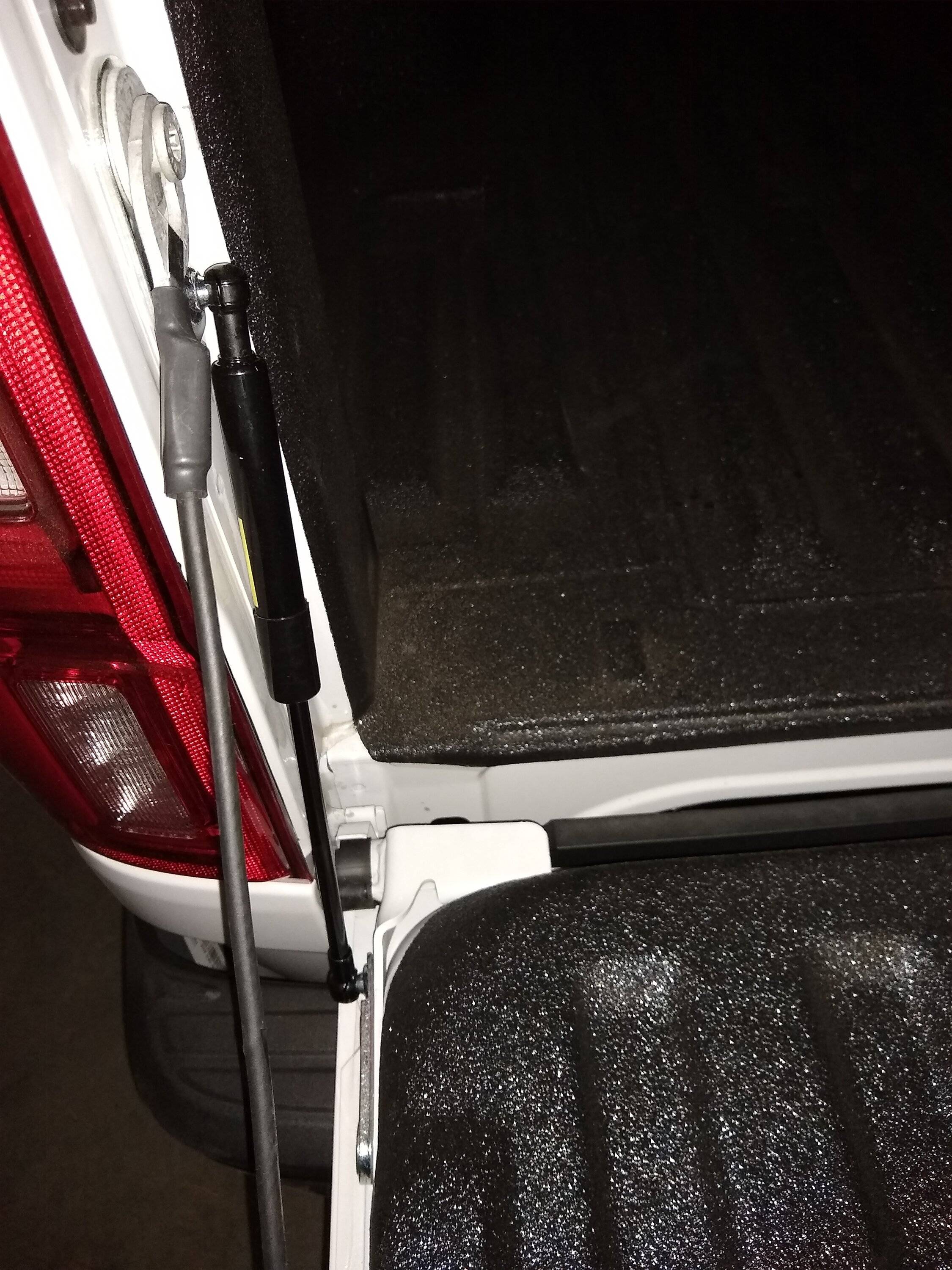

Dee Zee damper arrived today and I put that on. I didn't realize how much I missed having tailgate assist.

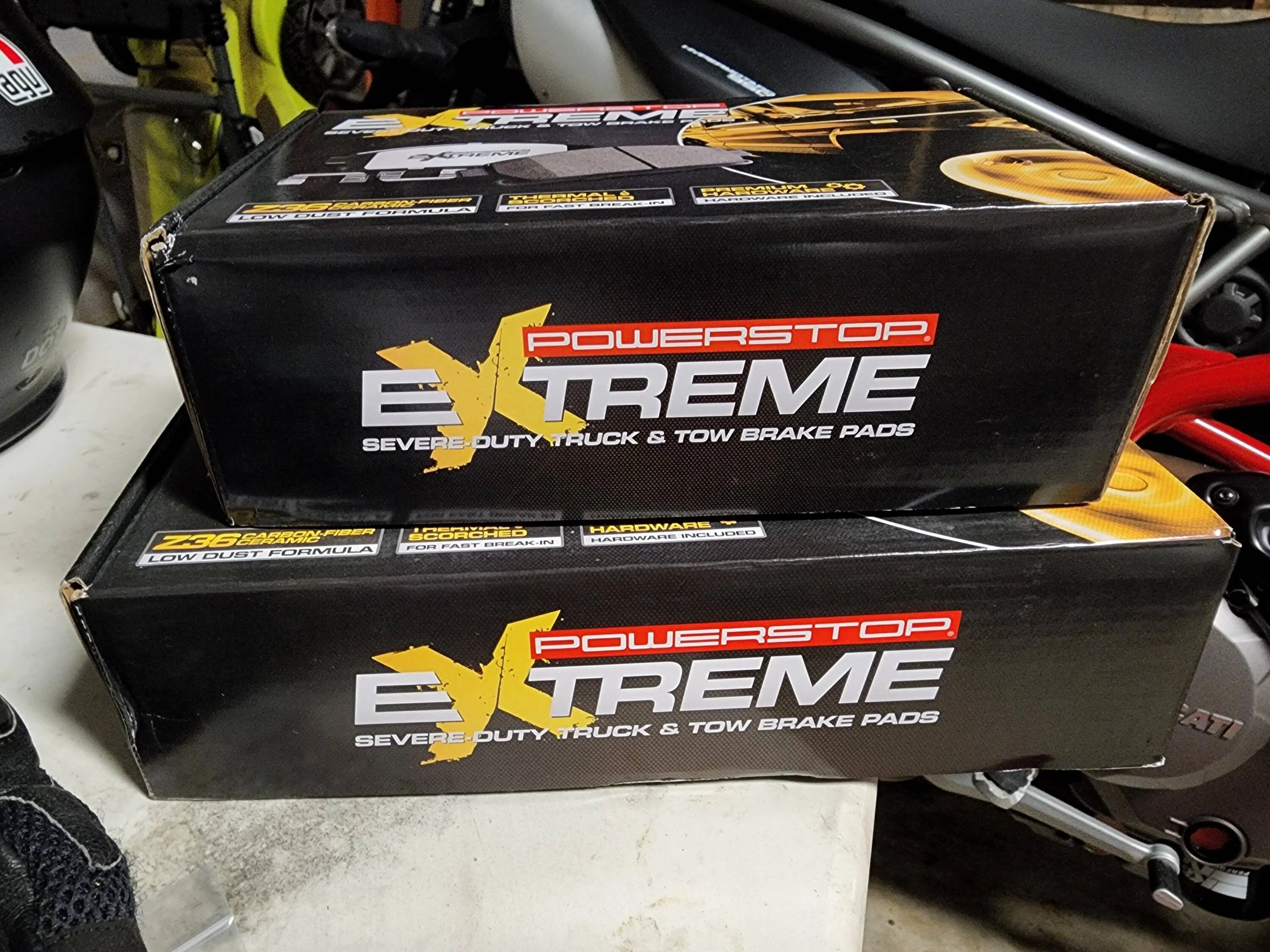

After going with 33s and beadlocks my brakes weren't to my liking. I've had good luck with Powerstop in the past so I went with their Z36 pads.
I got stuck on the rears, because I thought the pistons went in clockwise. Incorrect, counter clockwise. So I had to buy a new left hand threaded tool.
On these you have to put a lot of pressure on the piston while winding because of the parking brake. My trick was to remove the rotors and then reinstall the calipers sans rotors. That helped me not have to juggle so much.

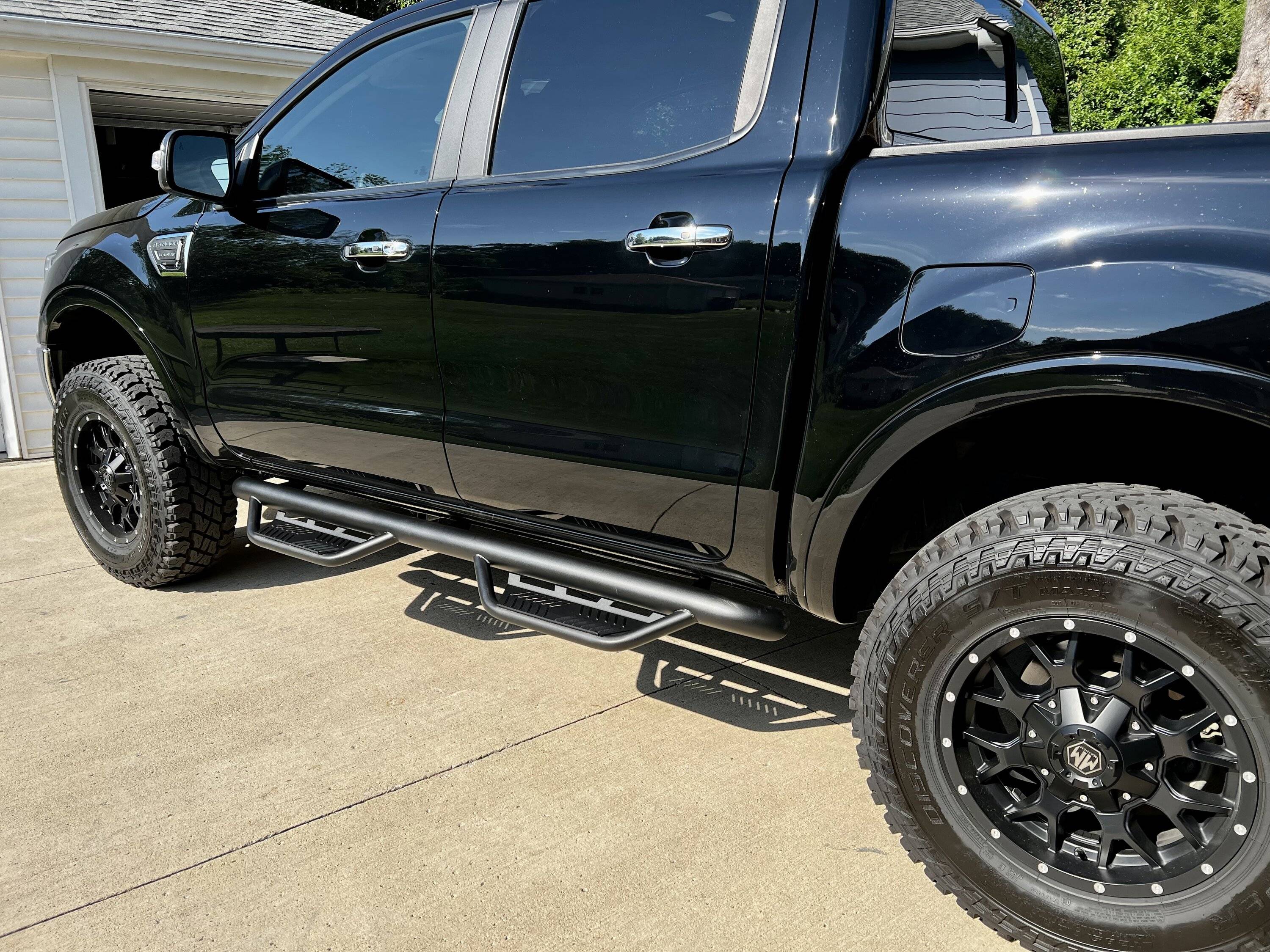

I know, I know…on pg. 929, I said I was going to be done for a while. No sooner did I say that and I get an email advertising these Havoc HS2 steps. The rest as they say is history. I’m not even going to bother fooling myself anymore.
I have same ones on mine! Love the placement of the steps. They are perfect for stepping in and d9nt get in the way when getting out.

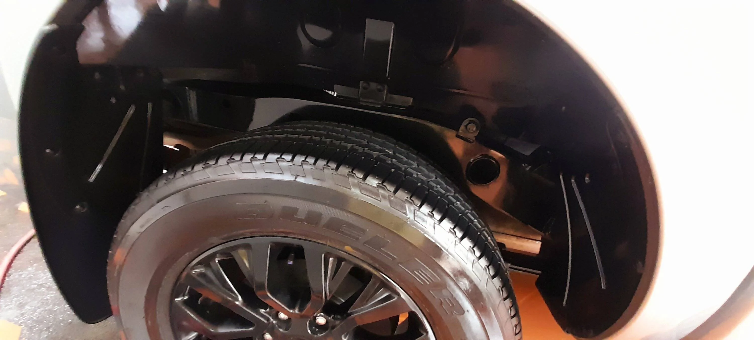

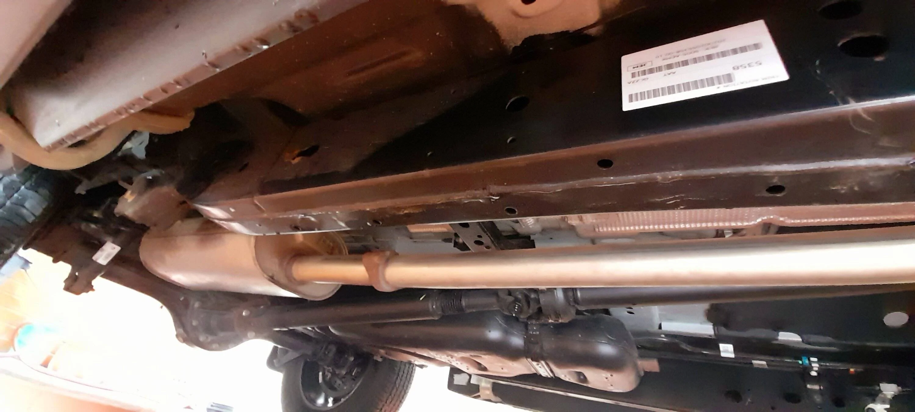

So did a thorough cleaning today. The other thread on undercarriage get me horned up lol to do a good cleaning. It was not very dirty just some light mud, but once I looked had to clean. Just backed truck up onto my little curb in my carport and went to town. Smooth wet tile makes it really easy to slide around under the truck.

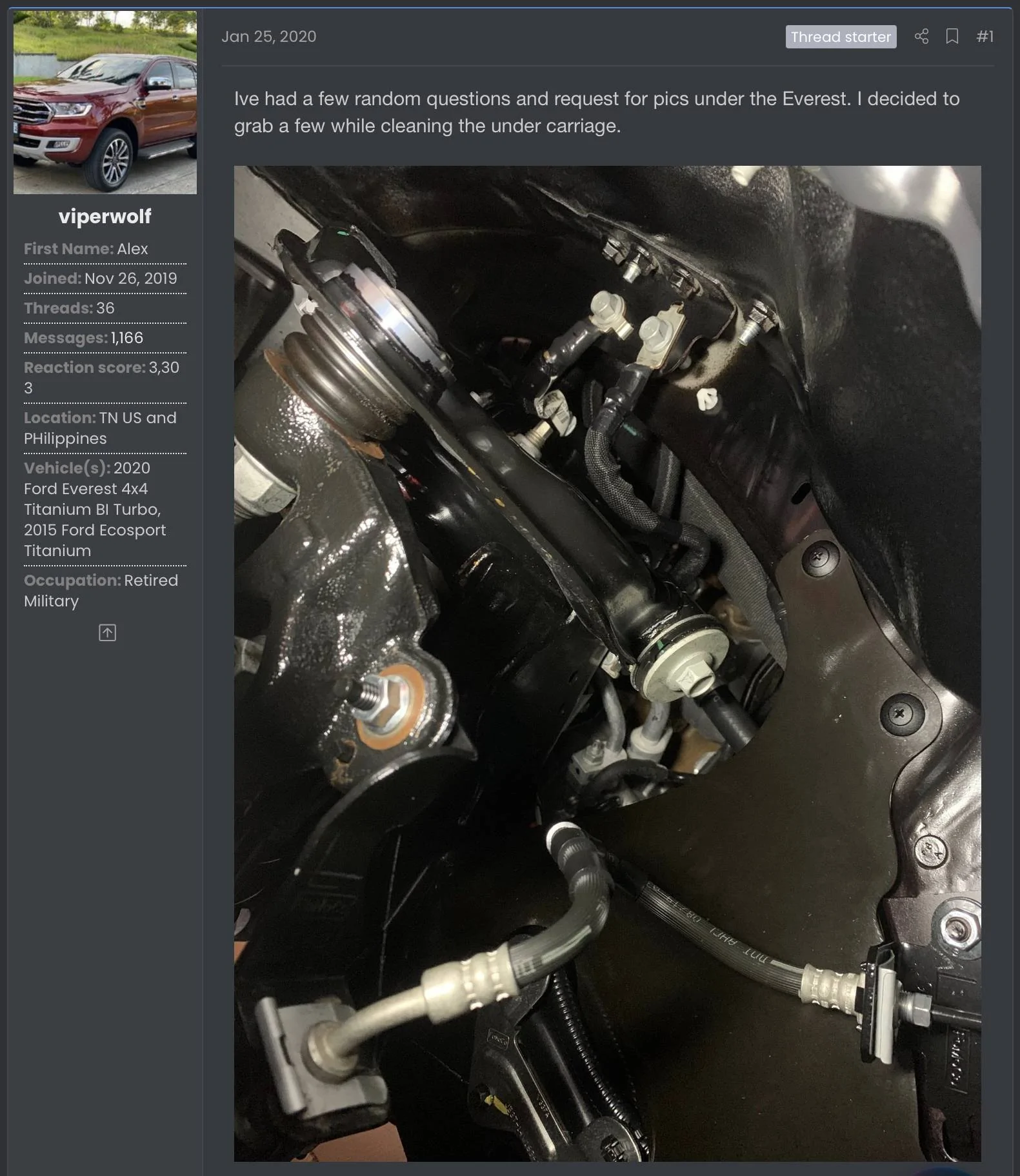

Getting the underside of the vehicle must be a Philippines thing. Have you been hanging out at @viperwolf ‘s place?
Speaking of Viperwolf….I haven’t seen him on the forum lately. What’s up Alex? We miss hearing stories of your Everest. I hope all is well, but I will track you down if necessary.
****quickly opens a new window and does a Google Images search on ranger5g for clues. :inspect:

I love them so far and you are right about the placement, everything is spot on.

Actually here in the Philippines your carport is almost always nicely tiled. Makes for a clean parking and to get underneath. But wet smooth tile, not great to walk on lol. It can be dangerous. But works well to slide around under the truck to clean. Yes I am a tad OCD when it comes to cleanliness.
