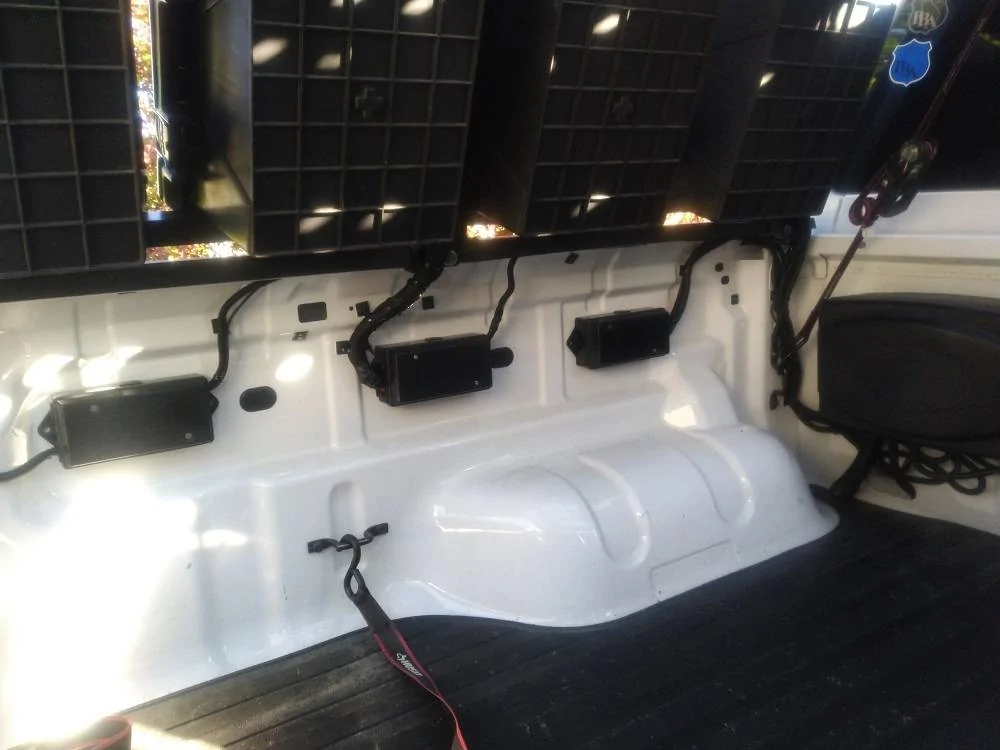

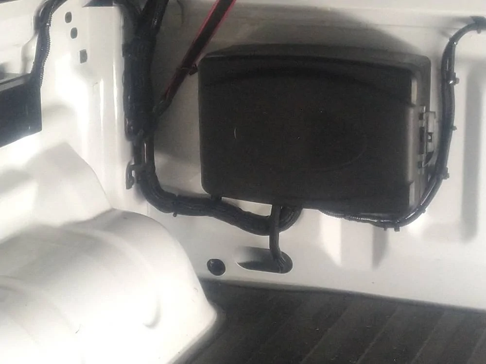

Cleaned up some of my rear bed wiring. Was driving me nuts.

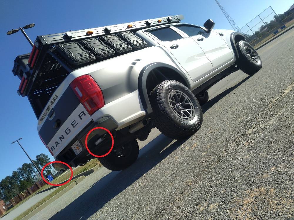

I also did something with some inactive bumper lights I've had mounted for some time. I wired them directly to the 7-pin harness so they activate with reverse. My rear rack lights are still controller operated.
Clever on the backup lights, which ones are they?

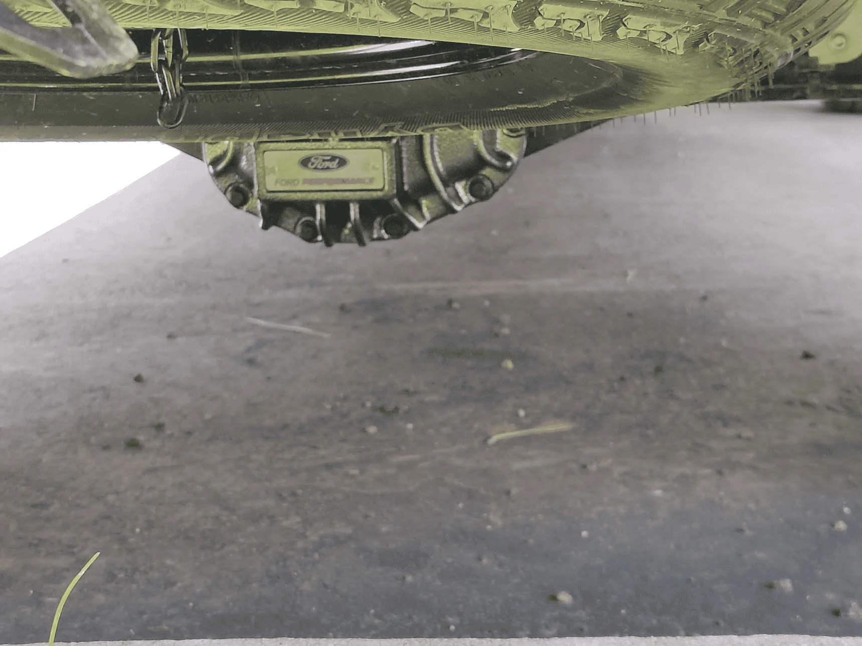

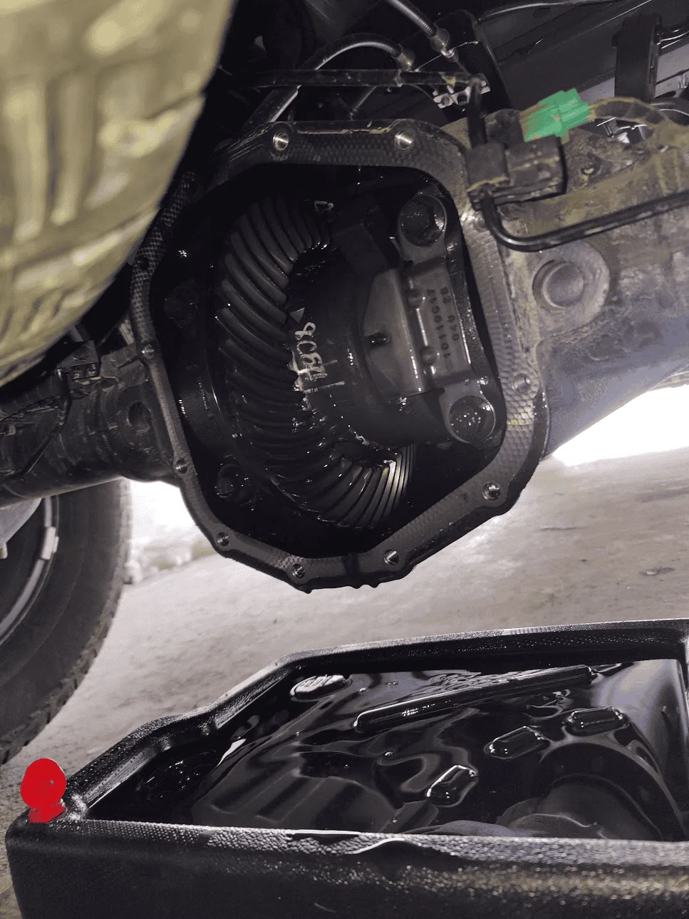

My other order was for the Ford Performance diff cover. No, it doesn't have a drain plug, no it doesn't hold my fluid. So why buy it? Because its stronger than factory, has some integrated cooling, and I am not worried about bashing it against a rock. My recommendation, for anyone doing diff work, is drop the spare. I had issues trying to get the new cover up in place, and once I dropped the spare, everything was immensely easier. I am kicking myself for not dropping when I started the removal of the factory cover.
One thing to note, is I did this work with about 1500 miles on the rear diff, and there was some good size particulate that came out. It had me slightly worried, and am going to keep an eye on it. The fluid looked nasty for 1500 miles as well, which I am assuming is because of the break-in on the gears
Inside of an FX4 Locking diff for good measure
And because I failed to take a photo upon completion, here's after about a 15 mile test drive. Just barely peeking out from underneath the spare
If I recall they are some 18W Nilight floods. I think you can get 4 of them for like $30 on Amazon. I also use four of them under my rack as ceiling mounted cargo lights.

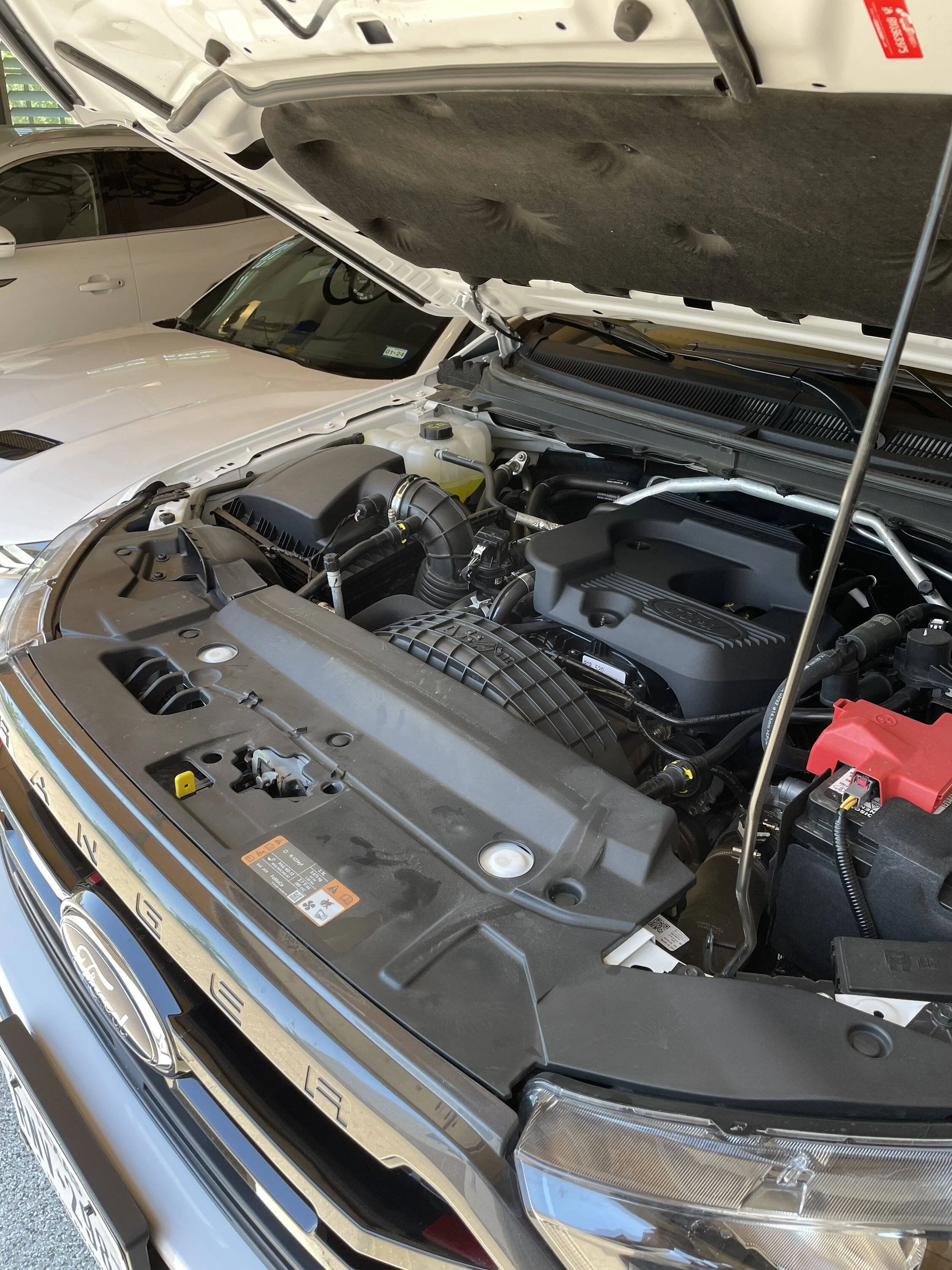

Installed the Ford High Performance Engine Cover. Let’s just say, the increase in performance is amazing. With this modification, I can almost keep up with my kid’s 5.0.
I like the engine covers, but wouldn't shell out for one unless I intendd to keep my truck 20 years, get Antique plates, and show it.

I would not have purchased it either except I had extra Ford points left over. I have noticed a reduction in engine noise since installing which I find to be a benefit.
Thank you! I see them in my very near future. =)
