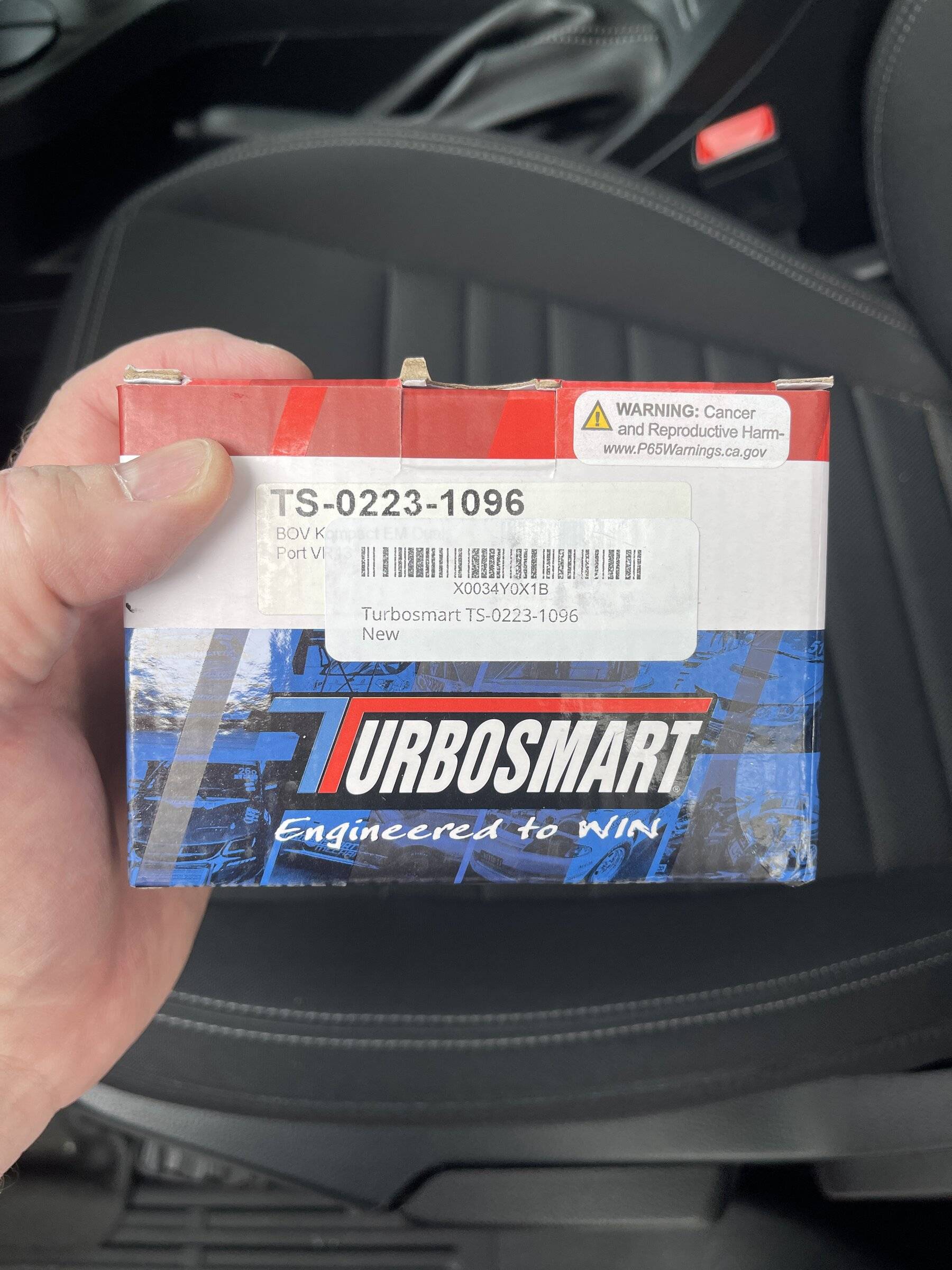

Same as the, “What did you receive in the mail…” thread. Quick 5 minute or so swap of my GFB DV for the TS Dual Port BOV.
What does that actually DO for you? What's its purpose?

why did you switch? (if I understand correctly, its one aftermarket for another. Not OE for aftermarket.)
Yes, and no, and yes. The GFB DV+ replaces the bottom part of the stock valve, cheap plastic for plastic, but with a better working piston setup. So, you still retain the stock upper part of the assembly, where the electrical connection is made. "They" say the benefit of the DV+ is better holding of boost and smoother operation.
The Turbosmart comes in two flavors. One that is completely recirculation, like the stock setup. This one does basically the same thing as the DV+, but replaces the entire valve with an aluminum housing. The dual port simply vents 50%'ish of the air that would be recirculated to atmosphere. I don't know that there is any real performance benefit to that happening, just a noise. Probably not since I made @Doc sad.
It's so easy to change back, if I decide I don't like it. So, no big deal to me.
Allows me to spend money that I would probably otherwise give to the ex-wife in one form or another.

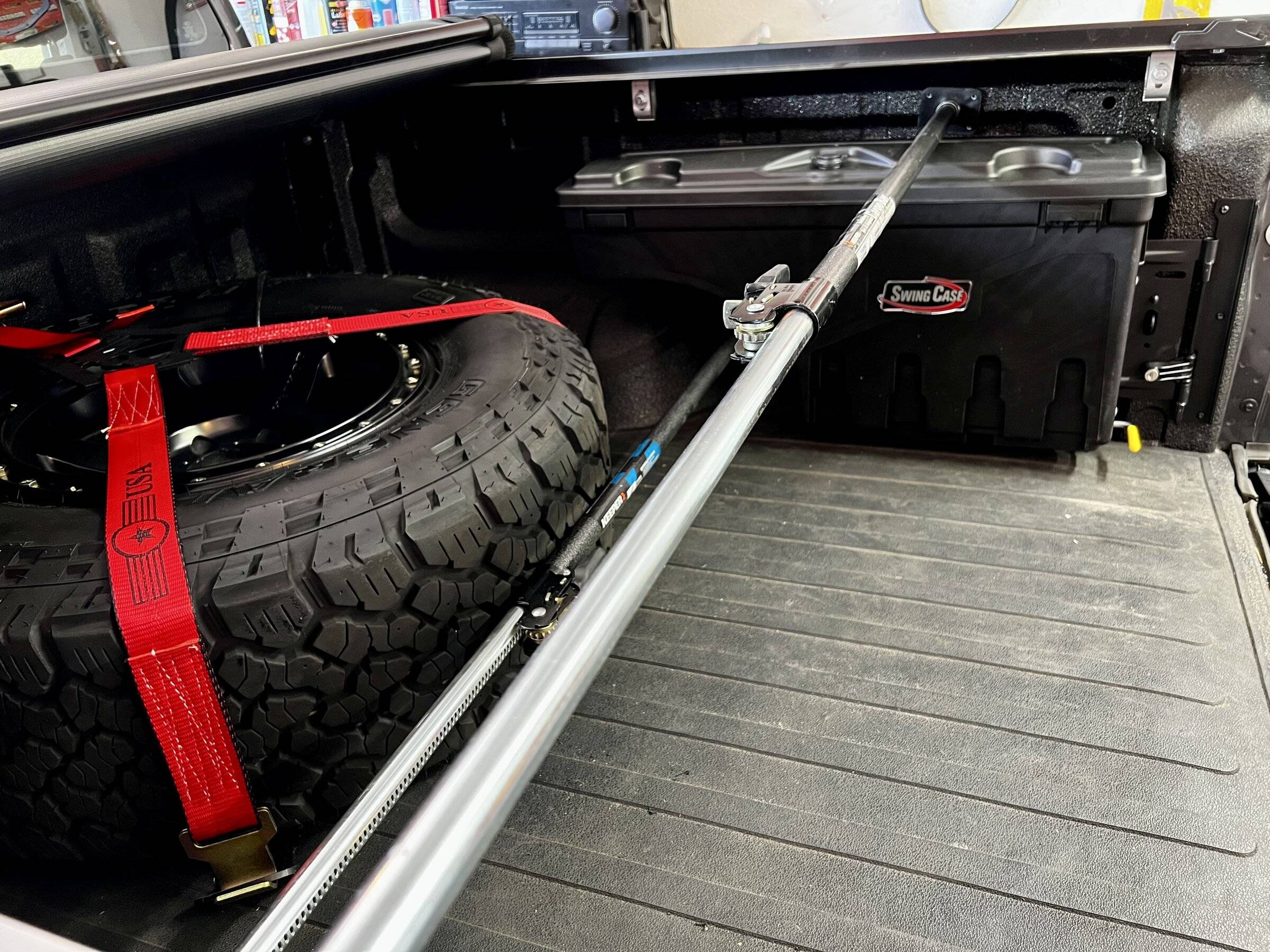

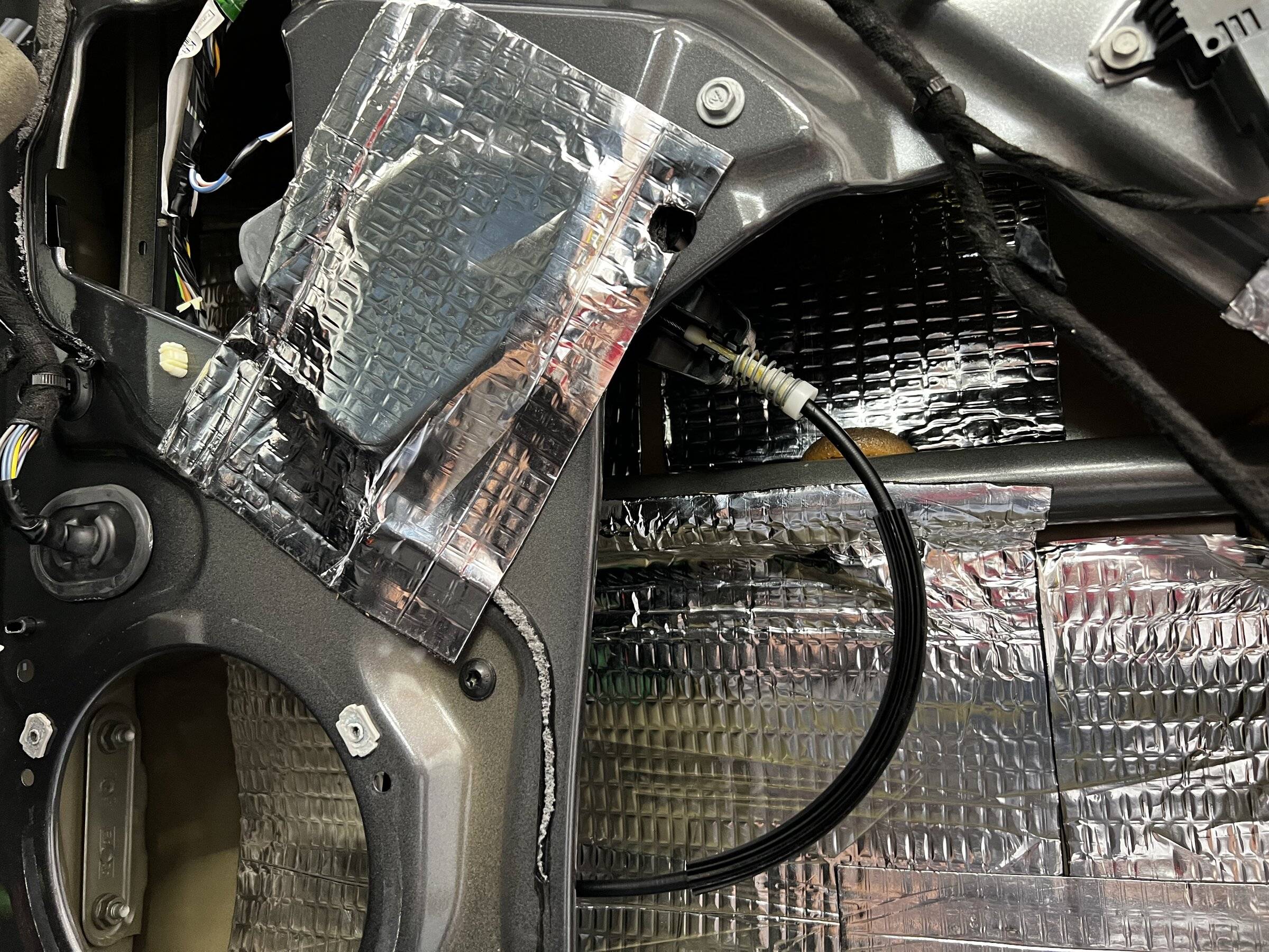

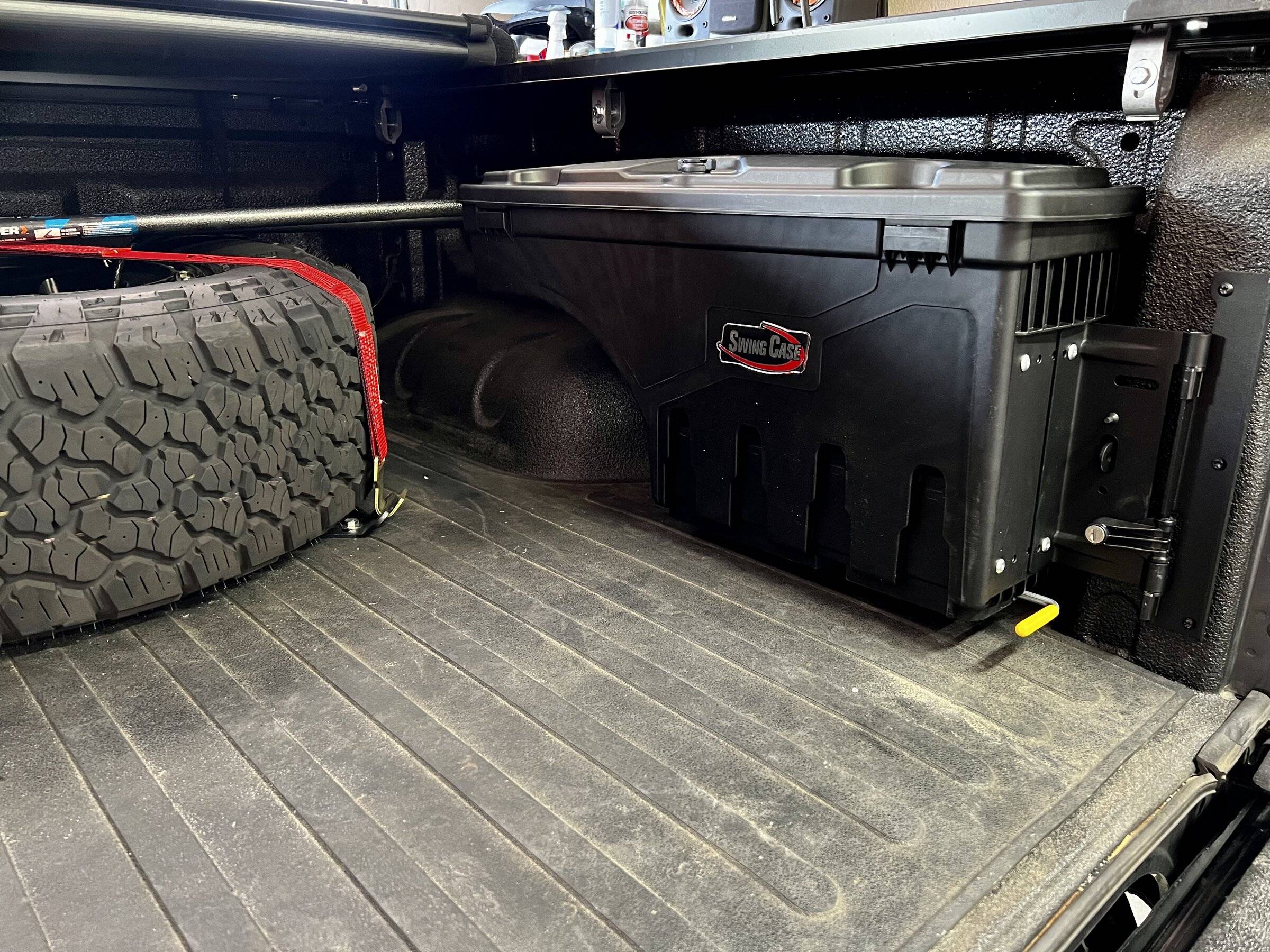

Added a passenger side swing case to store my drop hitch etc.,and snatch strap,and other misc. items.

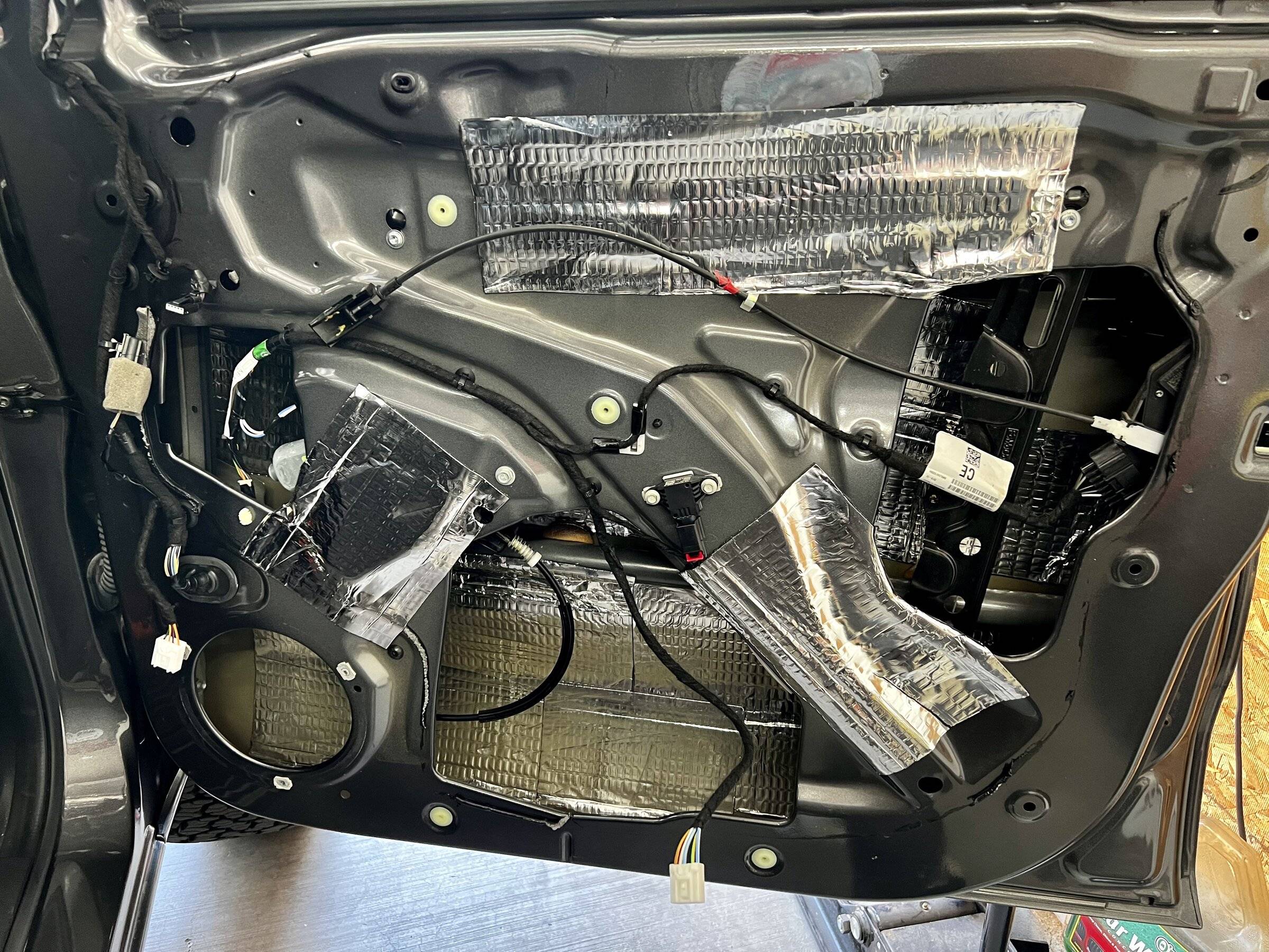

‘Also swapped out my factory speakers for some Infinty’s,and while the door panels were off,laid in some sound deadening.Really cleaned up the sound,and now my doors don’t sound like cheap tin cans lol.
Swing case
and and a quick shot of the passenger front door

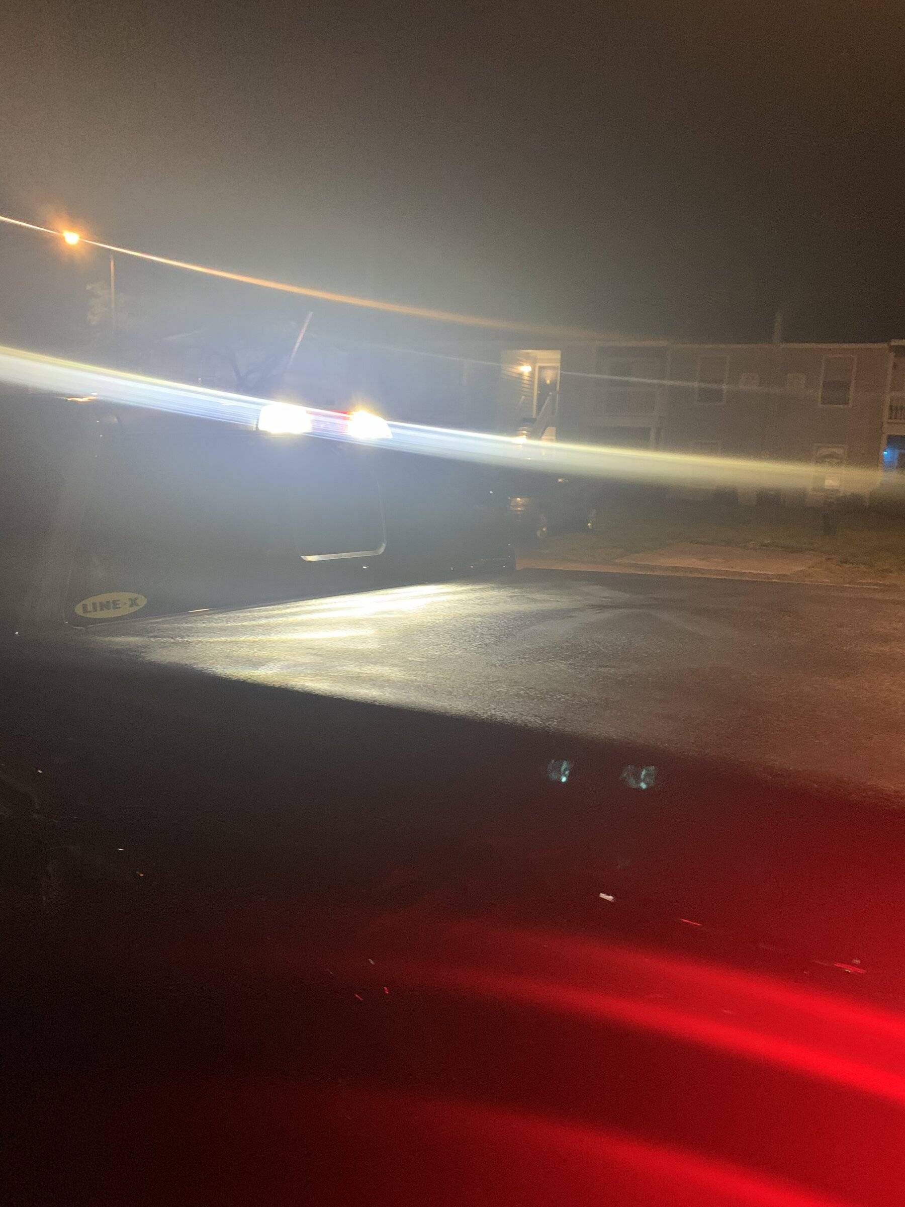

I was messing around in the DIY section last week and saw a post by "quangdog" dated back in 2020 where he did a nice DIY video. He and some of you made it look sooo easy that I just had to get a pair of these cheap LED puddle lamps from Amazon for myself. They arrived today so I snapped them on . Took all of 10 minutes.
Peer pressure is strong around here. You guys need to stop it! LOL
Can you provide a link or the make and model of the lights? Looks very nice.
I haven't got a clue what this sentence means ?
The forum needs a glossary.
GFB?
DV?
TS?
BOV?
Doc
Doc
Dec 24, 2018
94
5,784
23,316
Live oak fla
GFB?
DV?
TS?
BOV?
Its blow off valve lingo BOV (unless you have a bigger turbo, you don’t need a Blow off valve)
GFB -Go fast Bits
DV-diverter valve
TS - Turbo Smart
BOV - blow off valve

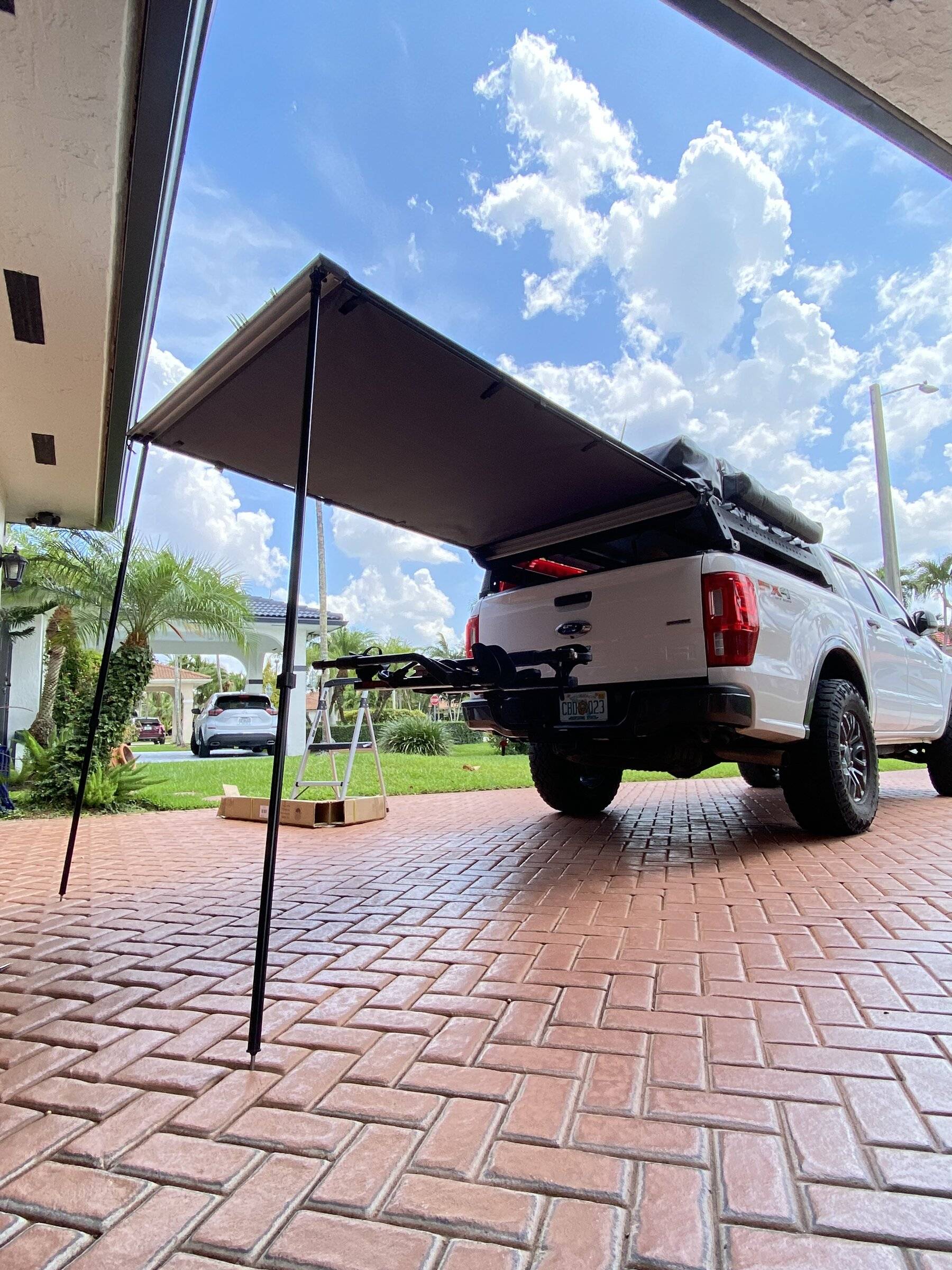

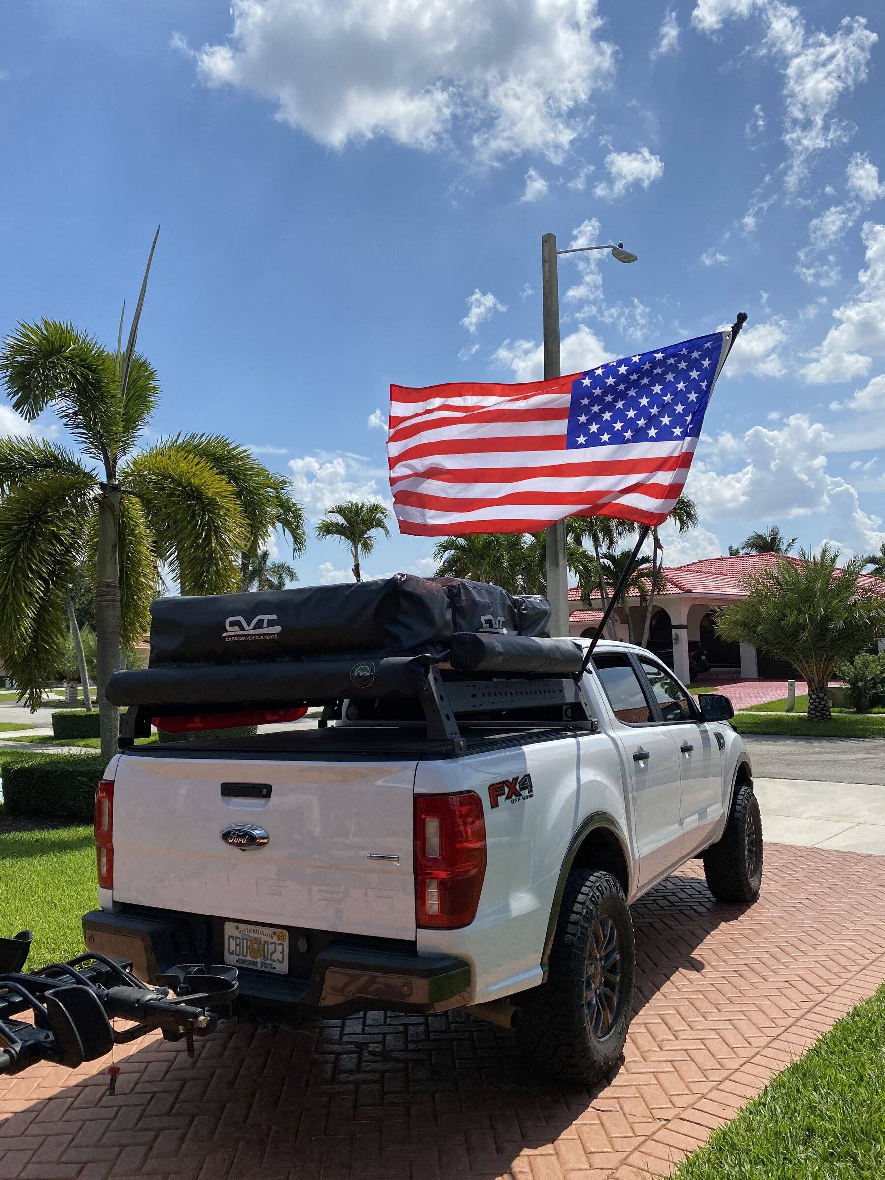

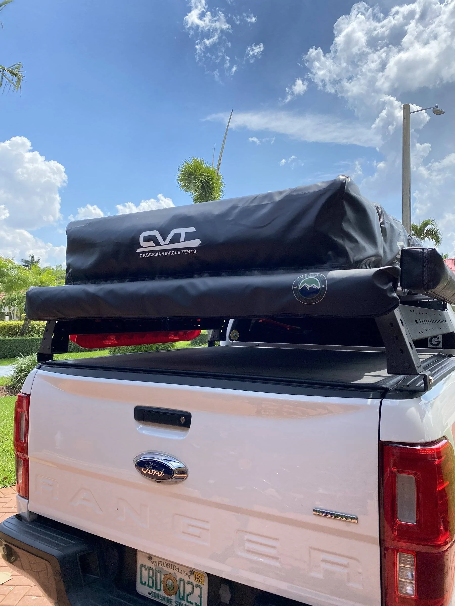

Picked up a 4.5’ awning from Overland Vehicle Systems to mount on the rear of the truck. Now the tailgate area has shade when out camping. Also added a flagpole mount to the non-opening tent side of the truck.

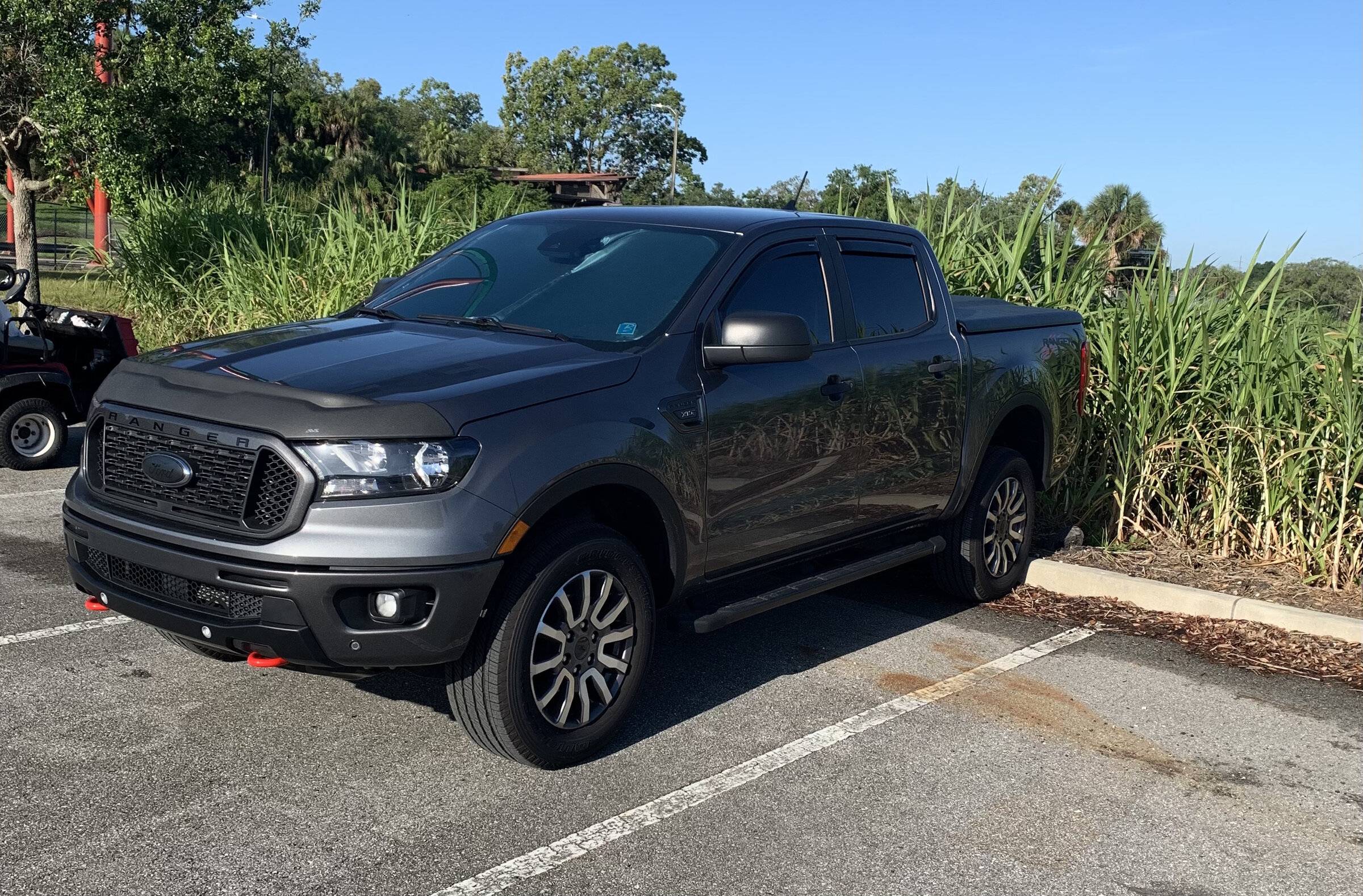

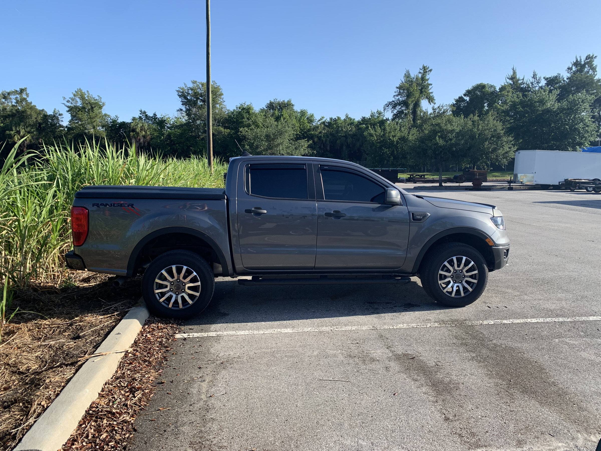

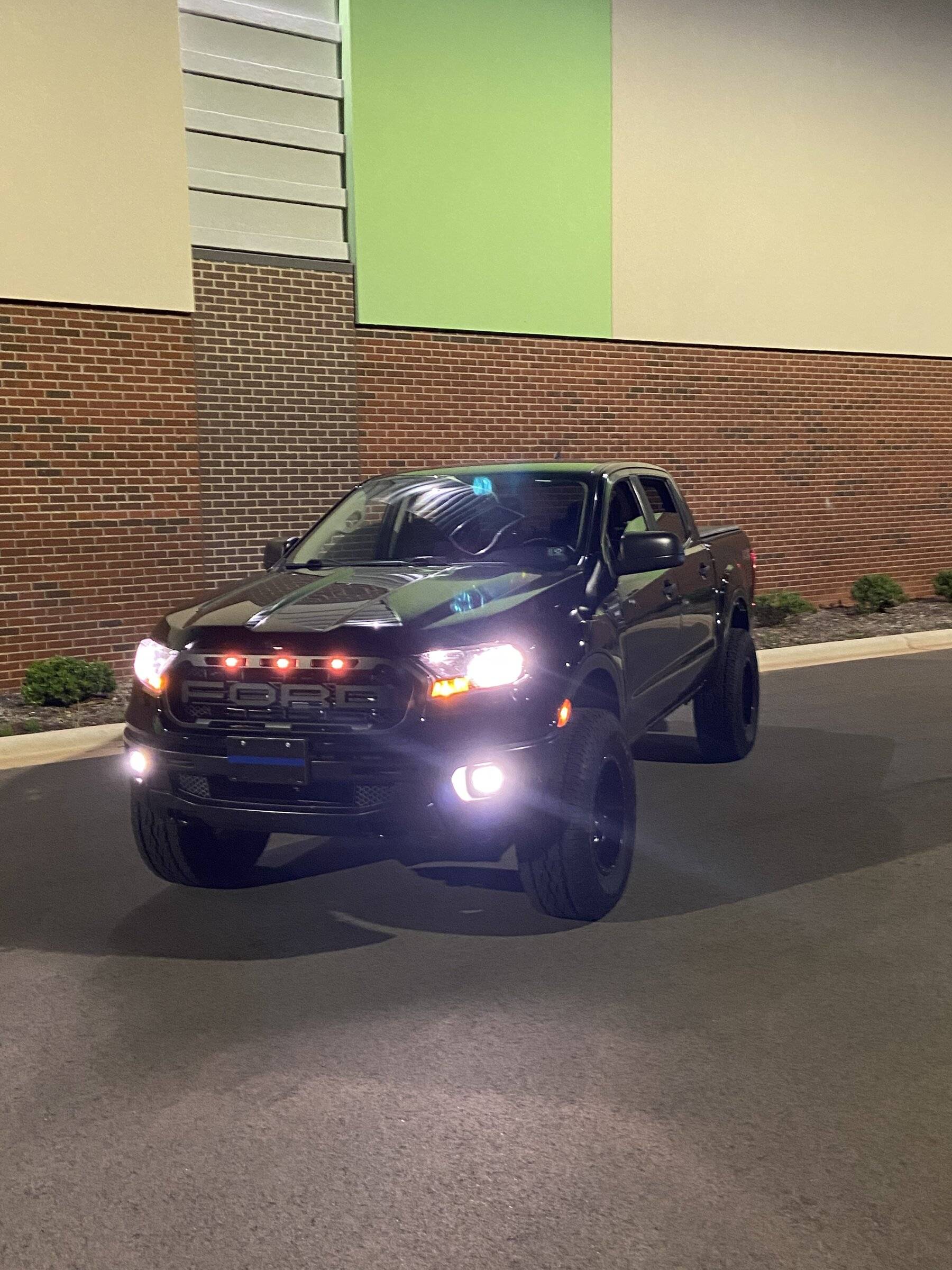

Adding a picture, after installing the Icon leaf springs. It measures 40" ground to fender in the front and 41" ground to fender in the rear. Slight rake, which I don't mind.
Took the wife out in the truck for the first time since the install and she said "it feels a lot smoother". I will take that as a win.
I am going to be doing the ford tremor springs as they are multi leaf vs single on non tremors. Can this be done in the garage with basic hand tools?
