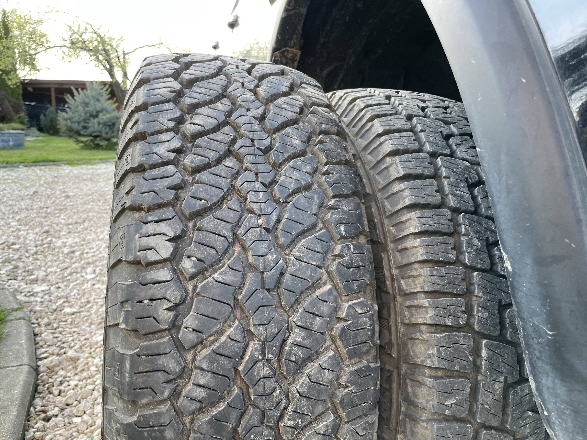

It’s been a while I have not posted anything in this forum. Well, it’s about time. I am preparing to do something to my ranger and to my wallet(that I already did). I got this offer I could not refuse, OEM tires of a Raptor, almost new, less than half price. General Grabber AT3 LT C rated, mid 2021 DOT, newer than my truck. Mathematically it’s a very small difference from the 265/70/17 I already had. Optically it’s huge, not as pretty as the Pirelli Scorpions ATs but for some reason I cannot get that in Romania. All 121/118Q Coopers/BFG/Yokohamas and the rest. Raptors used to come from factory with BFGKO2s, since 2020 is GGAT3s. They weigh 23.3kg each. I will weigh the Scorpions once they’re off. I will be using the 8” panther OEM rim.

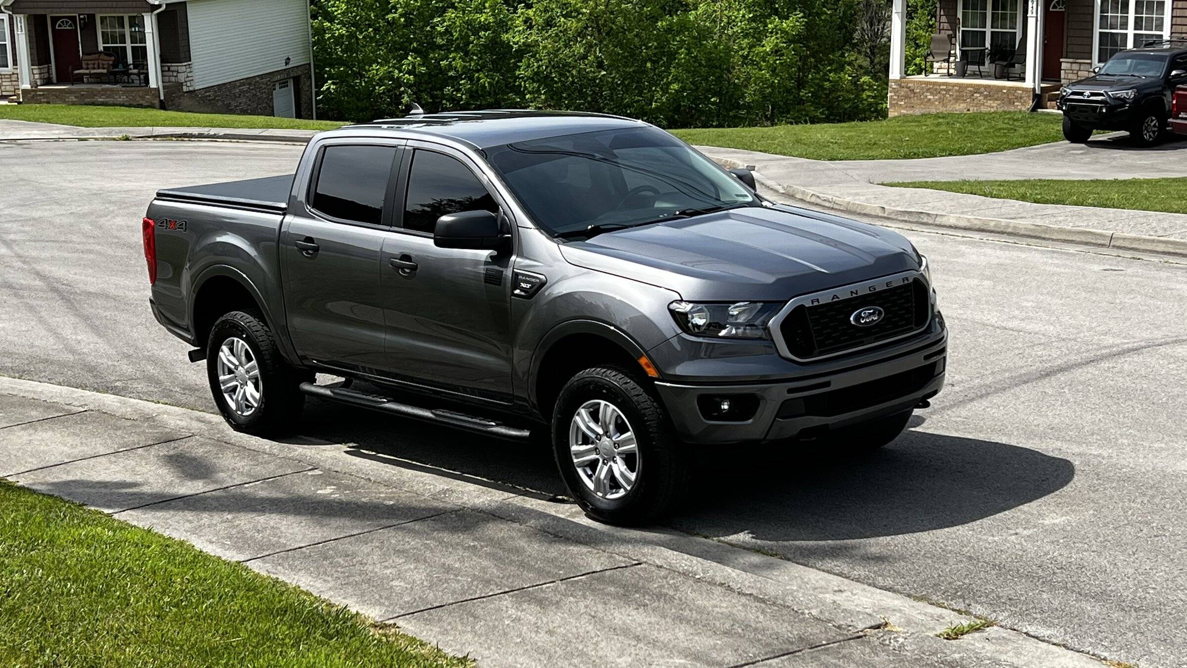

That looks perfect! I just noticed I don't have an Ecoboost badge or dealer stickering on my truck. I wouldn't be too bothered by the Ecoboost, but glad the latter isn't on there. Did ya'lls trucks come with EB badge or did you pick one up?
03/08/2021 build date and black appearance package. No EcoBoost tag. Did have a dealer sticker (which I promptly removed with a hair dryer and some automotive goo gone.) Also had a "Northwest Edition" sticker, which I left, I kind of like that one.

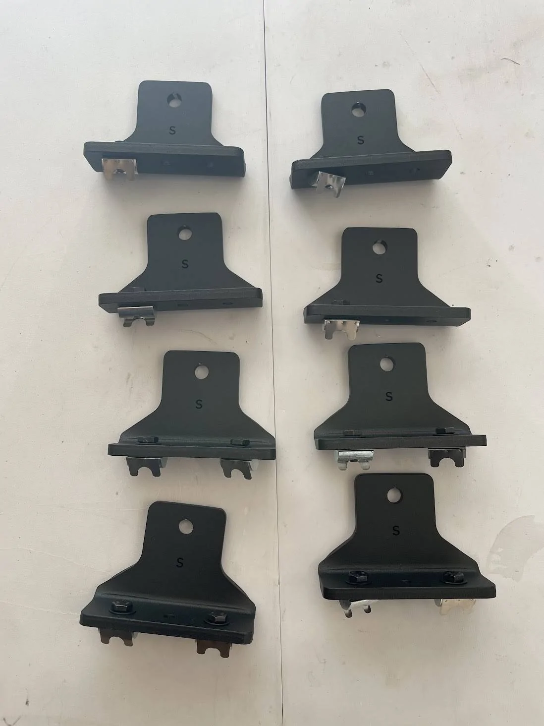

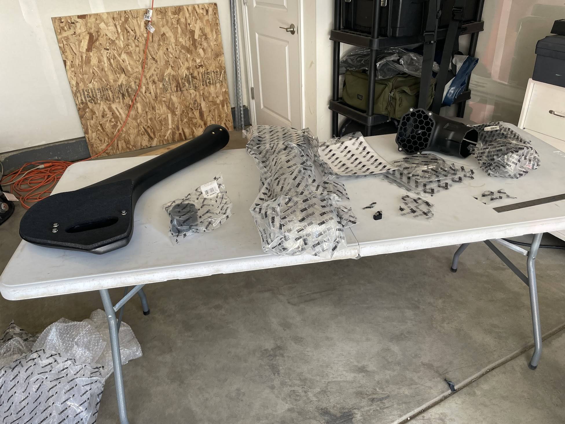

I spent some time in the garage prepping the next modifications. Making sure all the snorkel parts are in and prepping the new mounting system for my RTT.
I miscounted when I got the t-nuts, so I will have to go get 12 more.

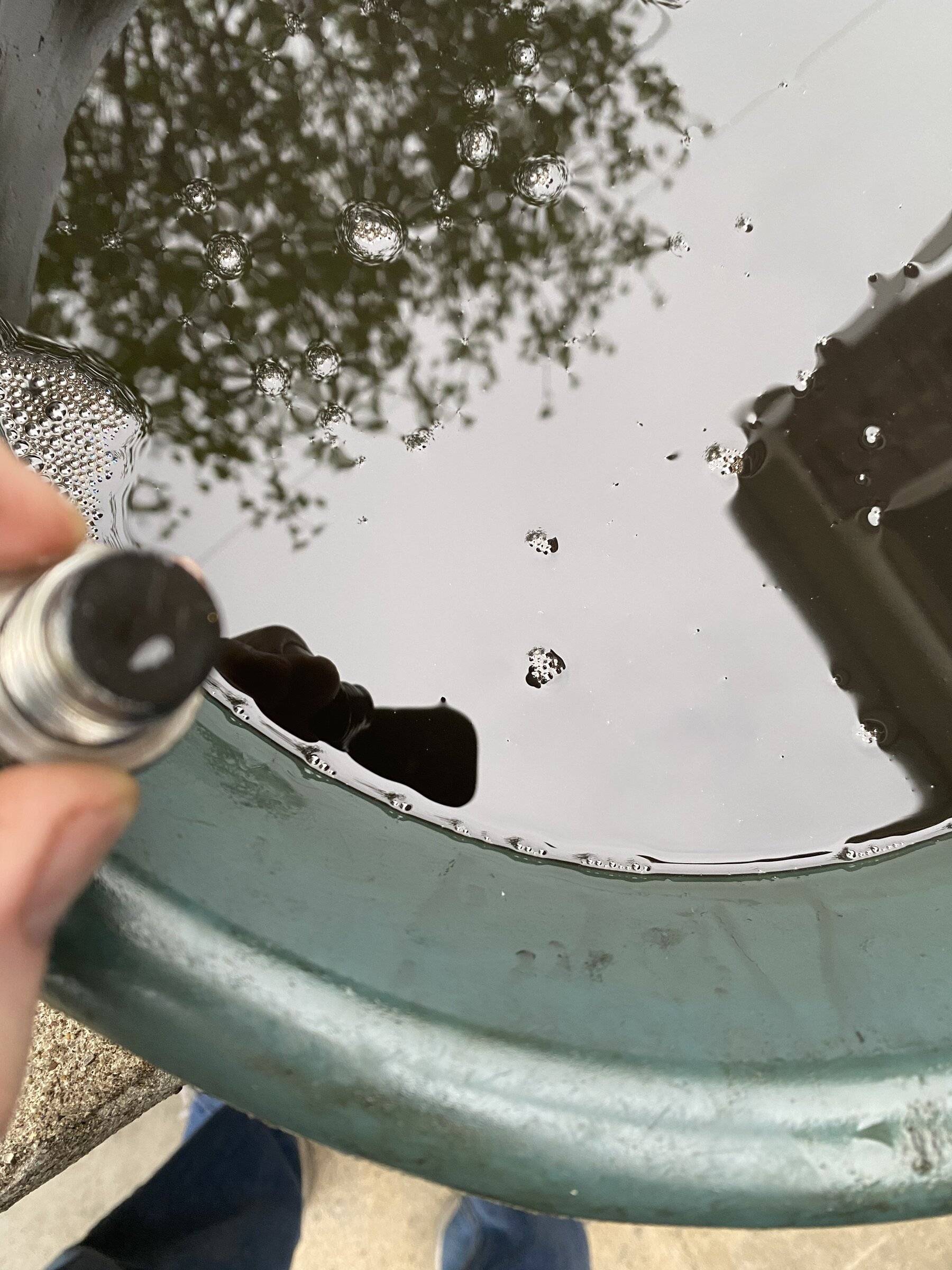

Changed the transfer case lube. Based on past experience with my other trucks, as expected it looked like tar at 30,000 miles. Replaced with Redline D6 ATF which meets the Ford Spec in the manual. You need a 3/8” hex key on the plugs, not a 3/8” drive, and a cheater pipe to get the plugs out. Fill and drain plugs are different as only the drain plug has a magnet so don’t mix them up.

Installed. The truck is dirty. I will post more after a wash. The steering feels a bit heavier, just a hair. I did not yet weigh the 265/70/17 for comparison sake. According to Pirelli they are 18.7kg. So, 4.6kg per wheel heavier for the new setup. Noise is the same, almost unnoticeable.
The tire specs are General Grabbers AT3, snowflake 3PMSF, 285/70/R17 116S, 2 ply.
I’ve included a picture of the last time I had the 265/70/17” on.
