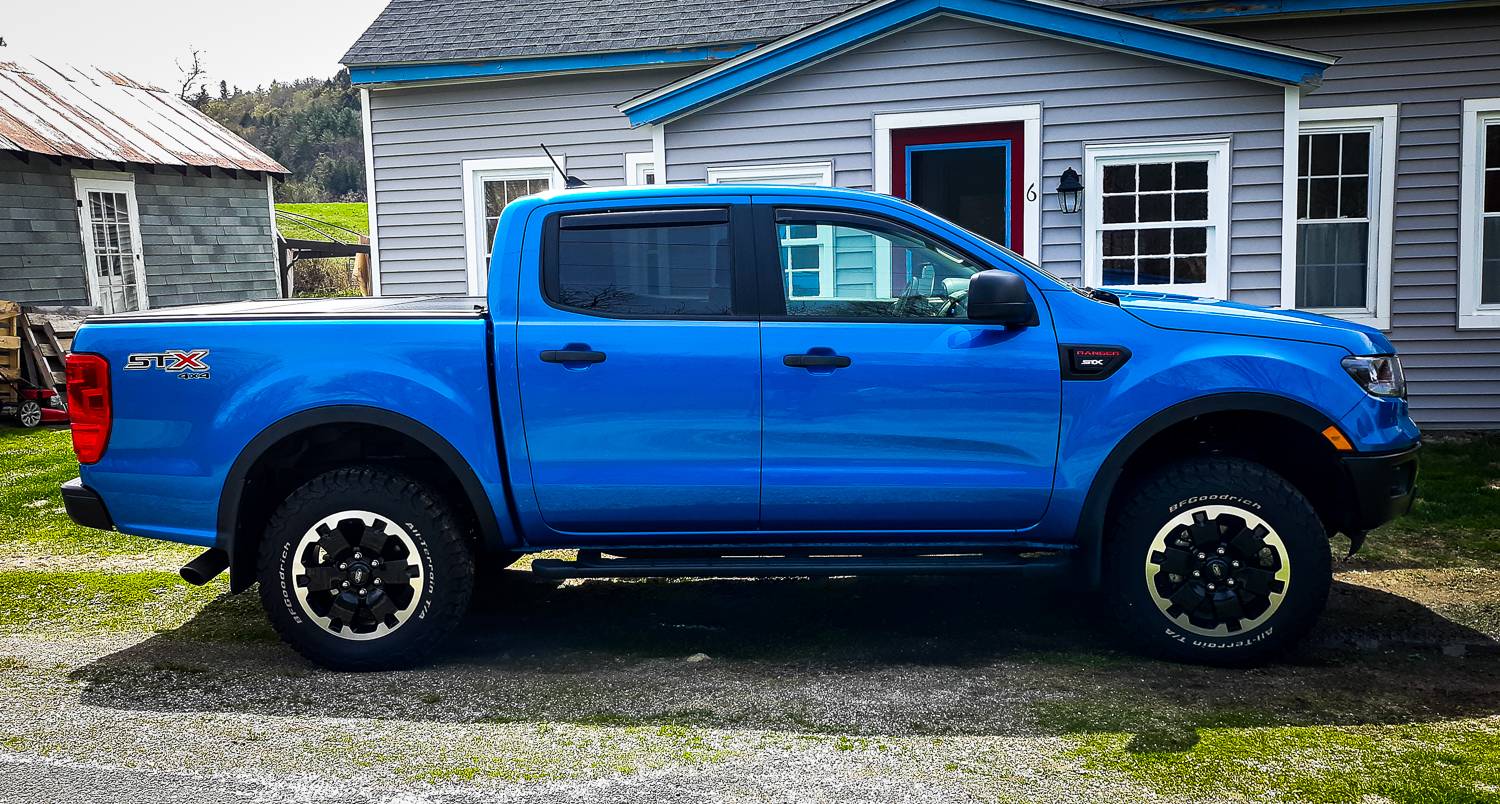

Finally after 6 months, got the front Eibach 2.0s installed! Dealer had been short staffed due to Covid and I wasn't pushing them. Have to say very happy with the upgrade. Gave it a quick bath today and a few vinyl accents to dress her up. Approaching 16,000 trouble free miles, she's a keeper!

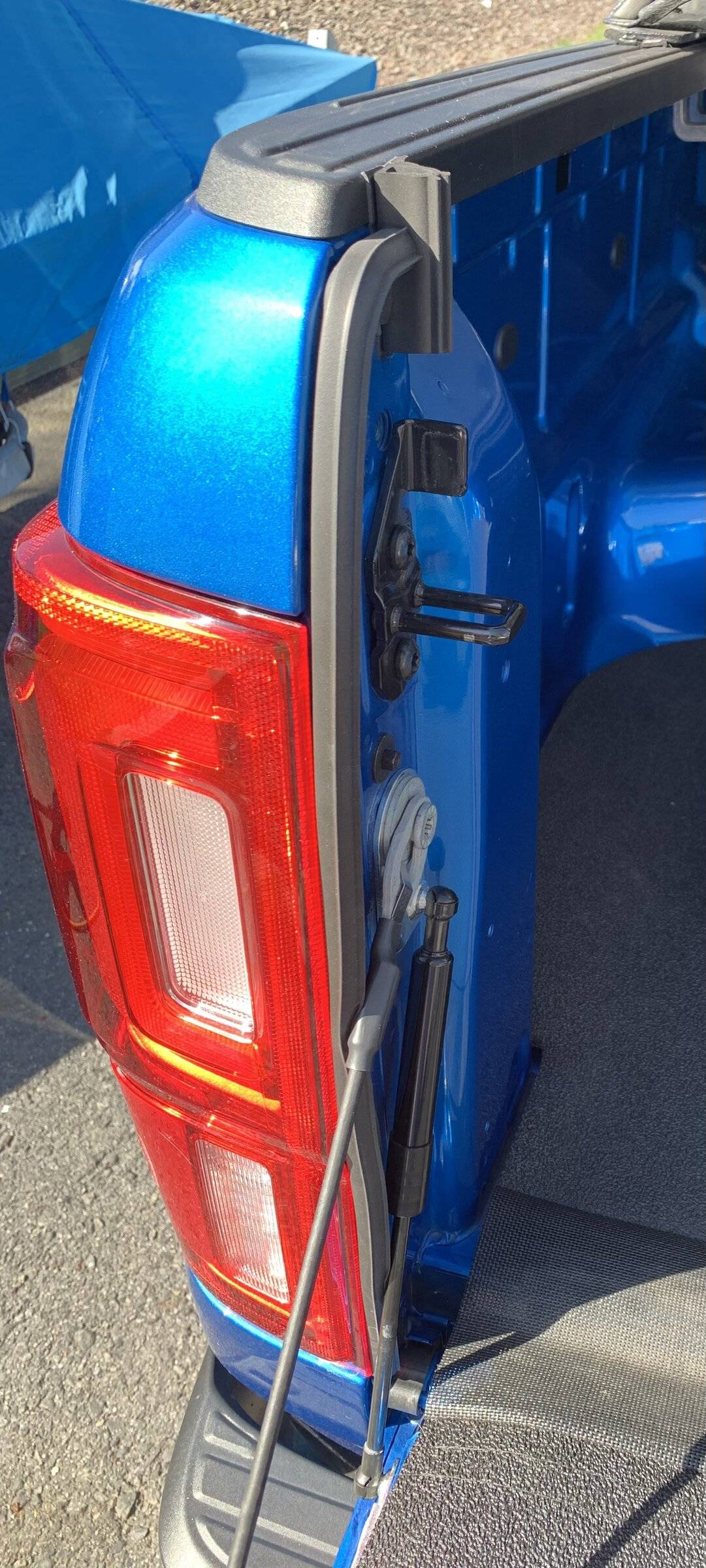

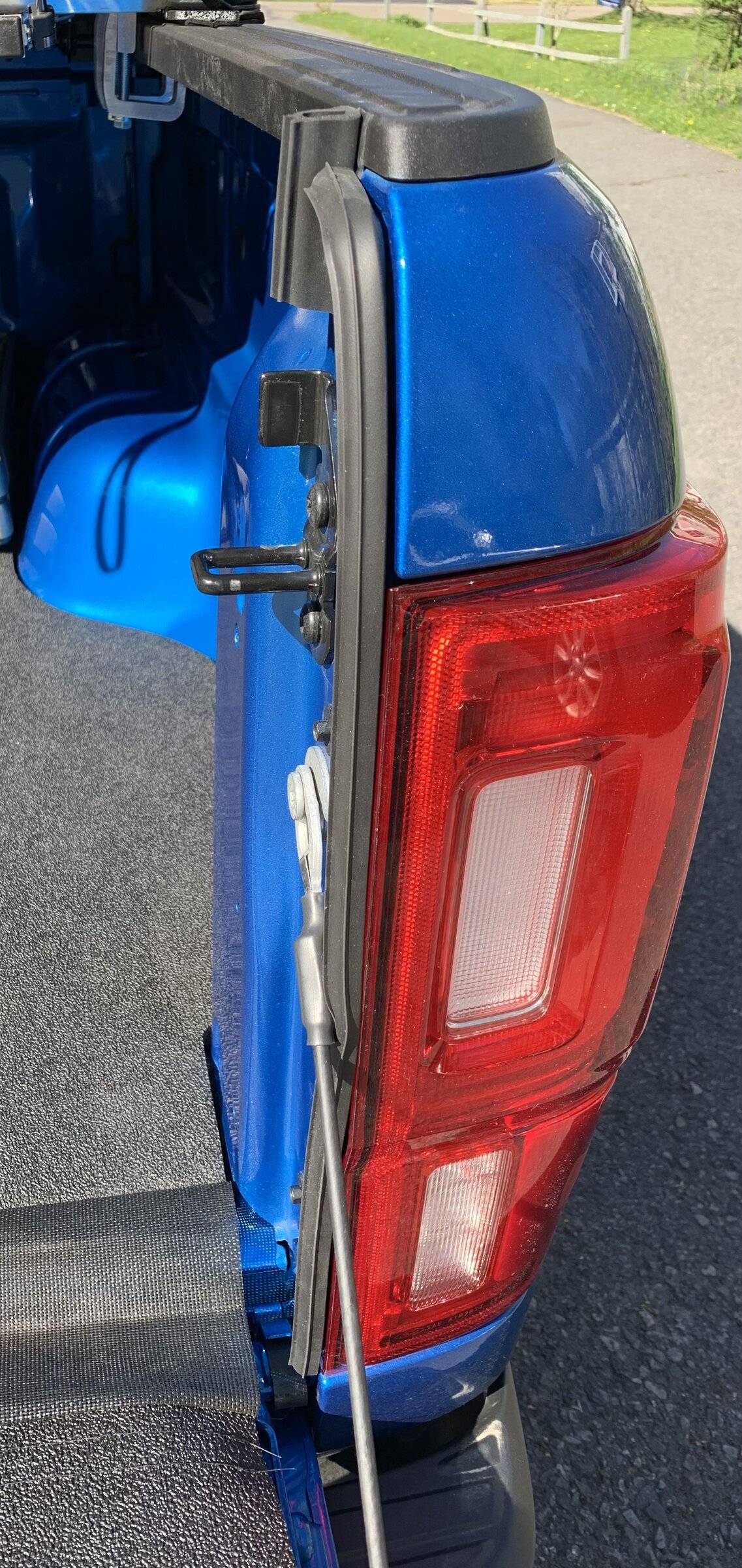

Finally got some nice weather and was stuck at home for the whole day so I installed the weather seal for the tailgate area.
Hoping it keeps the majority of water and dust out of the bed ; not going to bother sealing the bottom edge as I’ve found that the transition flap that is part of the bed mat keeps most things out already.
