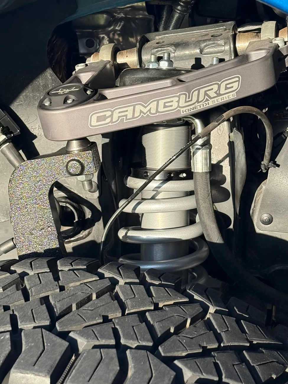

Besides Camburg, does anyone else make a uniball UCA that fits both aluminum and steel knuckles? My truck was in a wreck in 2021 and Ford put an aluminum knuckle on the side they fixed. So I can’t just go with any set of UCAs. My upper ball joints are fried so I have to replace them asap.

My question isn’t about knuckles. I knew it was an aluminum one the minute they put it on, the question is about who makes unibal control arms that can be used with both steel and aluminum knuckles so I just have to order 1 set

Icon suspension has discontinued control arm (ball joint) for steel knuckles.
