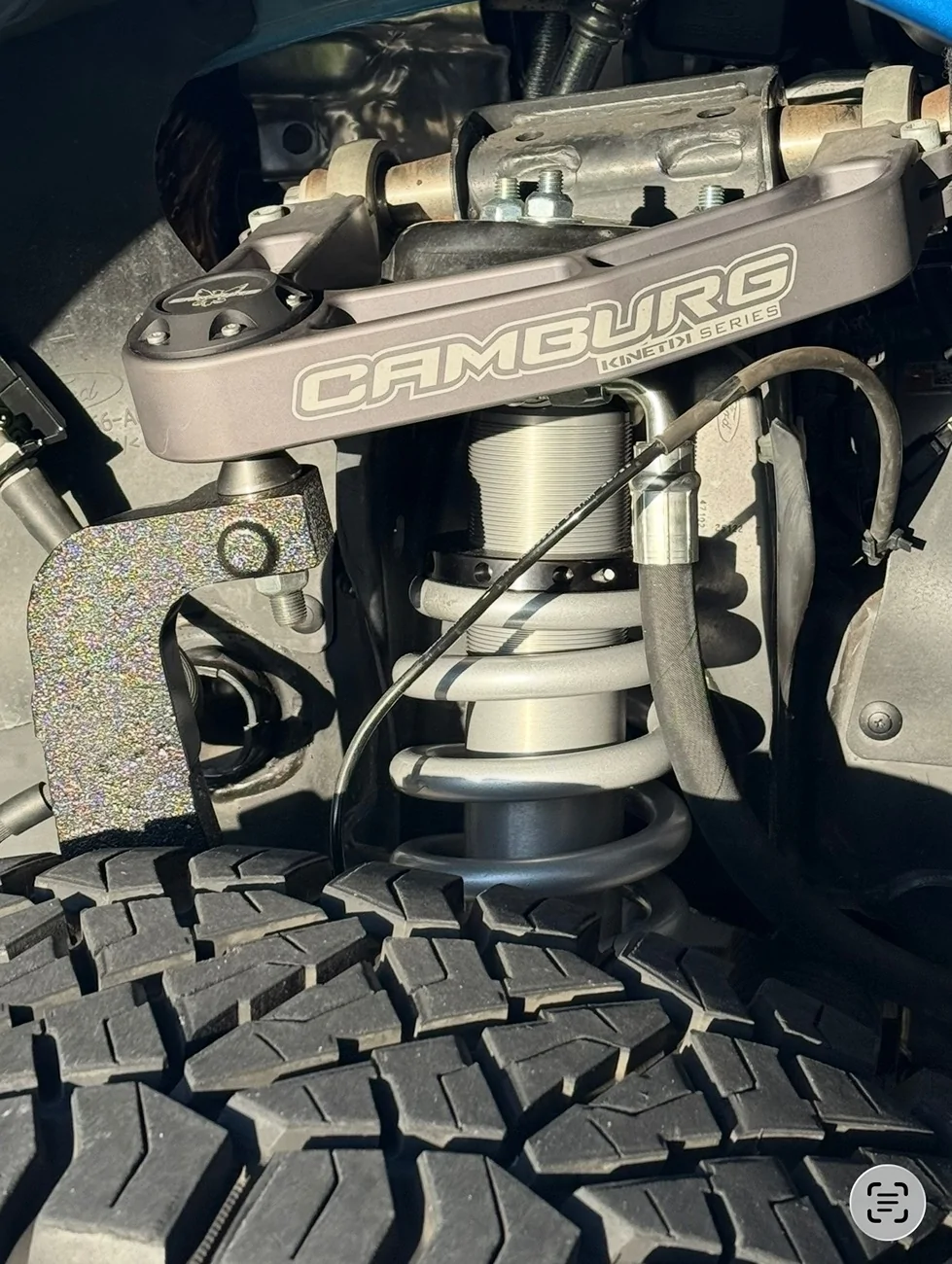

I have a 21' Tremor. I went with SPC uppers as they are adjustable. I also put Eibach Pro2'a all the way around. I put the 2"spacers I had on the Foxes on the Eibachs so I could raise it without using so much of the coil over. I could not be happier. I do't know what a shop charges. I do every thing myself.

The Pro2's are adjustable. So you can set them where you want them. I had 2 2" level pucks from Ranger Lifts. So I put them on there so I would extend the Pro's out that much. But before I put them on there I used just the Pro's themselves. It was still a great ride and handled well. Did not go off road like that so I can't comment on that.
