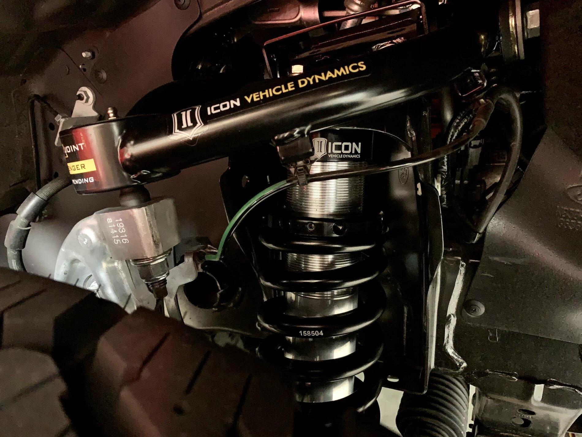

here are a few I can think of Icon (what I chose and love them) Camburg, Total Chaos & BDS. there might a couple more

The main reason I chose the Icon UCA's is because after installation we cycled the suspension and found that the ball joint didn't even come close to binding in the full bump or full droop positions. They changed the geometry slightly to compensate and give additional clearance. An added benefit is you can add an additional degree of caster. I couldn't be any happier with the performance both on and offroad. With the reviews I read on this awesome forum it really helped with my decision.

UCA's don't add any additional lift. They do slightly change the geometry to compensate for higher static ride height and make it easier to align the front end. I'd like to add that there are aluminum or cast iron spindles and the UCA's are specific to either spindle & limit your choices.
