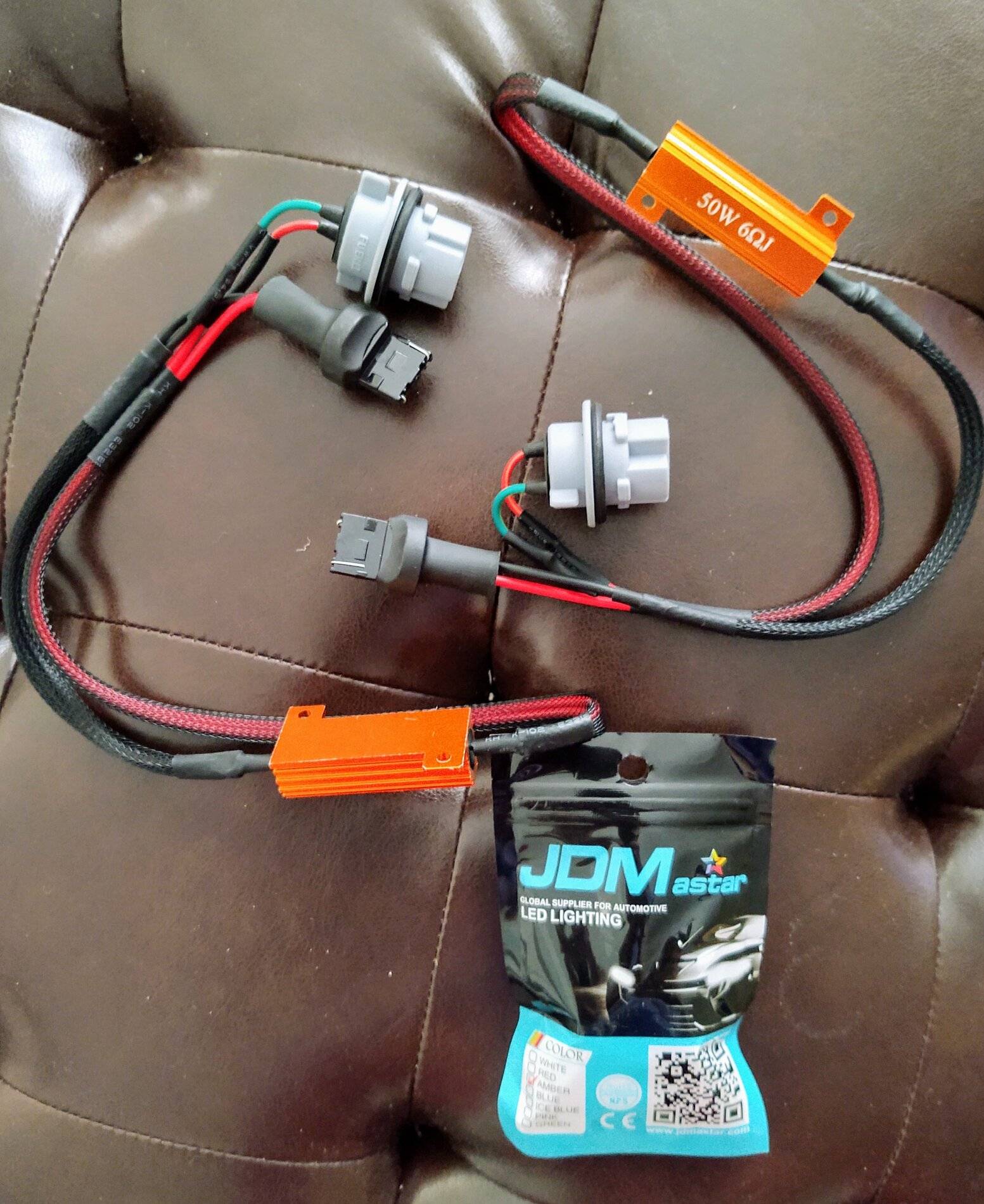

I don't expect much of a response from the Chinese vendor of OXILAM so rather than wait I bought some JDM amber lights since they are fairly well regarded but without resistors. For that I bought these (supposedly) plug n' play harnesses so I didn't need to cut:
https://www.amazon.com/dp/B07K2TK855?ref=ppx_pop_mob_ap_share
Unfortunately the part that holds the bulb that is supposed to go into the light housing doesn't actually fit the socket so back they go. I don't have my PC with me to use FORSCAN to turn off hyperblink so I just replaced the defective build for now. The JDMs are lower output lux-wise but I can't tell.
