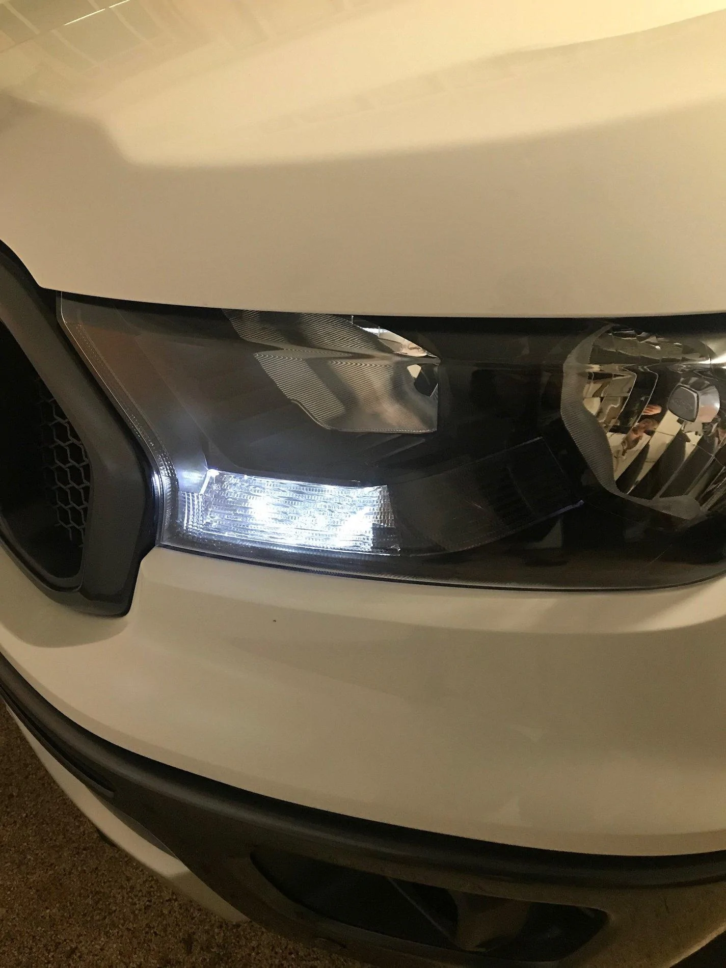

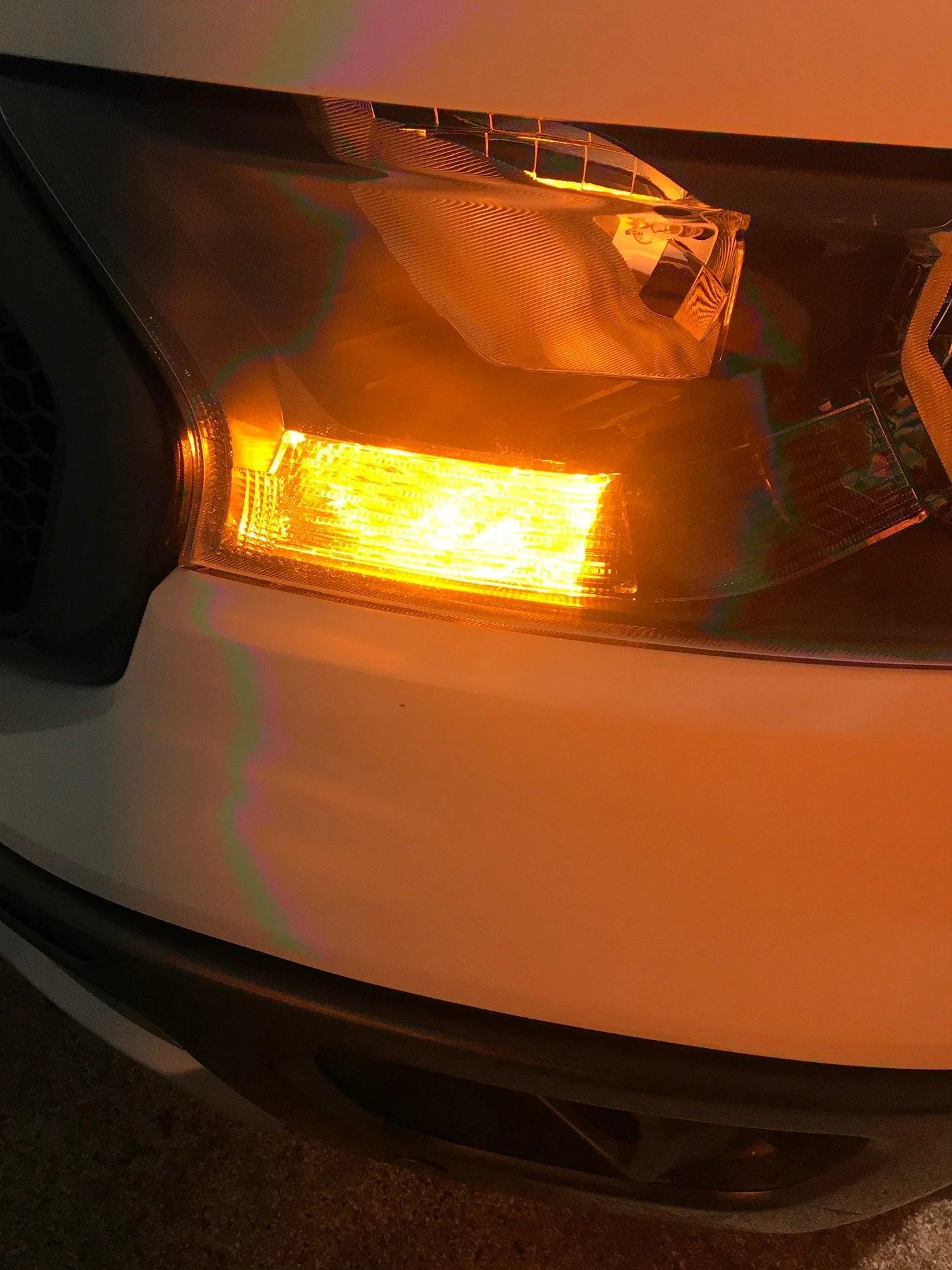

Has anyone else confirmed this?
I can't speak for the software option to fix but I installed the switchback from diode dynamics and used the resistors and get get any hyperblink. Very easy install and setup. I think I got both installed and setup in 30-45 minutes and it works/looks great.
Deleted member 1634
I didn't install the switchbacks, but did install the "amber always" LED turns, put the resistors on there and they don't hyperblink inside or out. The previous poster may have installed them incorrectly, because even without the resistors, the lights outside don't hyperblink, the dash just says they do.

Sorry to reply to an old thread, but I found some LED switchbacks that don't require a resistor.
I installed them and have had no hyper blink inside or out, just plug and play.
