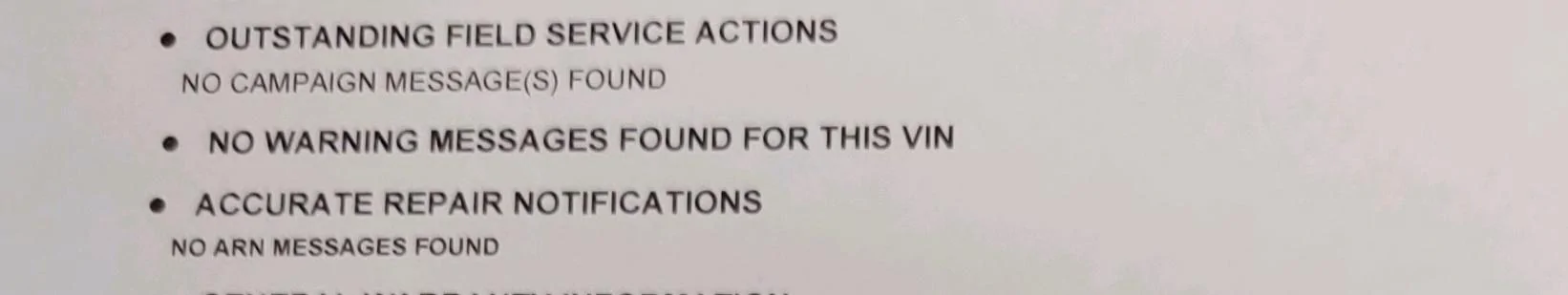

    What is an Oasis report?

    It's a report that Ford dealers can run detailing warranty work that has been done on a vehicle. I would HOPE this would tell if the update was needed, as my pickup was built before Feb 11. Any thoughts? Do all Rangers before Feb 11th need this?20190711_153853.jpg

    If it bugs you it's worth doing. Is your dealership saying they won't do it?

    No, I just dont think that he's understanding what I'm asking. I will attempt to clarify the info that I have learned from this forum. Great info on here!!
